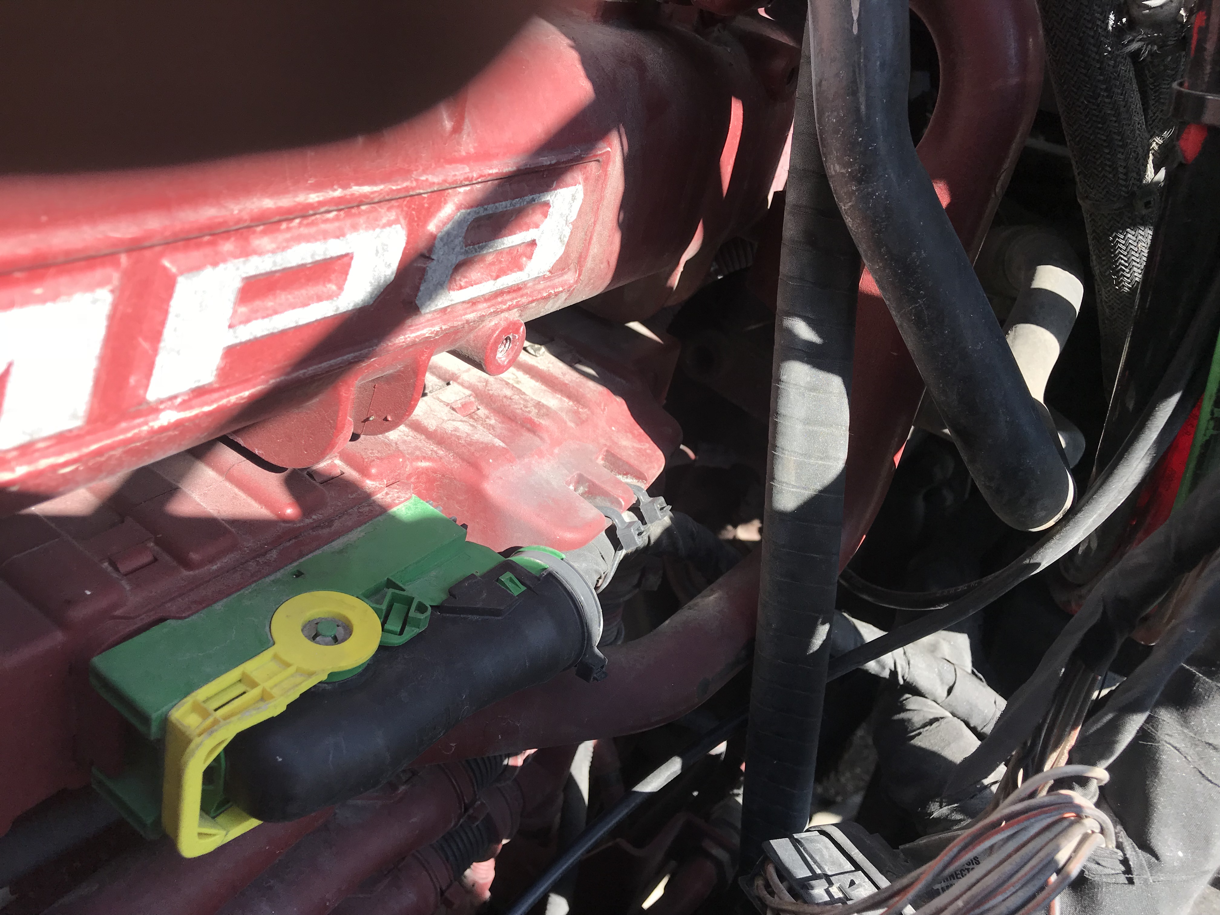

Am I looking in the right place?
I've been replacing a lot of the AHD (aftertreatment hydrocarbon doser) modules lately because of oil contamination in the air line to the module. The oil contamination causes the shut off valve inside the AHD module to fail. Remove the air line to the module, if there is oil in it you must flush the line, replace the air dryer filter and replace the AHD module air regulator valve (mounted behind the air dryer). Failing to do so will cause the AHD module to fail prematurely.

2 hours ago, terantrucking93 said:
I have the same issue can y’all tell me where it is locator the ahi module I have the same mp8 I can’t find it
Sent from my iPhone using Tapatalk
It's located below, and in between the ecu and the air compressor.
