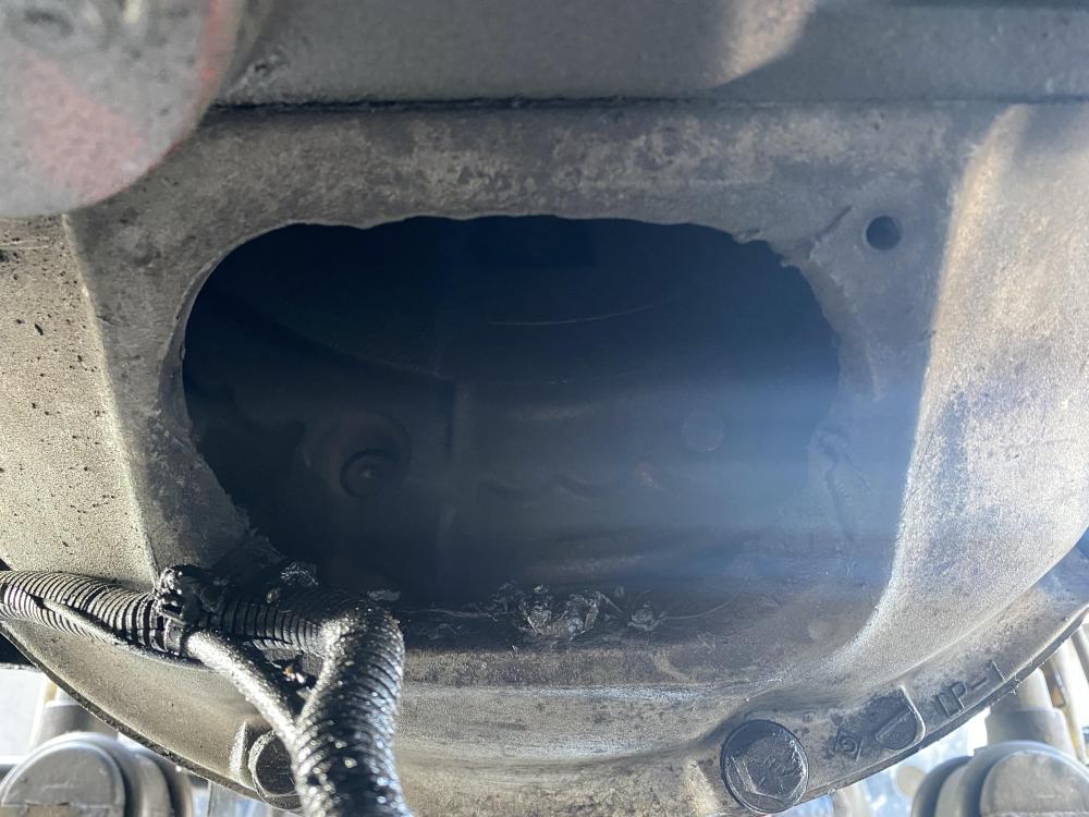

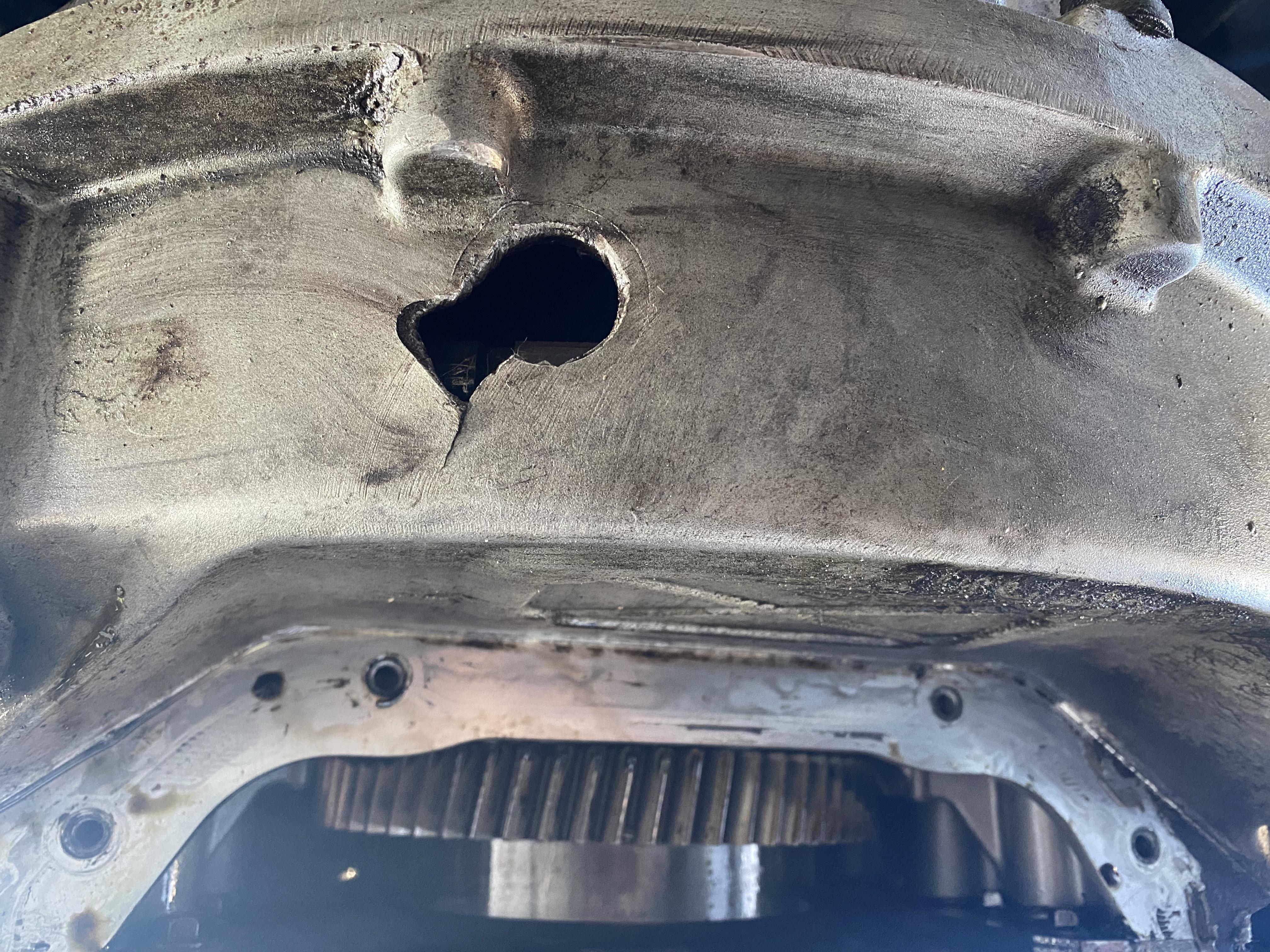

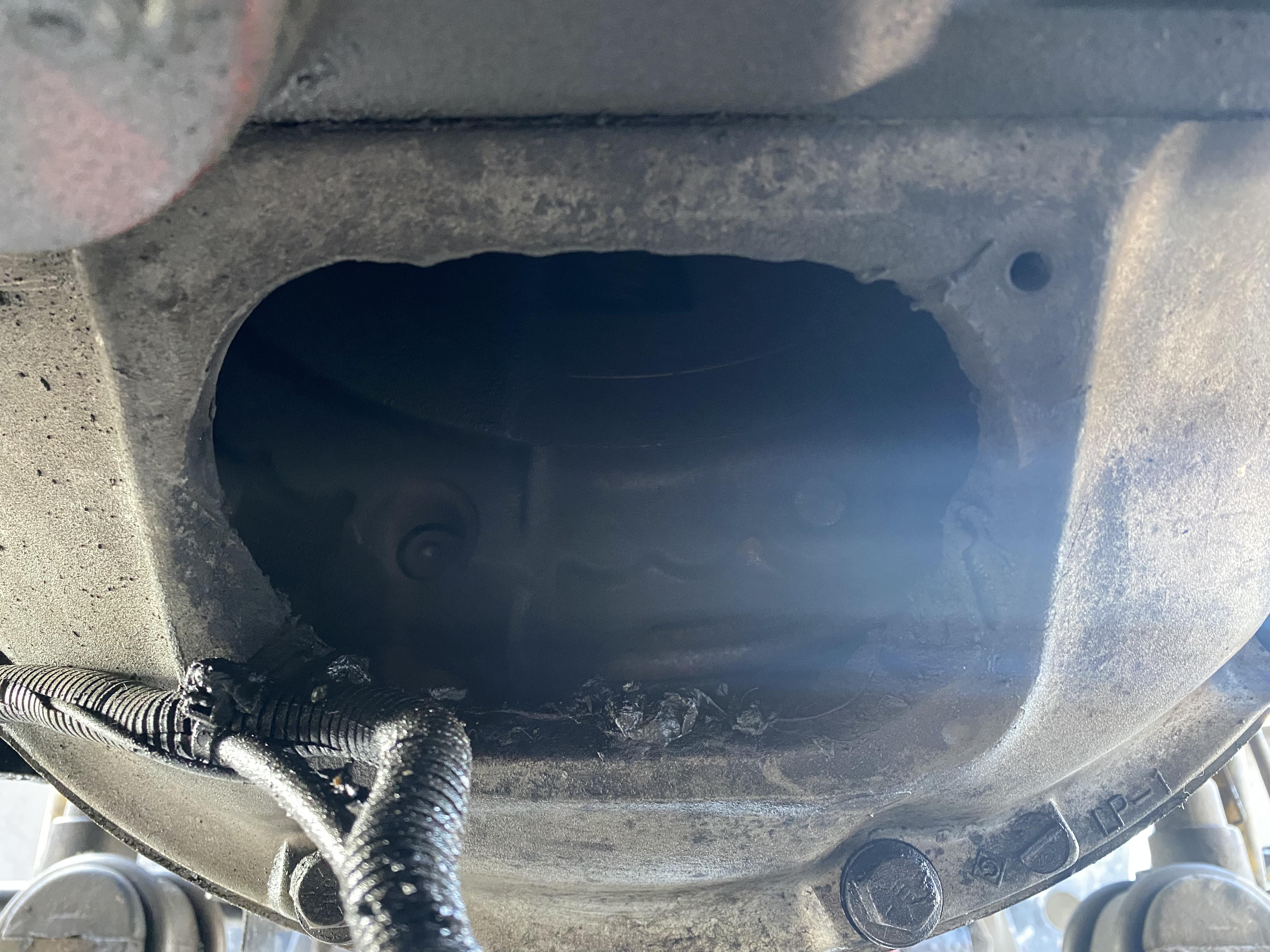

  9. Are you talking about the large inspection hole or the small bung hole, and is it a dimple mark on a tooth, or a hole in the flywheel I’m looking for? I should have marked this stuff before and this is a prime example of what happens when a person gets in too big of a rush!
  10. I think in the morning I'm going to try and run my snake camera up from the bottom and see if I can find those timing marks.
  11. Is the "O" where a person can see it, or is it in front of the transmission?
  12. Hey, on this engine is there a hole in the flywheel for a dowl alignment tool like on a CAT engine? It supposed to assure the engine is TDC. Or, is there some mark on the flywheel that is visible from the bottom?

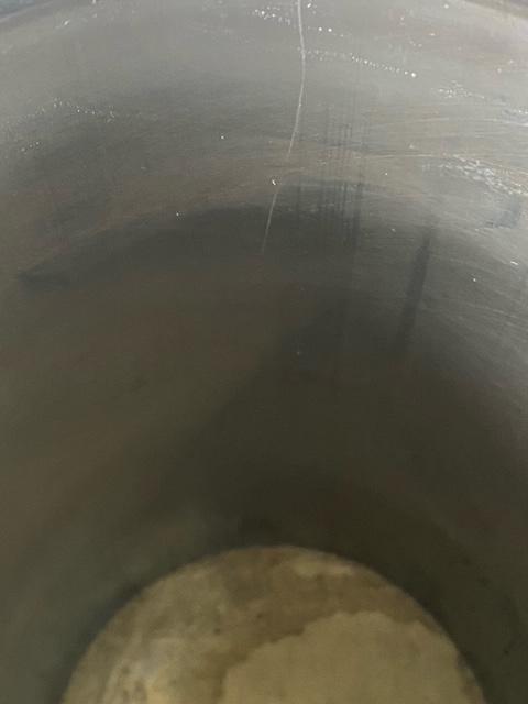

  14. #1, #3, #6 are all scored! I did do a leak down on the other cylinders (#3) and the only place I could hear air leaking from was the oil fill tube. I pulled the pan before pulling the head and used soapy water to spray up along the bottom of the piston and cylinder....bubbles, bubbles, and more bubbles. Anyway, the head is pulled and I will start pulling sleaves and pistons tomorrow. I'm also going to take the head and have it checked while it's off. I want to thank all of those that helped me here, @fjh, @Onyx610, @Joey Mack you don't know how much it has helped being able to bounce things around and get suggestions. Thank ya'll!
  15. Leak down done this morning and I can hear air coming from the oil fill tube....
