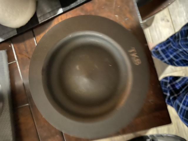

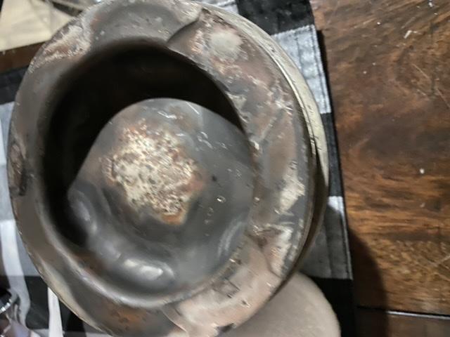

	Quick question about piston design. The truck dropped an exhaust valve and cracked a cylinder. I couldn’t afford a Mack cylinder kit, so I purchased an aftermarket one. Not mentioning the brand, but on the original piston there are two small reliefs molded in alignment with the exhaust valves. The new piston is flat with no reliefs. Every other dimension on the new piston is the same. My question is will it work, or will the exhaust valves strike the new piston?
