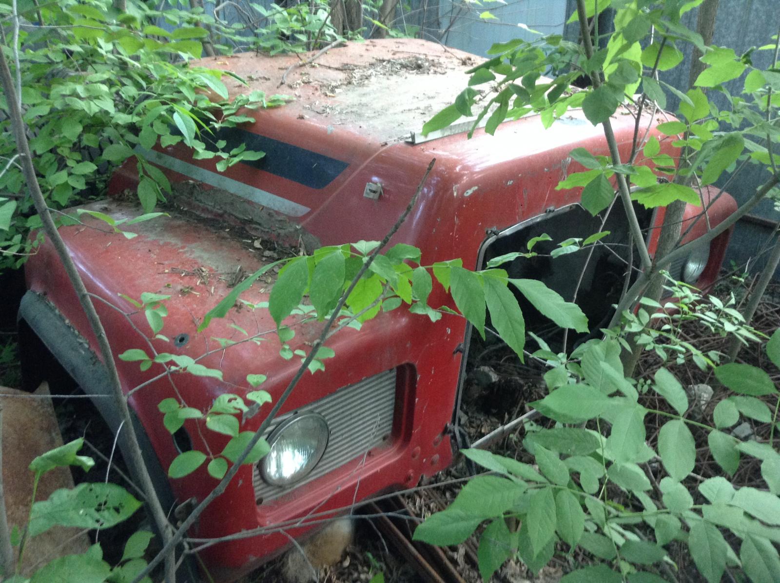

Found this locally.
Locally means 1000 km away though.
There are remains of some R-model and the owner said it was R686.
Front axle, rears, tranny and the hood.
I was going to check it out but got a doubt.
My interest is to use the hood for my R wich is R688ST with E6-350 and air-to-air front mounted.
Is a R686 part 1 inch shorter and how bad it could be put instead?
By the word, any thoughts on the paint scheme? Any familiarity?

Found this locally.
