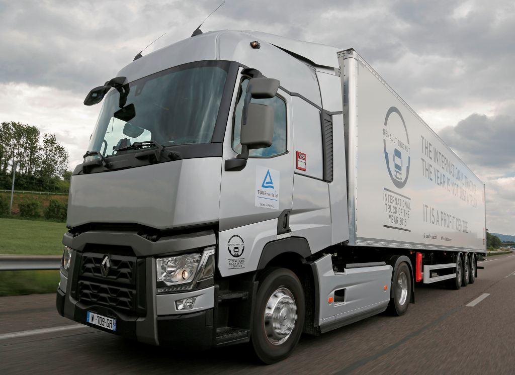

The independent certifying body, TÜV Rheinland, has just certified a 10.9% reduction of fuel consumption for a Renault Trucks T series "Optifuel" compared with a standard T series, after drivers had benefited from Optifuel Training instruction.
After several months demonstrating and selling the Optifuel spec T series, Renault Trucks, confident of its offering in terms of fuel consumption savings, asked the independent organisation TÜV Rheinland to measure and certify the fuel savings it delivers. The TÜV Rheinland therefore carried out a series of tests designed to measure the Renault Trucks T Optifuel’s performance with regard to reducing fuel consumption. This resulted in a measured and certified reduction in fuel consumption of 10.9% for the Optifuel version of the Renault T series.
“This figure, measured and certified by an independent body, demonstrates the benefits our customers enjoy when they choose a, Optifuel-equipped Renault T series truck,“ explains Bruno Blin, the President of Renault Trucks. He adds, “The T series' intrinsic qualities, combined with aerodynamic equipment and intelligent technology, significantly reduces costs associated with fuel which therefore contribute to their financial profitability.”
The T series Optifuel is a comprehensive offering consisting of a vehicle optimised to reduce fuel consumption, combined with Optifuel Training instruction in economic driving provided by Renault Trucks instructors. The vehicle used for the comparison was a standard T model, without any options and before the drivers had been given any economic driving instruction.
The TÜV Rheinland selected the two experienced drivers, making sure they represented typical long-distance truck drivers. Renault Trucks supplied the vehicles and the semitrailers, also providing the instruction in economic driving. The two vehicles were Renault Trucks T 4x2 tractors equipped with Euro-6 DTI 11-liter 430 horsepower engines having the same drive axle ratio (2.64). One was a “standard” vehicle, while the other featured the Optifuel configurations. The day before the test, the TÜV Rheinland carried out an in-depth check of the two rigs, in particular tyre wear and pressure as well as their weight and technical characteristics.
The Optifuel version of the Renault T series offers, as standard, all aerodynamic equipment (adjustable roof and side deflectors, door extensions and side fairings) to maximise the vehicle’s penetration through the air. It is also equipped with a set of intelligent technologies incorporated into the Fuel eco-pack (inhibited power mode, eco-cruise control with the Optiroll controlled freewheeling mode, a disengageable air compressor, a variable flow steering pump and automatic engine cutout). The vehicle is configured with a default maximum speed of 85 kph.
The TÜV Rheinland carried out its measurements on a 200 km route, typical of a long distance inter-regional haulage run. Both vehicles carried a 32 tonne load. On the first day, the two drivers drove over the route twice, once in each vehicle and with their semitrailer so as not to influence results. On the next day, they were both given Optifuel Training instruction in economic driving provided by a Renault Trucks expert. On the third day, the two drivers once again drove the vehicles over the same route, this time applying what they had learned during their training.
This very strict test procedure, implemented by the TÜV Rheinland, made it possible to isolate the two vehicles’ intrinsic performance and exclude any impact on consumption from outside factors such as ambient temperature, differences in the two semitrailers’ rolling resistance or the prevailing road traffic.
Following the test, the TÜV Rheinland experts observed and certified that, after the instruction, the Renault T series Optifuel consumed 10.9% less fuel than the standard spec Renault T series.
