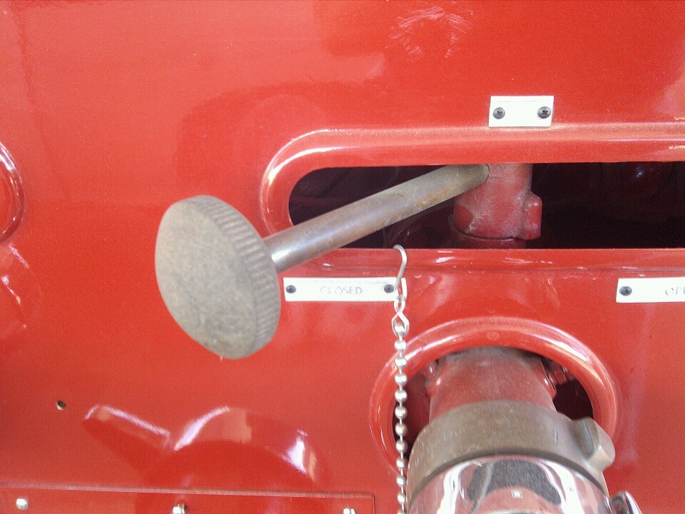

I'm in the need of a discharge knob/handle lever for a Hale 750 pump that's on my 1958 Mack C85...also need the adjuster handle assembly that would fit onto what was know as an intake 'dump valve' that was commonly used on FDNY rigs from the late 50's thru the late 70's. That valve is located on the lower rt side of the pump panel, many were mounted under the right side of the pump panel running step. All I have is the 2 1/2 fine threaded pipe that the handle assembly screwed onto.

That knob/handle is savable. Remove it, buff it out on a wheel buffer, re-paint the lettering with white paint. I did all of mine that way.
That's the plan....trying to get one that is missing however...

YUP. That's the one. I have a source of new old stock knobs. Might even have or be able to get the knob for the Ross relief valve too. I will post the name and contact number later today, don't have it in front of me right now.
Thanks! At this point just need 1 complete lever and knob.......I contacted the Ross company and perhaps can get some parts to reassemble the dump valve so it at least 'looks' complete....Let me know who I need to contact !
