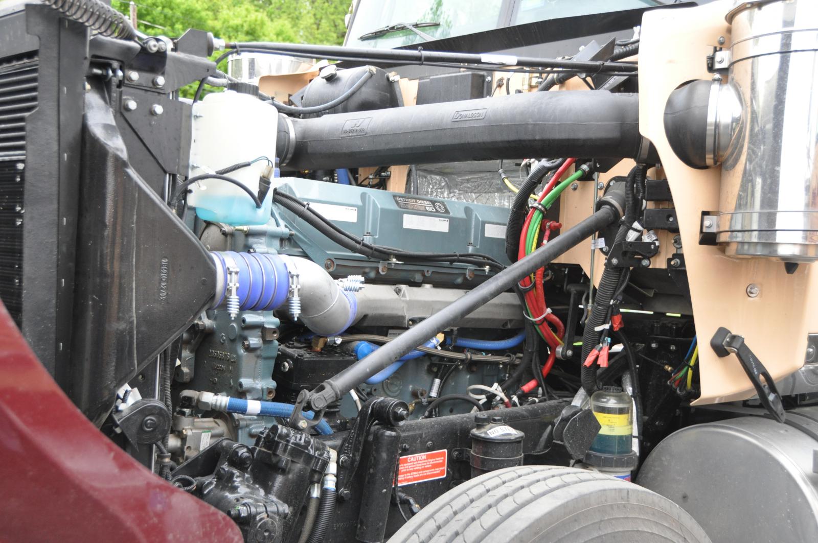

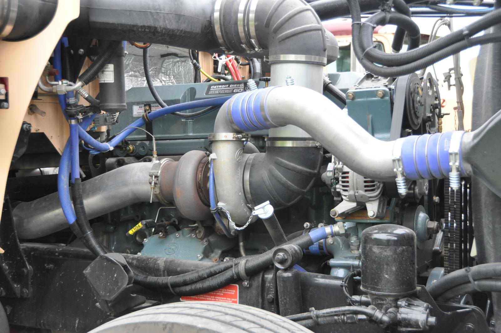

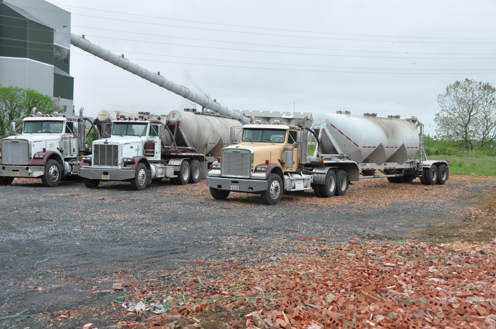

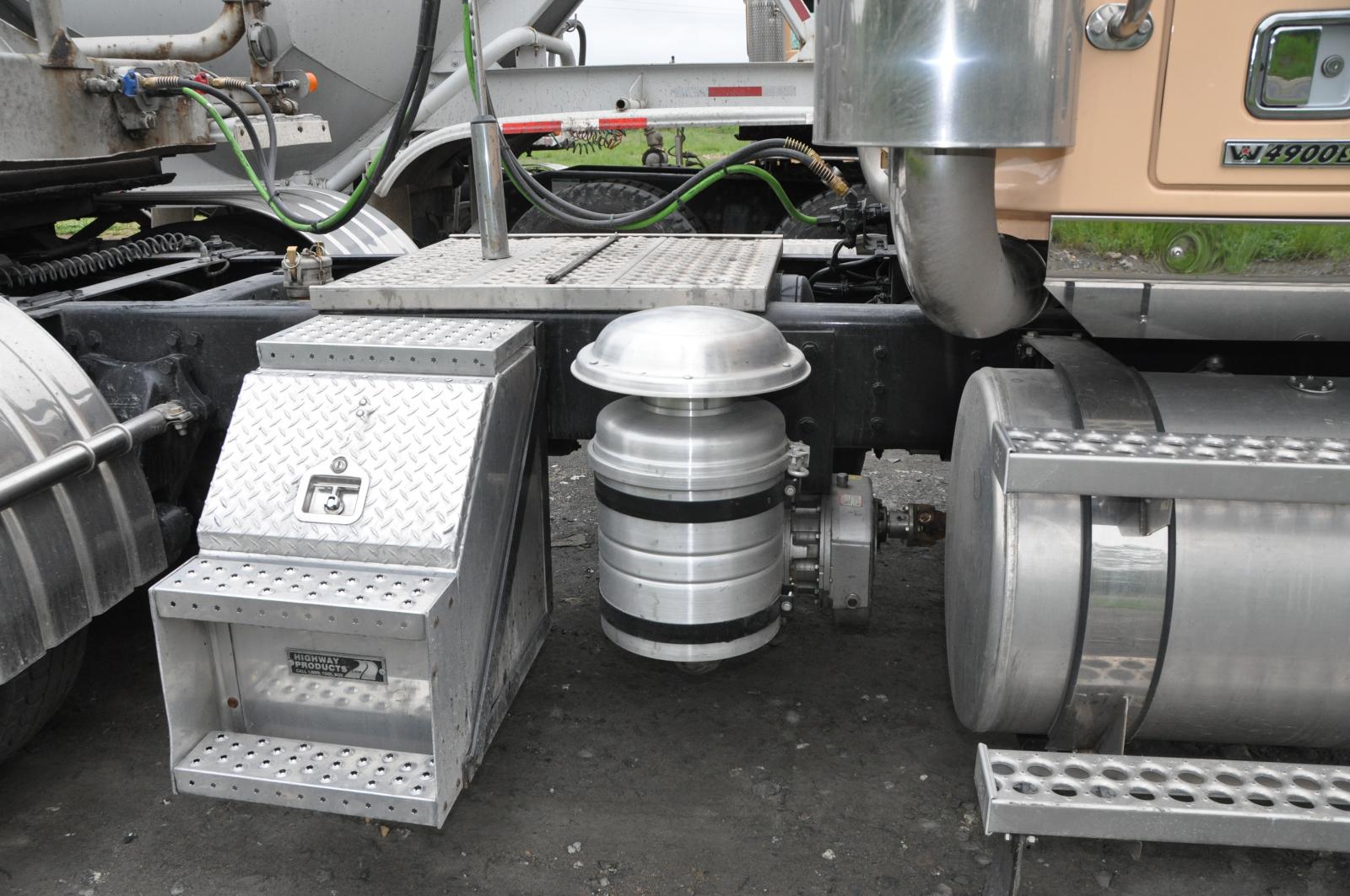

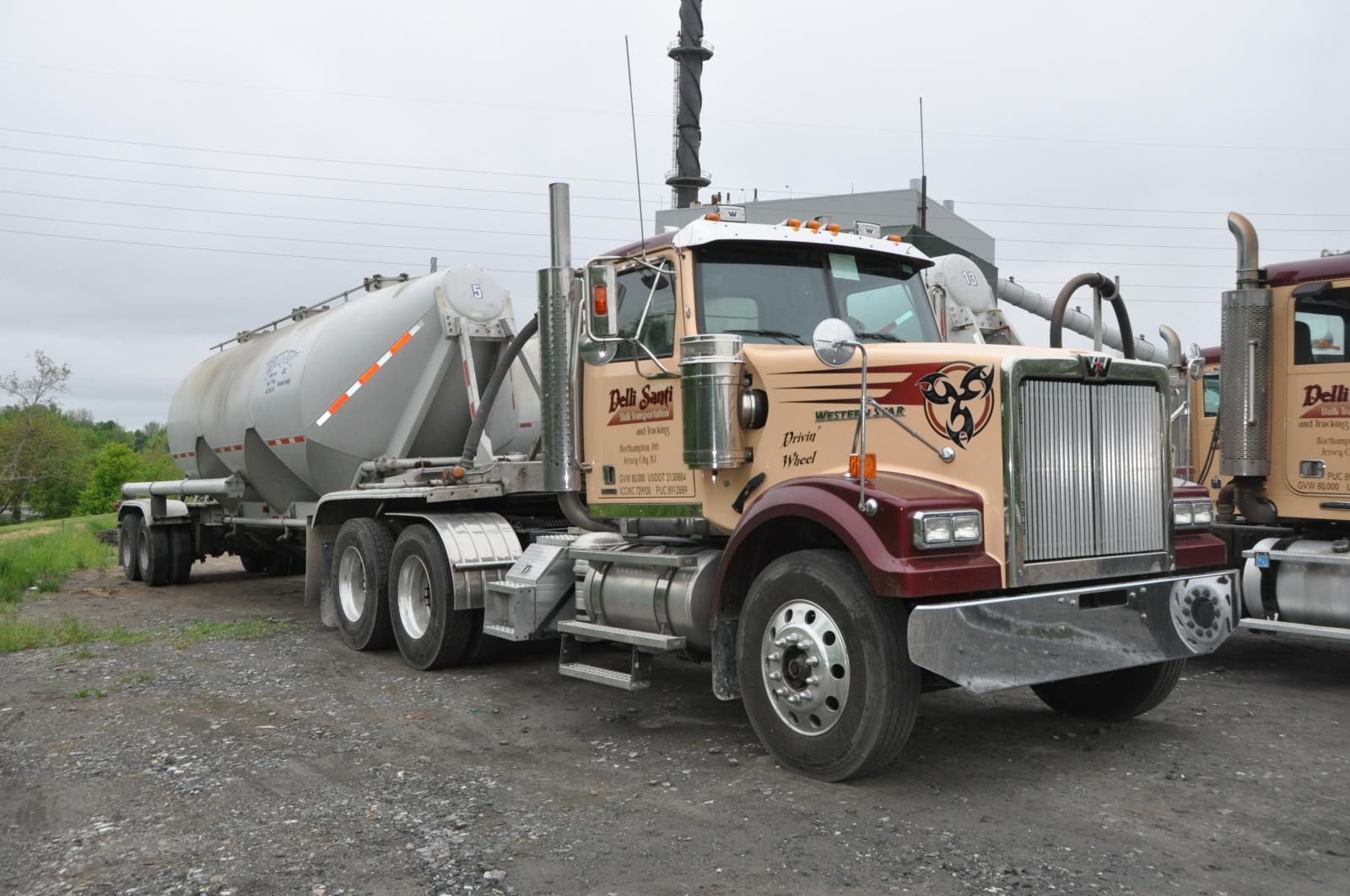

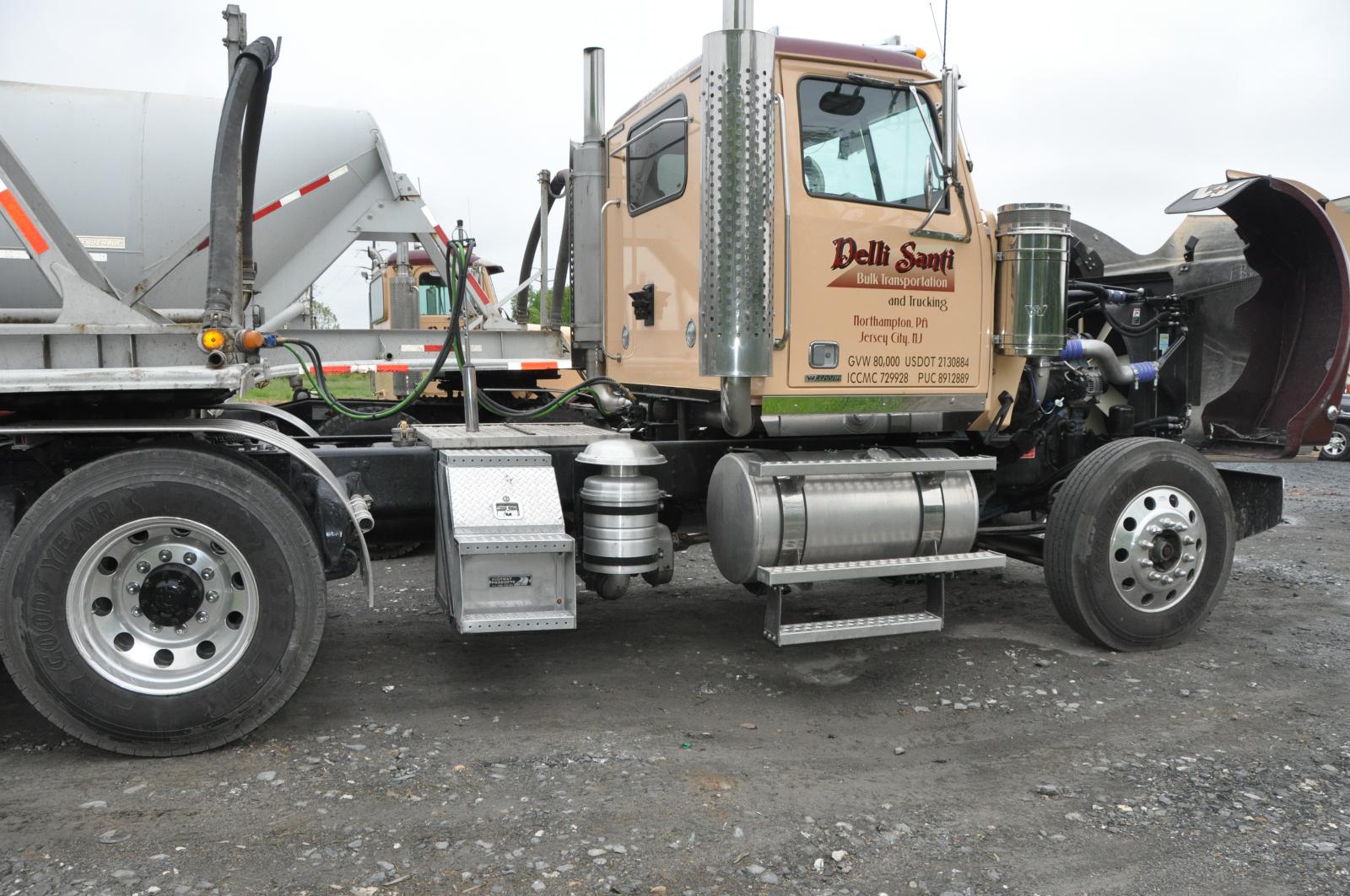

Finally got the rollin Wastern Star glider done!! I took it over to Horwith Trucks last week to have them do some wiring that was not in the cab as should have been for the motor!! All in all though, not many snafu's. The 575 hp Detroit sounds and run's strong M/T I will have pic's on Monday for us and I have a nice load of brick to bring back to PA so I'll see how she run's with 79,000 gross
Ernie DS
Good luck with the new rig. Post some pics for us to see the finished WS.
It's been workin! The M/T wt. on the tractor alu. trailer is about 27000 in change! Not bad for 575 hp, a GD blower and a 13 speed trans. and a 4900 W- Star. So i'm gettin 26 plus tons on for payload! It just goes to show you how much weight there is in those EGR polution motors. I will get you some pictures ASAP, the truck gov. speed is 75 mph @ about 1600 rpm's (4.10 rears 11R 24.5 rubber) 13 OO I think It's .74 the driver said the truck goes over jugtown mt. very very good (I'm not gonna tell ya how fast he said untill I drive It myself)
