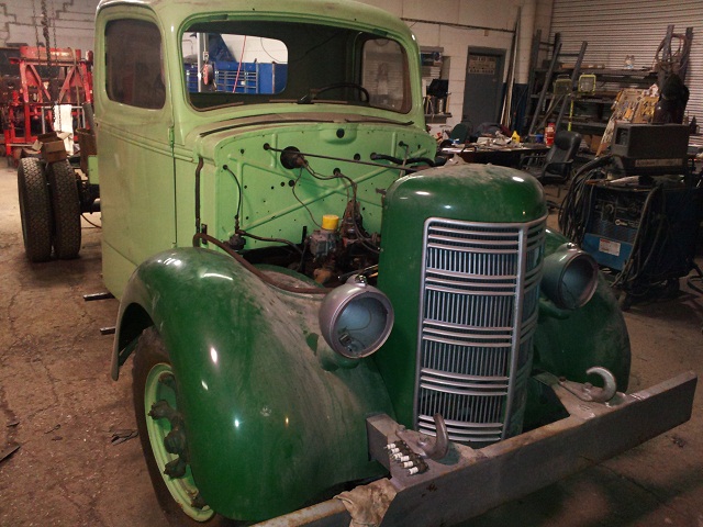

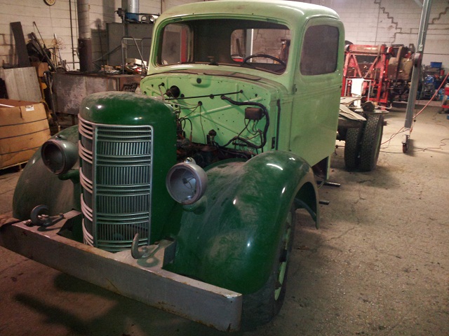

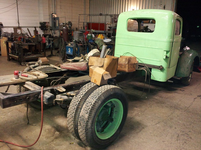

Got this truck in at the shop the a few weeks ago and are having an "discussion" about the year and model.
The only number we can find so far is the engine number that starts with EN. I will look for more numbers once we get the fenders off of it.
The windshield tilts out, but is the same size as a A20, the top of the cowl is shaped to a point in the middle versus straight like an A20. The fenders are narrow at the rear, self supporting, but have holes for running boards.
Thankspost-2000-0-07174800-1322759224_thumb.jppost-2000-0-95833300-1322759241_thumb.jppost-2000-0-20852100-1322759211_thumb.jp
1939 to 1942 Mack DE 1 1/2 ton. Powered by a Continental EN11 210 cubic inch 6 cylinder. It's missing a lot of trim on the nose and has the military pattern bumper assembly. Paul

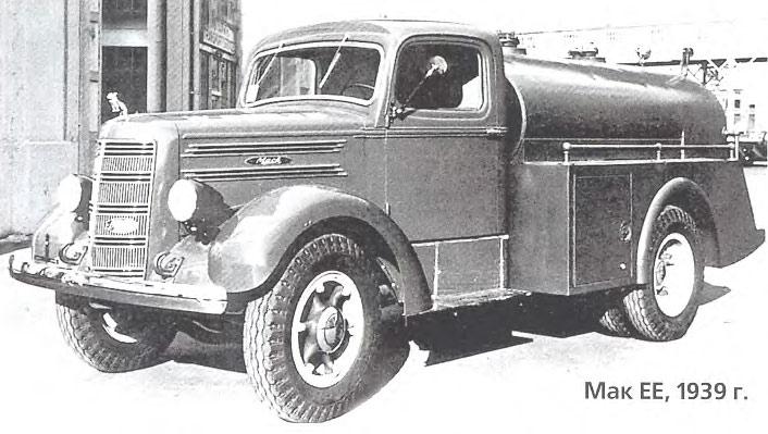

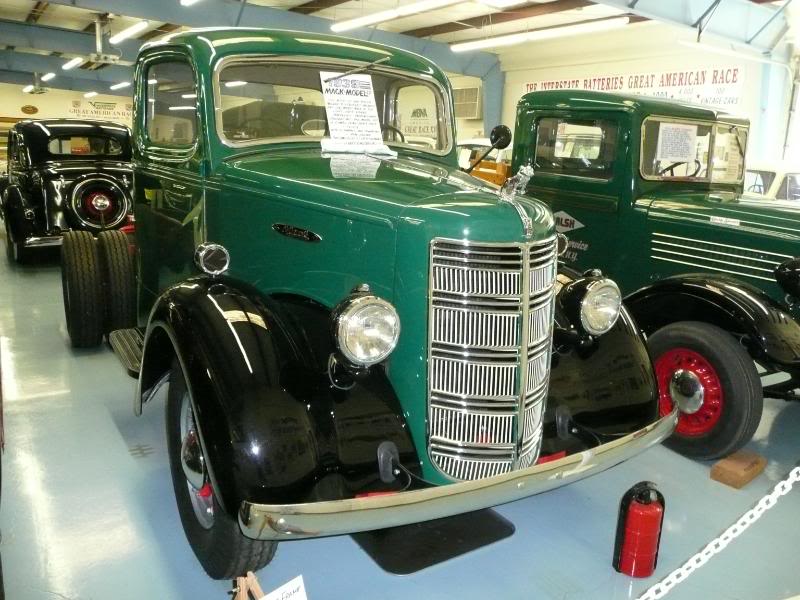

I think Paul nailed it. They look nearly alike, but the DE is really rare, I think Roy Moxley has one, but I can't come up with a picture. Here are two pictures I could find, but I think one is an E, and the red one is a DE.
Dave
The red one has single rear wheels, it's a 3/4 ton ED. 1938 to 1944 , 2686 made. There is one for sale on Craigs list in eastern Conneticutt now for $7000..........confusing letter call outs ain't it? ED is less capacity than a DE which is less capacity than an E................... :twothumbsup: :twothumbsup:
