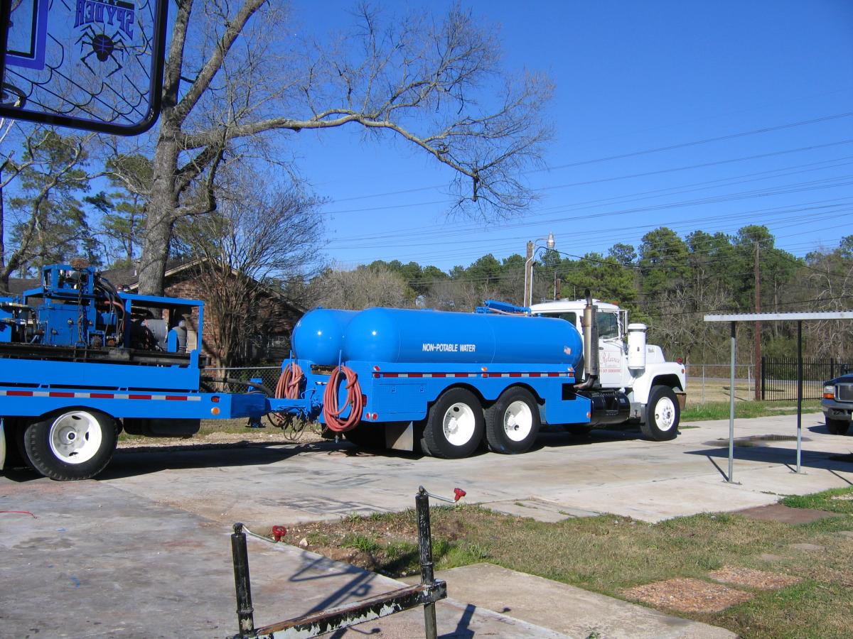

post-9425-0-72582000-1316301699_thumb.jp
The picture of the truck is like the pictures the Lady's on on line dating site that they post ..... not to recent. The trunnion on the rear end broke and I had it welded back to get back on the job so it stays on the job along with a lot of other problems I really need to replace the truck .The CH613 may not work as well as a R model. I like the way the CH 613 looks over the R model but its not the work horse the R is
I'd prolly go with a heavy spec'd truck with winches doing to "tugging". A lot of power can be had with eight wheels locked on solid ground and a hundred thousand, (or so) pounds of force exerted by a couple large winches. Easier on drivelines too.
