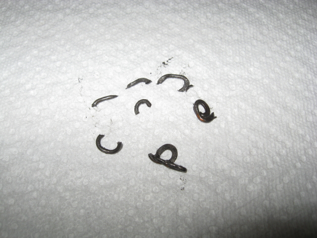

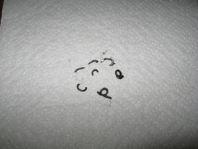

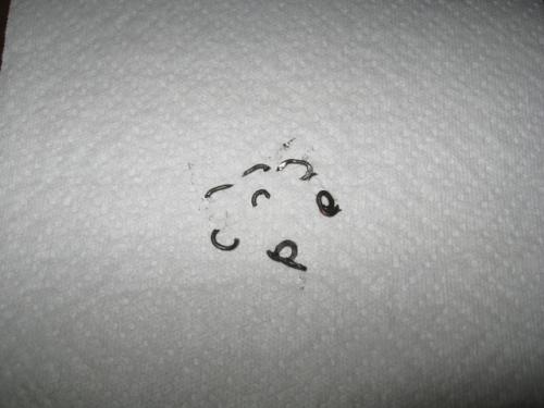

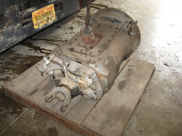

Well Glenn; Following your advice I pulled the bottom PTO cover from the trans. What I saw immediately told me this suckers a coming out. The sliding clutches that can be seen only contain about 25% of their original wear faces. Some of the other gears are actually worn concave on the faces. None of the observed gears still contain their "hobb" marks except on the non load beariing surfaces at the edges, and I about cut my finger when I dragged it across the most forward magnet in the bottom of the case. Here are a couple of photos of some small pieces I dragged out: post-78-0-54194600-1307886333_thumb.jpgpost-78-0-70902600-1307886389_thumb.jpg
The entire bottom of the case is a light gray metallic color that could not be swiped with my method prior. The layer is about 1/16" thick it feels like.
I rounded up my box of transmission parts and new biscuit kit and will get this one pulled either later today or tomorrow.
Glad I didn't attempt to make the South Bend trip after seeing this mess!!
Thanks again for the help and guidance.
Rob

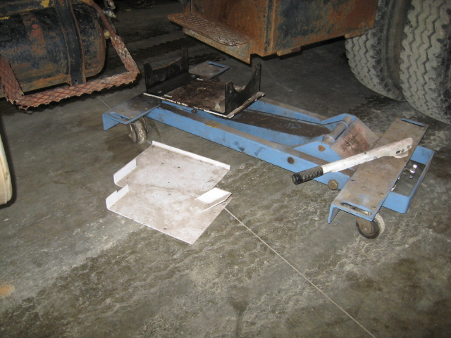

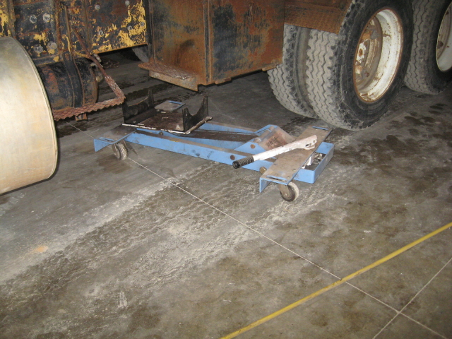

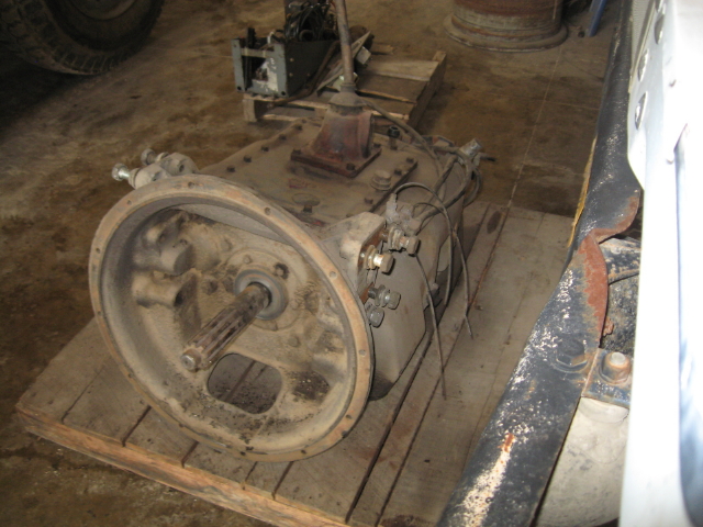

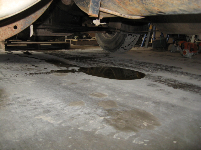

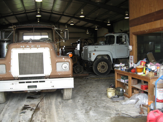

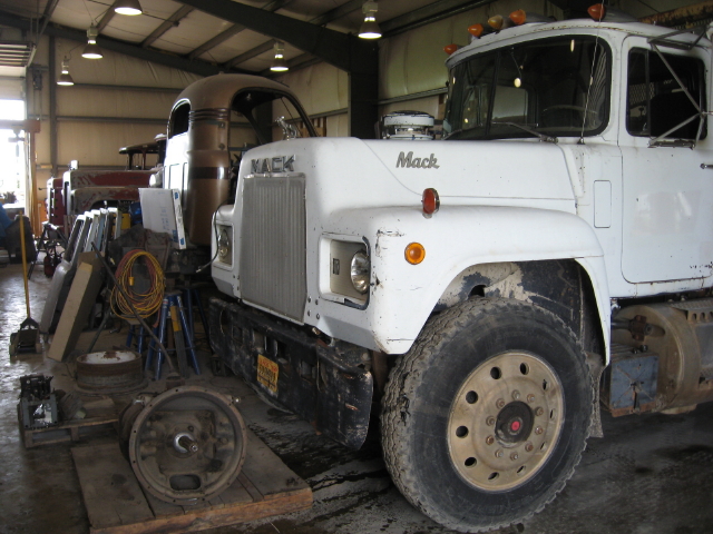

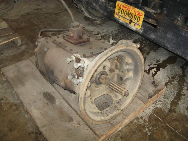

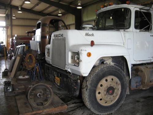

Dragged my spare RTO-12513 out of the garage and moved trucks around so this one will have a stall. Got a nice oil slick starting just from moving the truck 10 feet....... Looks like I'll get to use my tranny jack tonight. Hope I don't need to remove a fuel tank that is about 3/4 full in the anticipation of the trip to South Bend that was canx'd. I had the top cover off this transmission and it looks nice inside. Came from a 1982 "Cruiseliner" and was behind a E6-350 which I have also. I never drove the truck but rather purchased the engine and the gent gave me the trans. It has a rebuilder's tag on the side and I have a complete top cover rebuild set including poppet balls, springs, forks etc. I will switch over the mounts, speedo drive gear, slave cylinder, and a couple of other things I know are good on the old trans. Will also replace the air line set upon the swap and need to pick up a throwout fork kit as this one is no good at all. The bushings are all but gone, but the housing seems alright.

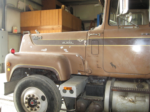

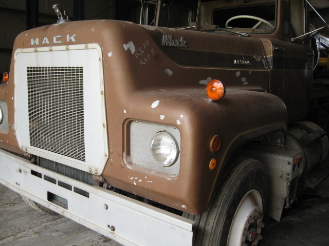

post-78-0-48184400-1307900107_thumb.jpgpost-78-0-88250900-1307900120_thumb.jpgpost-78-0-21733600-1307900132_thumb.jpgpost-78-0-18451300-1307900144_thumb.jpgpost-78-0-05181200-1307900158_thumb.jpgpost-78-0-09355500-1307900170_thumb.jpgpost-78-0-64097200-1307900181_thumb.jpg
And just cause Other Dog likes to look at pictures of things, a couple of my RL797LST in the shop.post-78-0-54948600-1307900218_thumb.jpgpost-78-0-70964800-1307900229_thumb.jpg
Got to mow grass, then get back in the shop.
Rob
