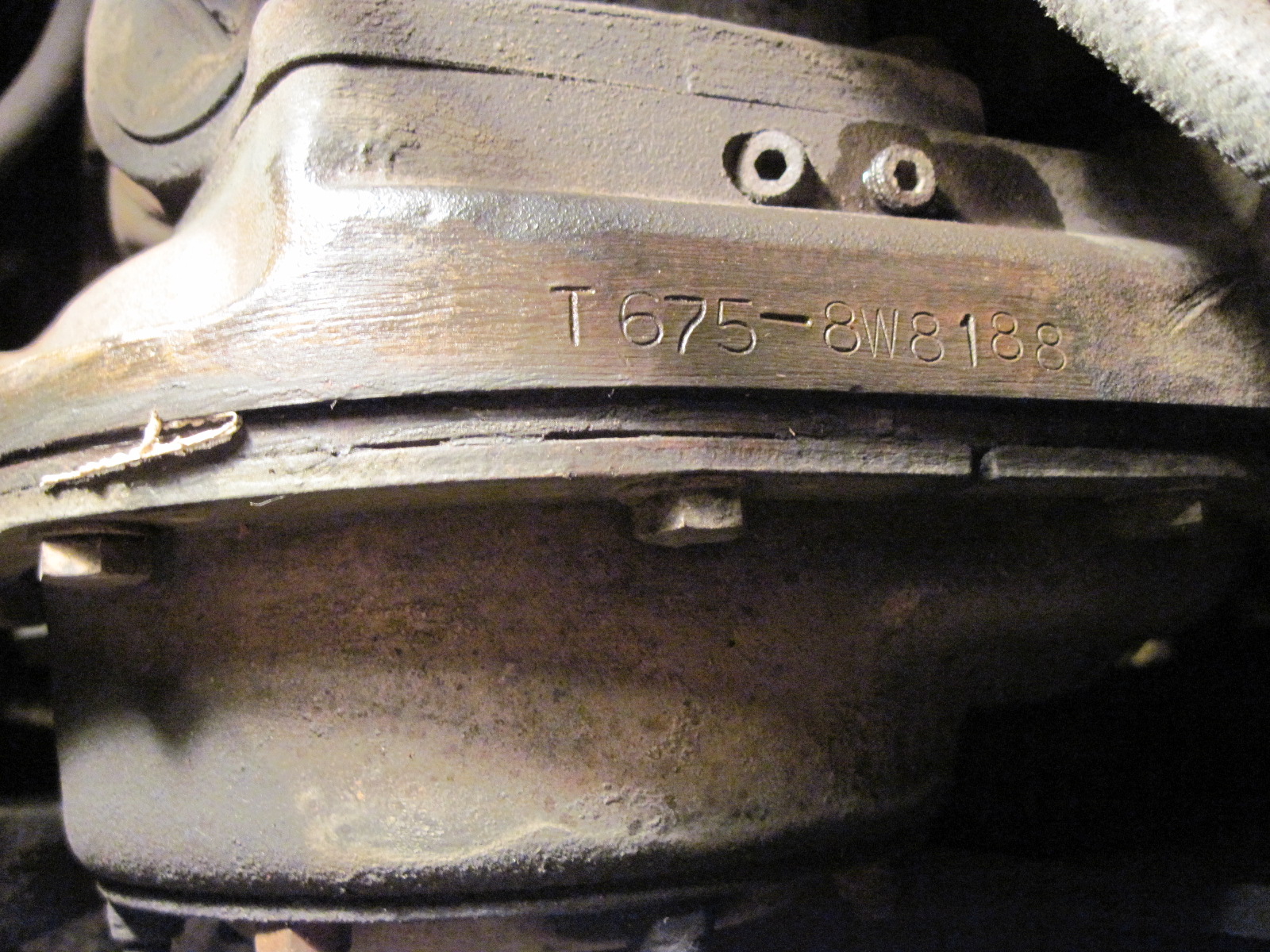

Well guys the truck just got dropped of at my house about 45 min ago. Ive been going through it and found the door tag. It is a B61T. Now the engine number... I have no idea where to look for it. There has to be an inch think of dirt and on the front axle and bottom of the engine... Where shall i begin looking for it?

Here is where the engine number should be...Left (passenger) side at front of accessory drive case.
post-6773-0-10676700-1302385673_thumb.jp
I have no idea where that is. I just went out before trying to locate the number but couldnt find it. Do you happen to have a Larger picture of where the accessory drive case is?

Les' picture is showing the correct location of the serial number stamping, it should be on the passenger side of the truck, front of the engine, just in front of the where fuel pump bolts up, stamped into the bulge on the cylinder block.
And if the engine is originally from a cabover truck it will be stamped into the rear of the block where the flywheel housing bolts onto.
