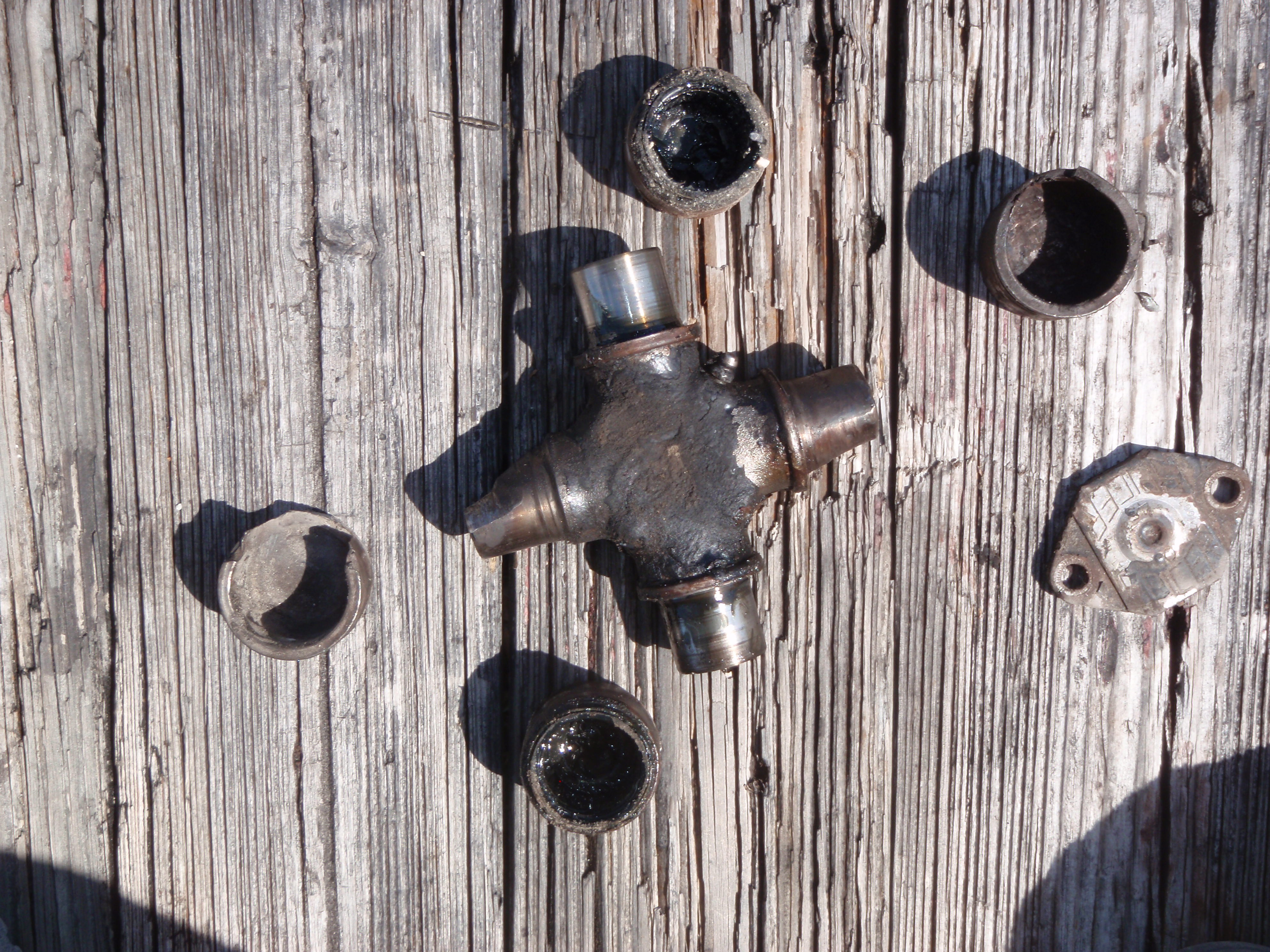

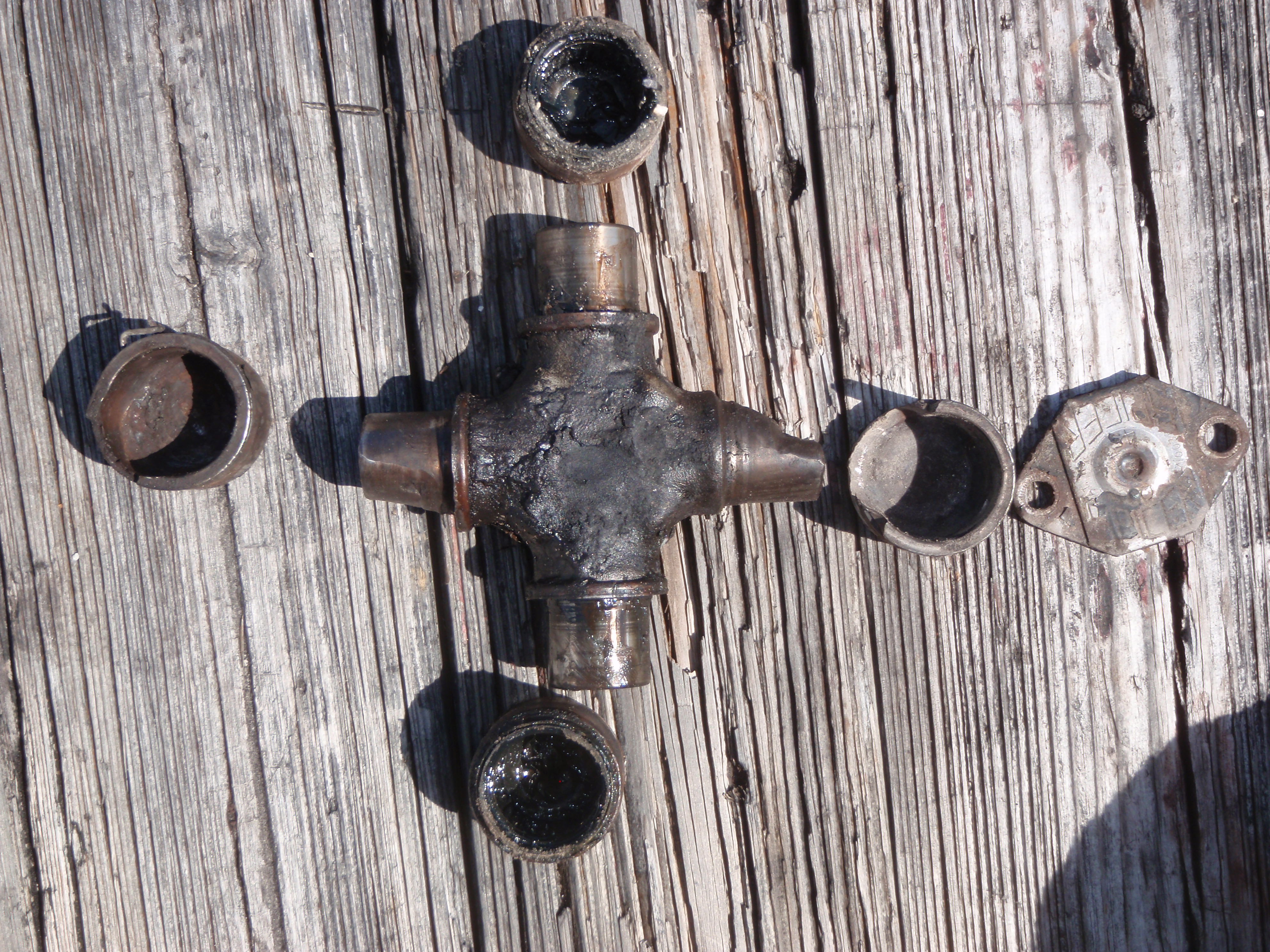

Can't understand what caused all the vibration.
post-4436-0-70115100-1297974251_thumb.jp
As you can see, grease was getting in. But just some of it.
hadn't taken grease in a long time.
Years ago, I had replaced a U joint with a no name bargain joint. It failed after a couple of month's, threw a shaft, wiped out a front diff yoke, and left me stranded on the side of the road in the middle of the night. When I got the thing apart, I discovered that one side of the cross had never been drilled, no way it could take grease. Since then I have never used anything but a Spicer joint.
I've seen that very same thing in years past but on an automobile replacement joint. I've always pulled the caps to verify there is both a hole through the cross, and a hole with good threads for a zerk so the joint can take grease.
