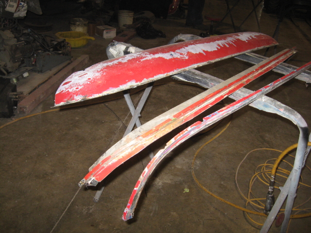

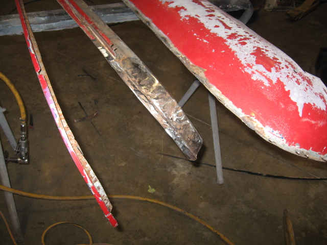

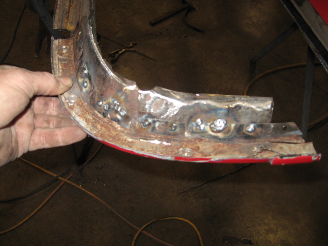

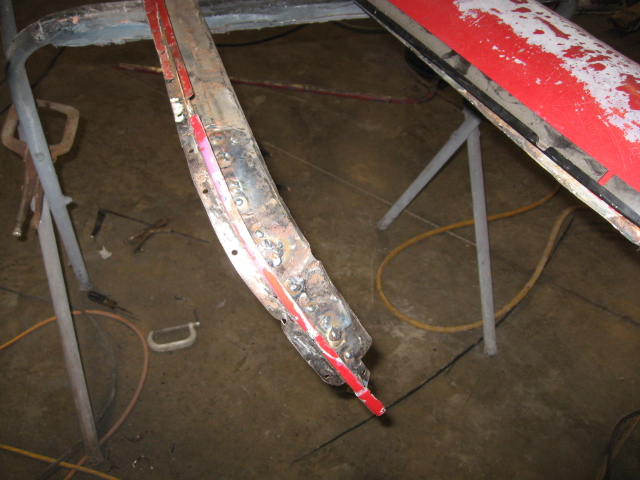

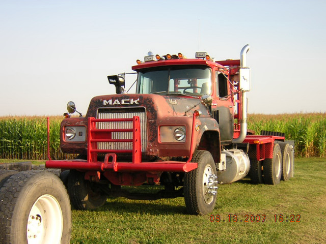

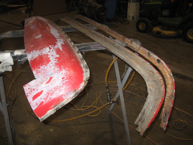

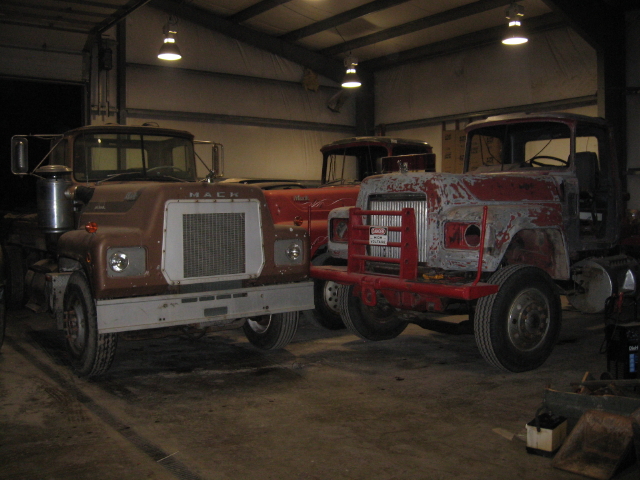

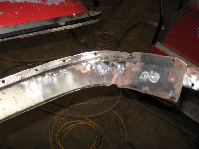

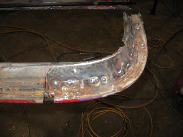

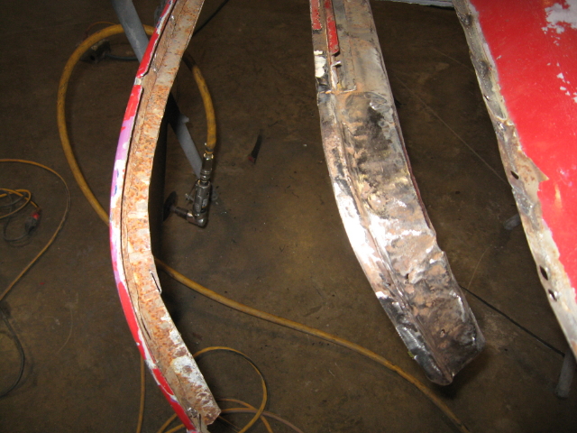

Today I've been working on getting a roof back onto the RL797, (brown truck). Inbetween installing door skins onto an 08 Dodge Avenger, and a rear bumper cover and brackets on a Toyota Matrix, I welded up some rain gutter donated by a couple of rusty cabs from Chicagoland that had enough decent material left to make one from two. The attached photos show what I've accomplished.
The large portion of a roof panel is cut from an 89 R690 cab, The rain gutter was cut off from this cab as well. This roof panel will be cut down and sectioned into the rear of the roof of the 77 R795 that is Project R-12. The long portion of the rain gutter in the photo is cut from the rusted cab of the RL755LST. This portion and a section of the rain gutter from the R690 is shown spot welded together in the photo. I will make another small section to fill the remaining gap between the two pieces. I have all these pieces NOS but prefer to use them on something that I cannot repair by other means. I'll get these pieces final fitted, then sandblast them clean.
My plans are to get a roof skin back on the R797, (brown truck) later this week so it can go outside for the winter under cover. I want to slim down to working on a single truck at a time and get something finished. Having the R612 road ready next week will be a great relief and allow me to focus more keenly. Would really lke to get the V12 installed into R-12 to gain floor space the engine and this trucks parts take up.
