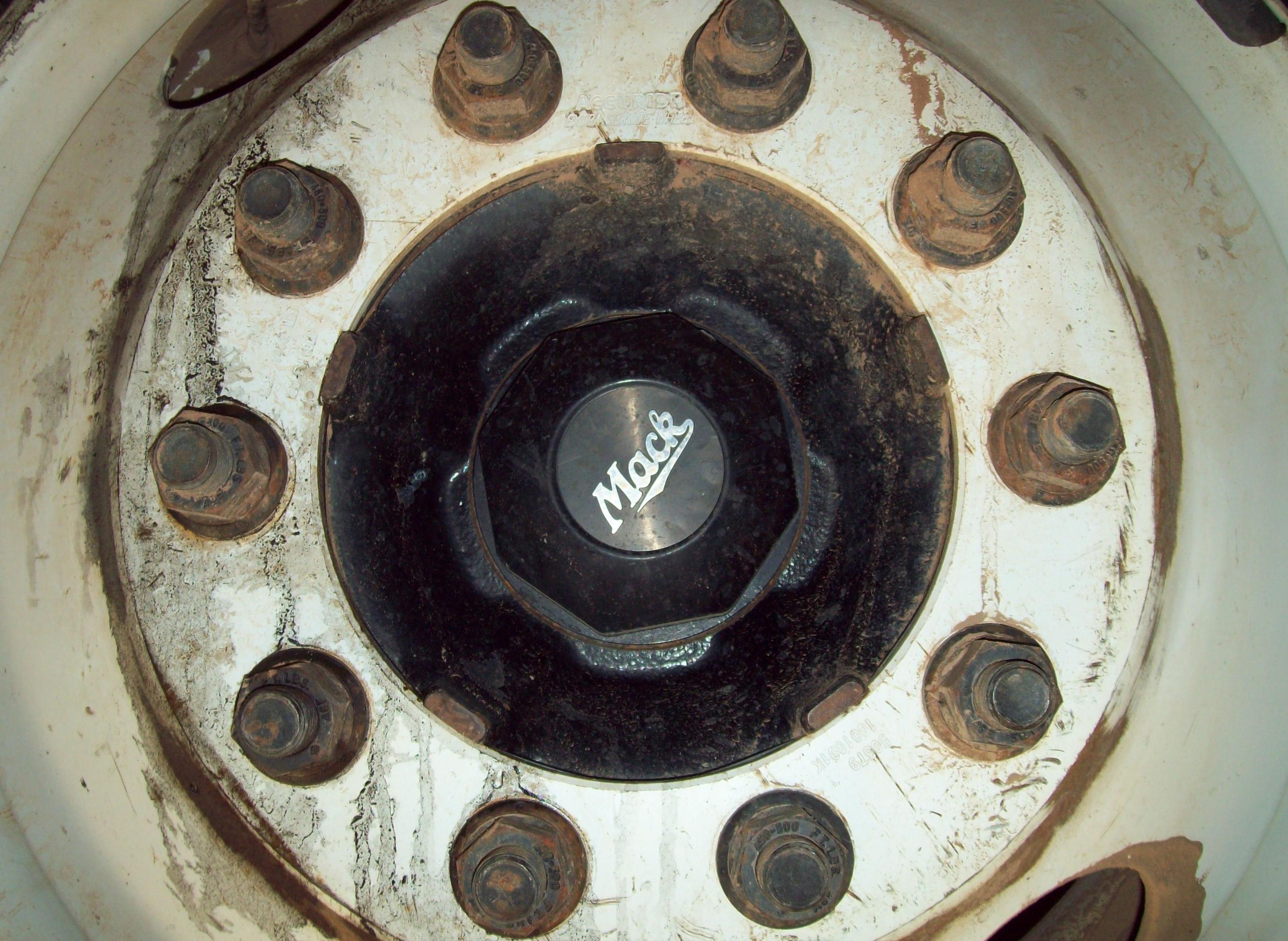

So, hub piloted wheels are the current "standard"?
Here's a picture of what I'm talking about.
I think what you are refering to may be spoke wheels. I've always heard them called Dayton wheels, but I guess technically they are hub piloted. I don't know if they are still available on new trucks. If they are I would suspect that Mack only offers them on the drive axles, as Meritor manufactures the Mack FXL series front axles which has unitized hubs/wheel ends.
