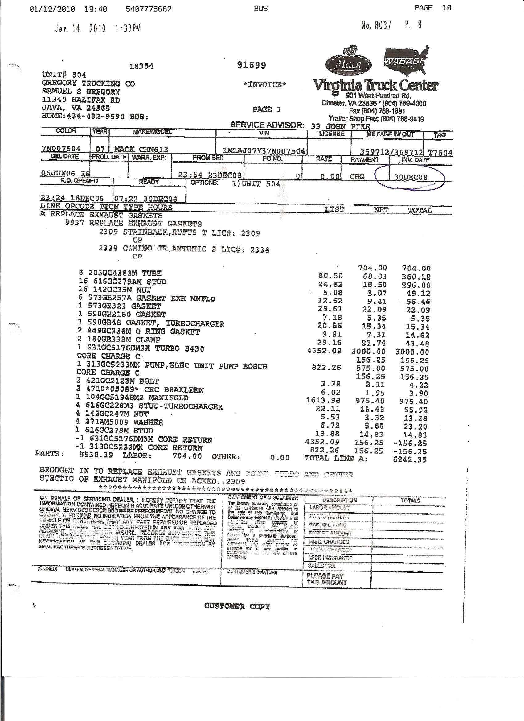

This is what my wife found and am having her load it onto bmt. Date is December 08 at 359,712. It has less than a 100,000 miles but I might be screwed on time.
Let it idle for 16 hours last night and when i left the truckstop this morning smoked like an old pos detroit that was on fire.
Smoke cleared up after a few miles.

I'll look into it for warranty monday morning.

>Let it idle for 16 hours last night and when i left the truckstop this morning smoked like an old pos detroit that was on fire. <
Far as Im concerned ,look no further than that statment above For your oil burning problem and the turbo leak!
Idling is the absolute Worst ,thing you can do to a diesel or any kind of engine No ,load is a no no period!
