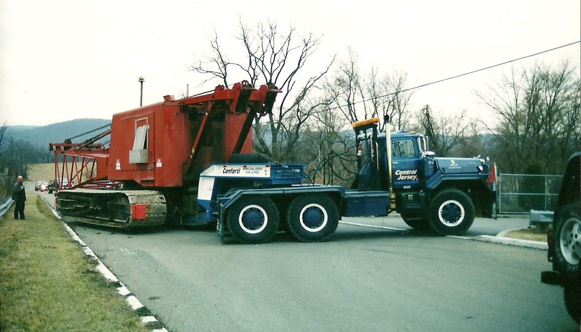

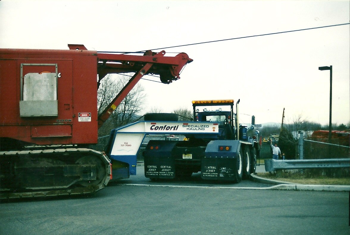

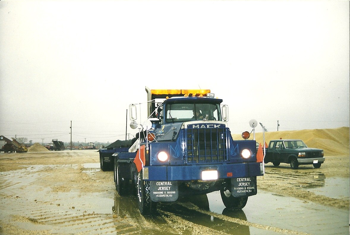

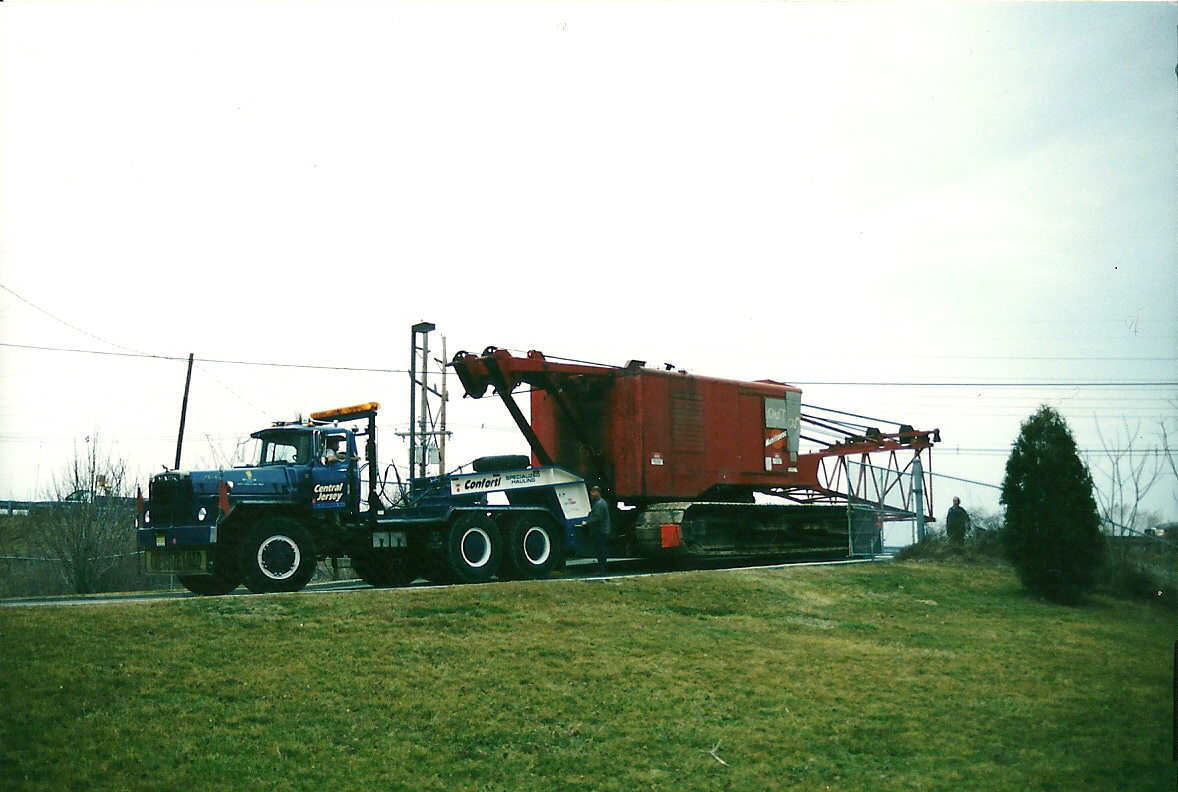

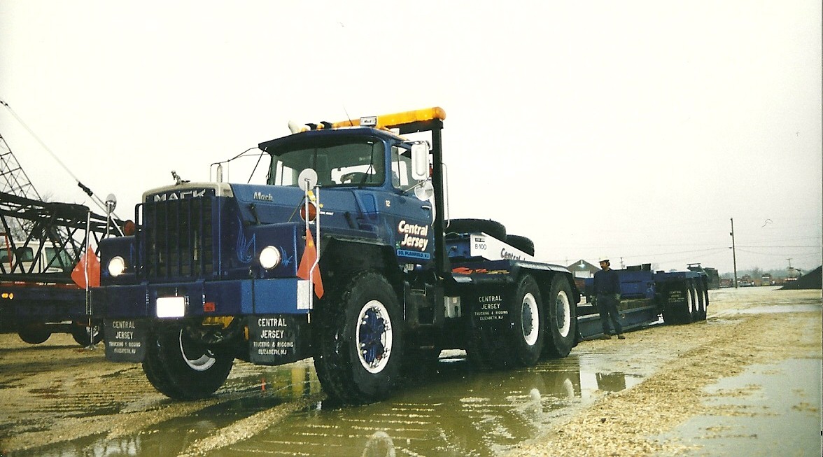

At the request of ThaddeusW, here are a few pics of Central Jersey Trucking & Rigging's 1975 DM897SX from back when Frank Conforti was still its driver. Photos were taken pre-2001/2002 by Dave Pearson. At the time, Frank Conforti was already running his own heavy hauling business and would rent Central's DM800 as needed, and would drive the truck for Central when they had work for it. He was the sole driver of that truck from 1991 to 2002.
The truck was built by Mack Canada in 1975 and spent @ 1 year pulling a dump trailer off highway in Canada. In 1976 it came to the States where it was purchased by DePhillips Crane of NYC, where it was mated to a 1974 Rogers 150 ton I-beam trailer with optional level deck insert. Trailer had hydraulics on both ends so the deck could be laid flat on the ground. The truck was later operated by Zano Industries of College Point, NY, before being purchased by Central in 1990.
Specs were as follows:
-1975 Mack DM897SX...built by Mack Canada. Truck originally used to pull off highway dump trailer.
-original Mack V8, either 325 or 375(can't remember) replaced by Cat 3406A 400 hp in 1990.
-original 5-speed Mack Transmission replaced by Fuller RTOO12613 13 speed main and 4-speed Spicer air-shift Auxilliary in 1990.
-new fully dressed DM800 cab installed in 1990.
-Mack 23,000lb. front axle
-Mack 100,000lb. Planidrive rears on Mack Walking Beam suspension
-S-cam air brakes on front axle, air over hydraulic wedge brakes on drive axles.
-Triple Frame
-14:00x24 Michelin XMP radials
-Holland 100 ton fifth wheel with 3 1/2" King Pin
-Top speed @ 45 MPH
Moving a 4100 Manitowoc crawler crane for George Harms Construction somewhere @ 2000-2001
