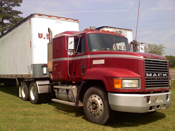

  13. 1994 CH613. Sold the truck couple of weeks ago but plan on painting my 1999 the same way.
