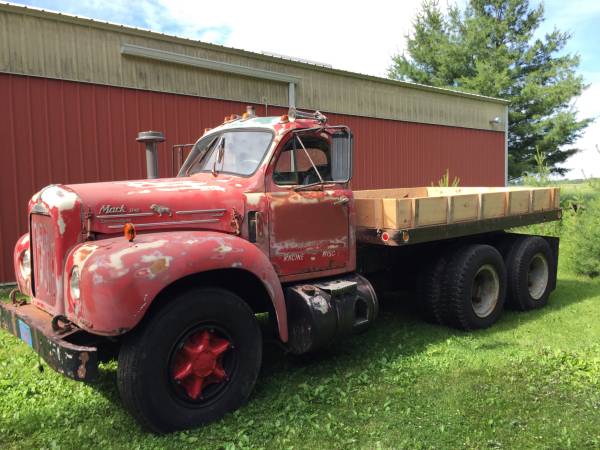

  15. The floor needs attention but thats an easy fix as I have located a couple donor cabs with nice floors. This one has a quadbox, Im still honing my shifting skills with it.

  18. This truck was a road tractor but the fifth wheel plate was removed. The bed was on there when I purchased the truck. I had originally planned on removing it and putting a plate back on but think I'll probably leave it as is.
  19. Hello All, I have had my truck for one week as of today, had it hauled from WI to MN. Its a 1964 B61 ST with the 673T engine. Here are a few pictures that the PO took of the truck. I will have to take some more now that its home. I plan to start changing all of the fluids and then go from there. -Jeremy
