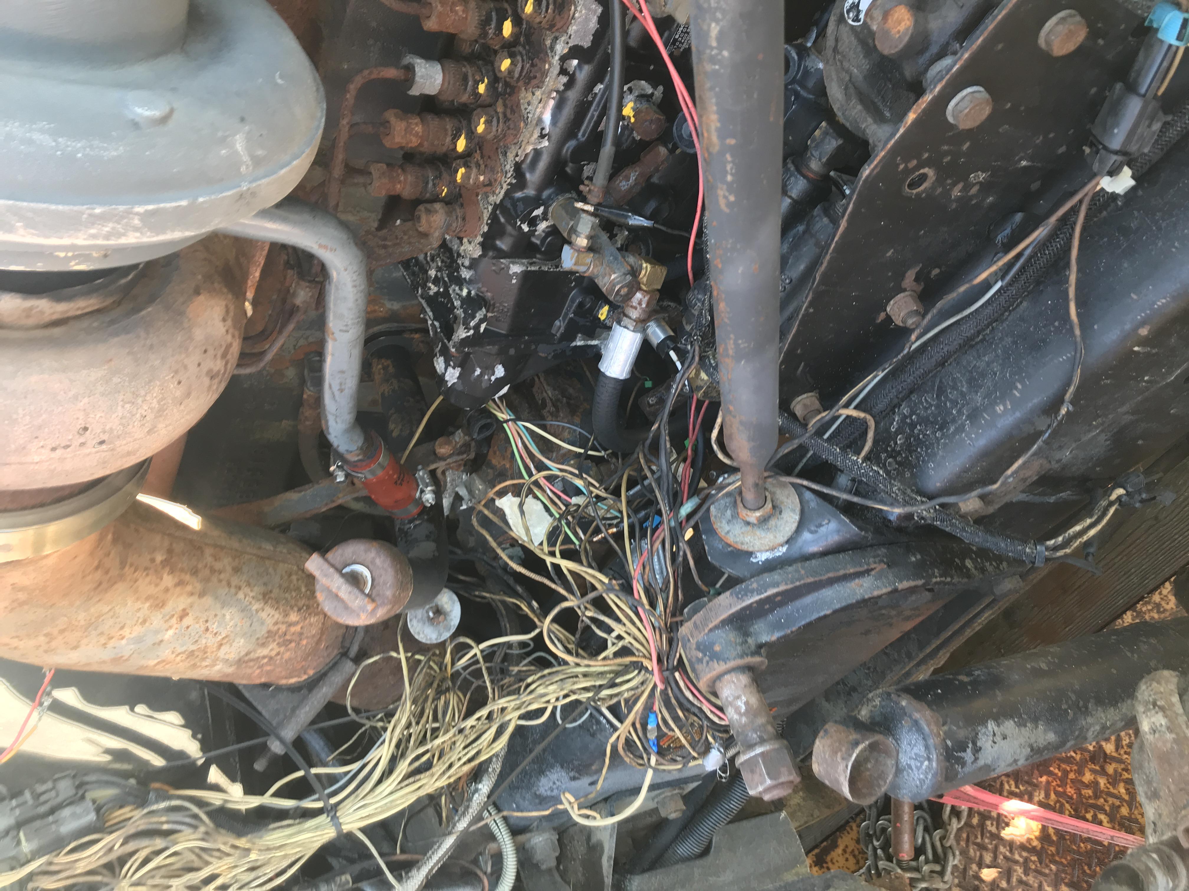

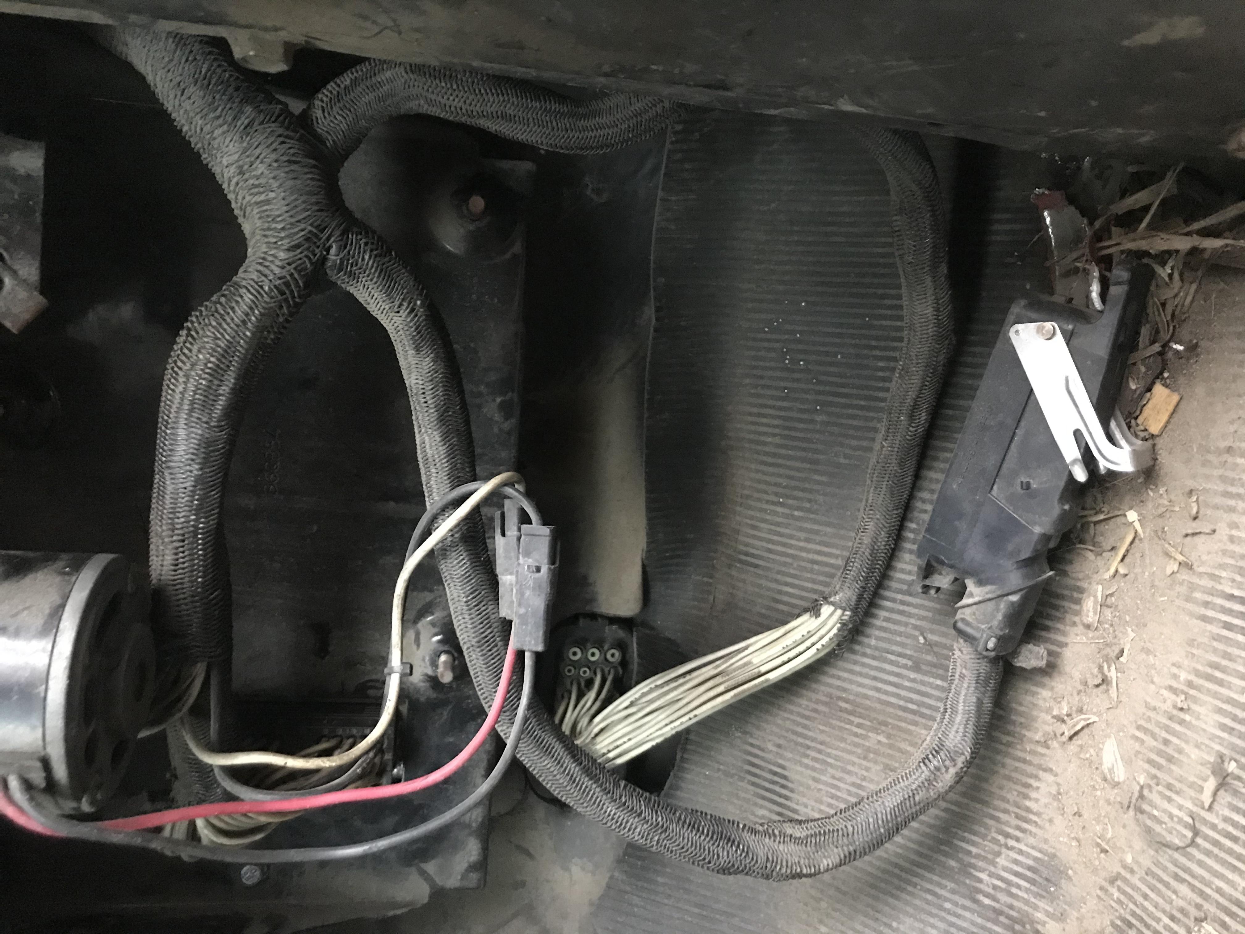

I know this is more of an electrical question but engine seems to get more views. I was wondering if anyone could give me the pin/plug location and colors of the wiring on the pump side of the harness? My plugs were cut off and the wires were just twisted together, and honestly I don't completely trust the locations. I've gone thru the schematic with my meter (no wire numbers are left on the chassis harness) and have the chassis side figured out back to the FIC. There isn't ant numbers on the pump harness just color coded, using my meter I have things hooked up with my best guess. My pump speed sensor is bad I'm pretty sure because I can't find any combo that matches what the service manual says the pump sensor should ohm at, but I don't believe that would stop it from starting. I've pulled the rack plug and am getting no rack movement, just would like a more educated guess on the rack actuator and position sensor before I start swapping wires. Thanks.
So an E6 pump may work on an E7? I picked up an E7 v-mac 1 over the weekend that is truly a wiring disaster. The worst part of it all is that upon further looking the FIC is missing. I can handle the wiring, but not having much luck so far with the missing module. Does anybody know if the FIC is vin specific to the v-mac control or is it a slave controller to it? Anybody have any leads on a FIC?? I’d like to try fixing the electrical side of it enough to see if it runs before going all in and doing the mechanical swap.

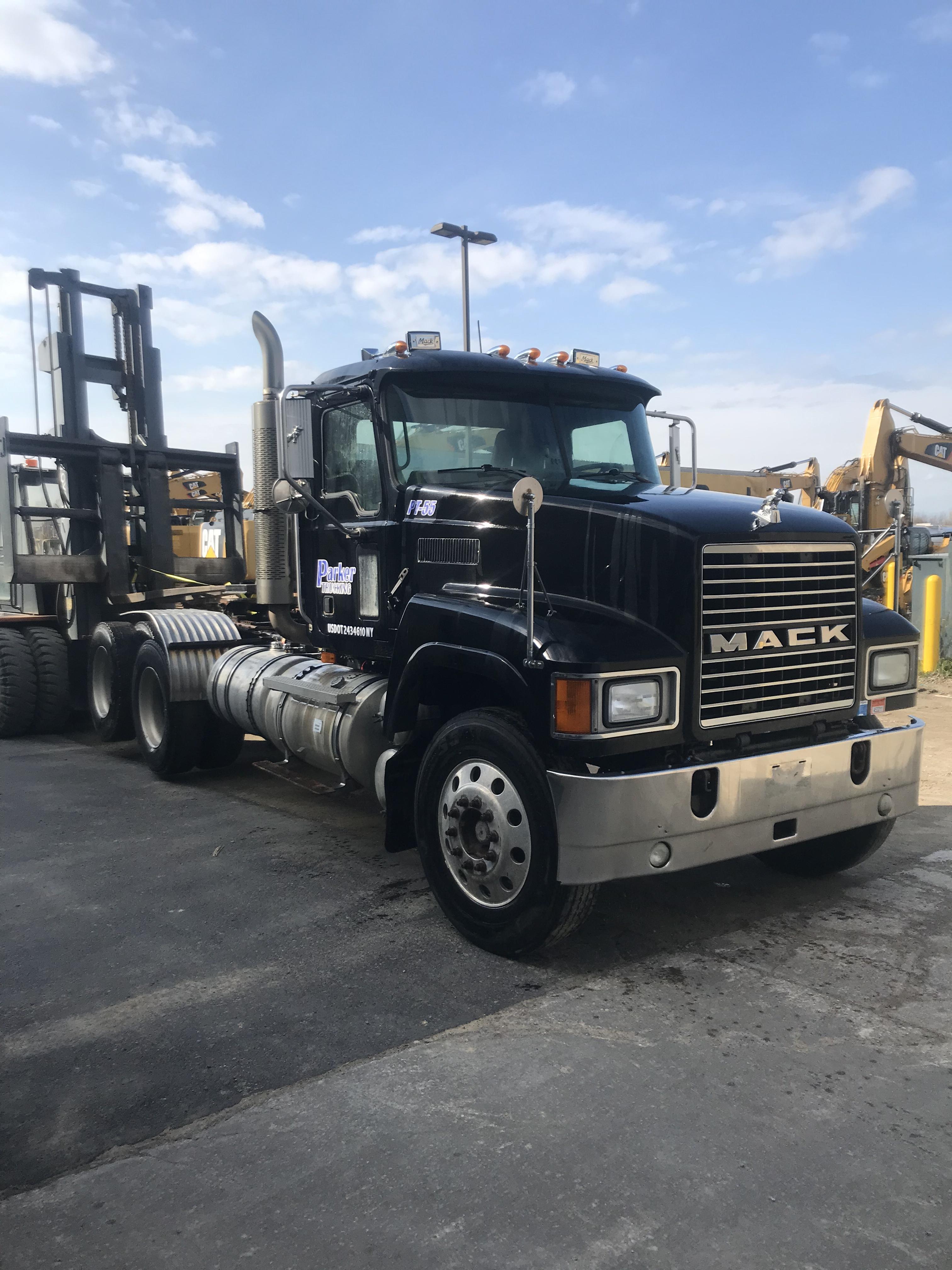

I picked up a nicely spec'ed CH a couple weeks ago. Bought it knowing it had an inspection window at number 5 and I would be doing an engine swap. The original engine is an ac460, had around 18k hours and 522k miles, it's going to be a spare parts engine. I picked up an ac380/410 at an auction. Really know nothing about the engine other than it came from a cxn612 and I have the vin from that truck. I work (Field service for a cat dealer) literally next door to a Mack dealer, so getting parts is not problem. This is going to be a farm truck that gets 2-3k miles a year absolute tops. My plan is to freshen up the 380/410 mains rods, thermostats and remove the egr while I have the engine out and on the ground. I've checked with Mack and all the internals between the two engine swap are the same as far as pistons, pumps, injectors and turbo. I plan on swapping Ecm's to get the 460 setting. Other than EUP programming are there other calibrations I'll need done? Turbo, throttle position??? Also, the CX had an air clutch fan vs the electronic viscous on the CH, I prefer the simplicity of the air fan and can't imagine it would take much to make it work on the CH but is the viscous the better choice for any particular reason? Also the 460 had a powerleash, the 380 is powerleash ready. I've got the aset manual downloaded and have looked over powerleash bulletins, it looks like the biggest thing is to definitely replace the rocker bolts, other than that it seems as simple as following the adjustment procedures. Is there anything else I should do or look at while I have things apart?

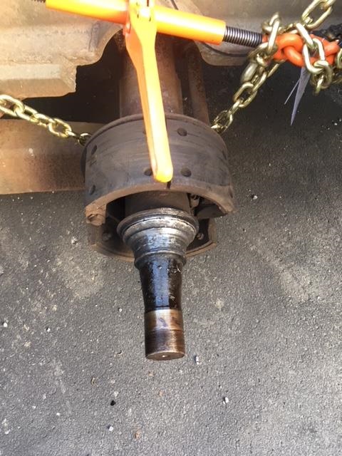

So I bought this thing. I called the guy and talked with him, his father had bought it new and they used it occasionally. They supposedly had just gone over it making sure everything was good as the ad had said. Seemed like a real straight up guy, so I sent him a check and parked my truck at his yard on our way to NJ fpr thanksgiving. On the Monday after we met up and transferred the title, no problems. It was all down hill from there, hooked up and only a couple lights, no biggie its old and my wife will be following me anyway. OK, so now no brakes, well I'm empty and my truck has good brakes, is what it is. So we take off, make it 12 with 250 to go and smoke, damn... you can see what I found in the second picture. This was after finding a small shop that was open on the first day of deer, I carry tools, just not enough for tearing off a wheel. So chain up the axle and put some grease in the other wheels. I made it to state college when another starts getting hot. We were 5 miles from the central parts facility of the company I work for, so I drop it off there and we head home. I ran down the following Thursday and retrieved it with my pickup and gooseneck. I tore it apart and got lucky I guess, no real damage to the spindle and I only needed an inner set of bearings. I'm gonna convert it over to oil filled hubs and replace the hardware for the brakes, along with re wiring and re plumbing. The trailer is in really decent shape with almost zero rust and is rated for 60K. It'll work perfect for the few times I want to move a piece of rented equipment from work to home. I wish the owner had just told me the truth about the thing, I would have still bought it just would have hauled it in the first place.
