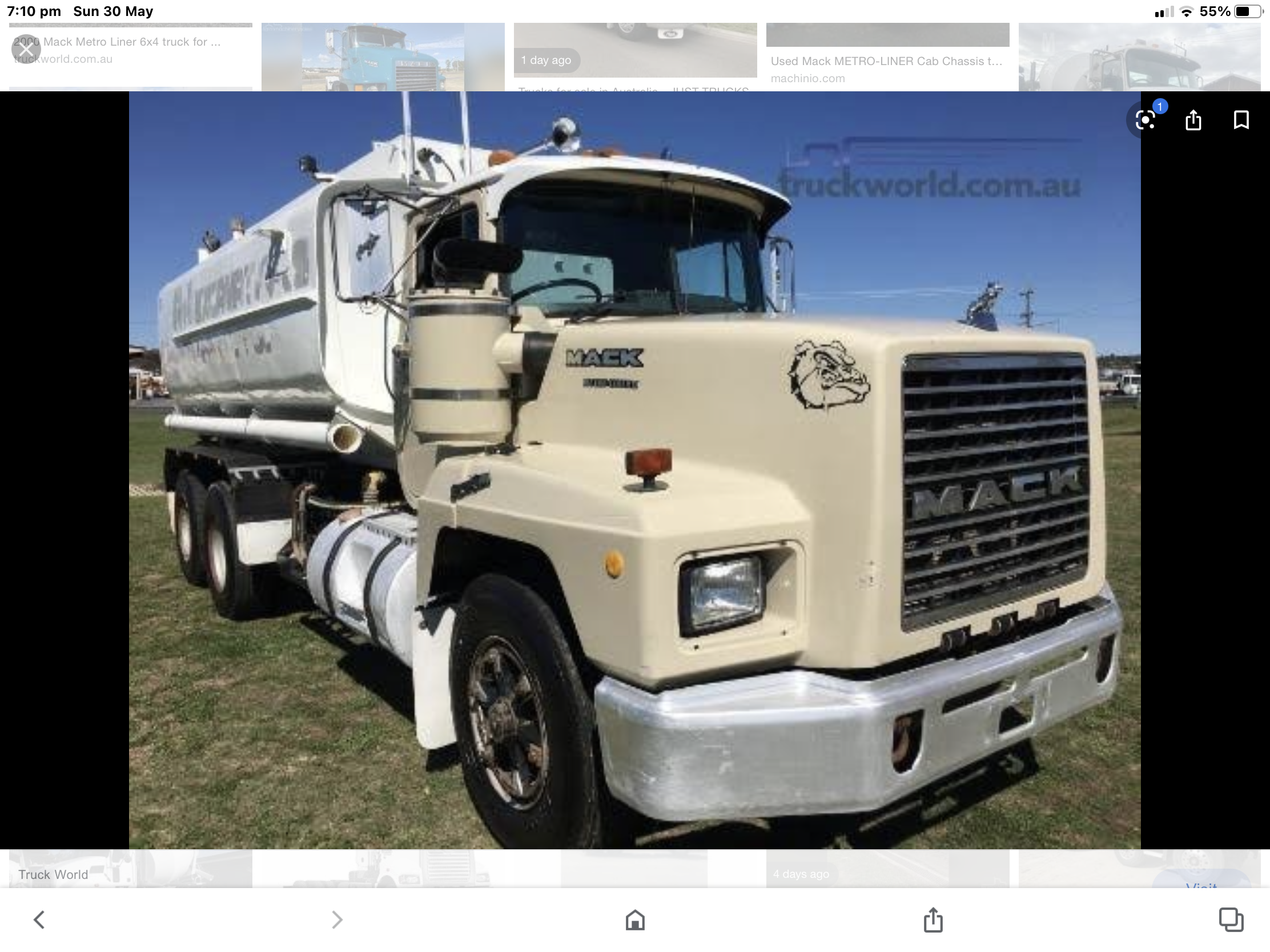

  5. Similar to a metro liner we have here in OZ, approx 1994
