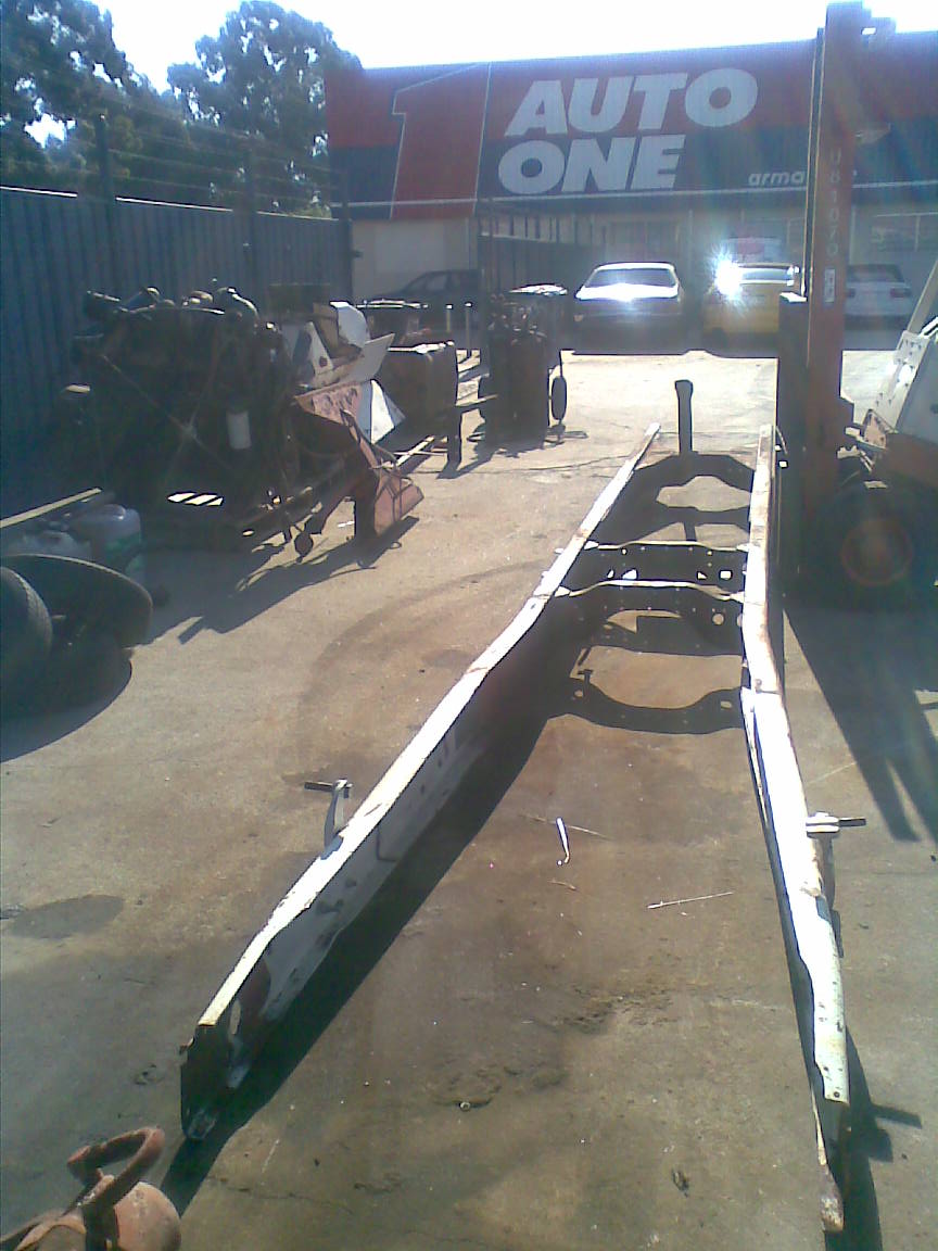

  6. The first one took all day, the second one 2 hours once we had foundd a system that worked. now i have to straighten the one we bent! Grant
  7. Will do, am hitting them today with a needle gun, them get them blasted! I nearly bought brand new rails yesterday if these didnt come apart, new ones were 13,000 aud for un drilled 343 inch long rails that were just under 11 inches high, these rails are only 9 inches. the price stopped me! Grant
  8. Got them apart! tried by driving them into a 20ft container weighing 10 ton and failed, then welded 2 nuts half way down chassis and used a bolt to push inner rail out of outer rail. now for the clean up. what paint shuld be used to stop them rusting? Grant

  10. Hi, they were made in 1969, so not heat treated, I will avoid heat, today they got a gallon of phosphoric acid to break down the rust, still no luck but tomorrow am putting it against a 20 foot container and putting a forklift thru it! dam thing! the rust is not bad compared to most I have seen, but I do have to split the rails, not stopping now! Grant
  11. Its gone about 60inches down and stopped, am now worried about kinking the channel, will find a wedge, need a long bar tho. thankyou for suggestion. Grant
  12. Hello, any one split a R model chassis? the one with inner and outer rails. I have this thing stripped and cant get the inner rail out of the outer rail, it does have rust between the two but am surprised to see it still together after 3 hours of argueing with it. pic attached is prior to cross beams out, i now have the two rails laying flat next to each other, would like to see 4 tho. are they hard to get apart? any specific techniques? any help would be great, thankyou Grant
