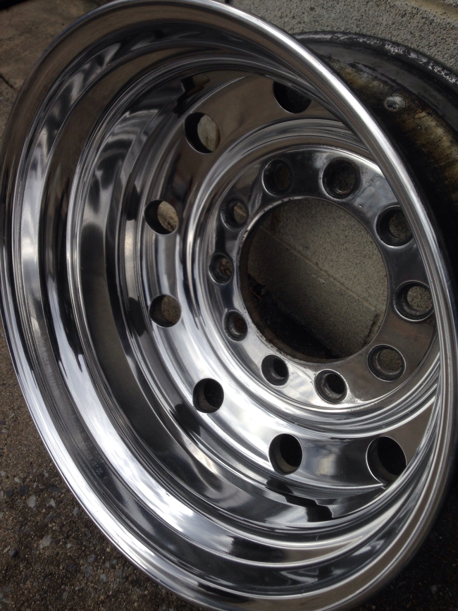

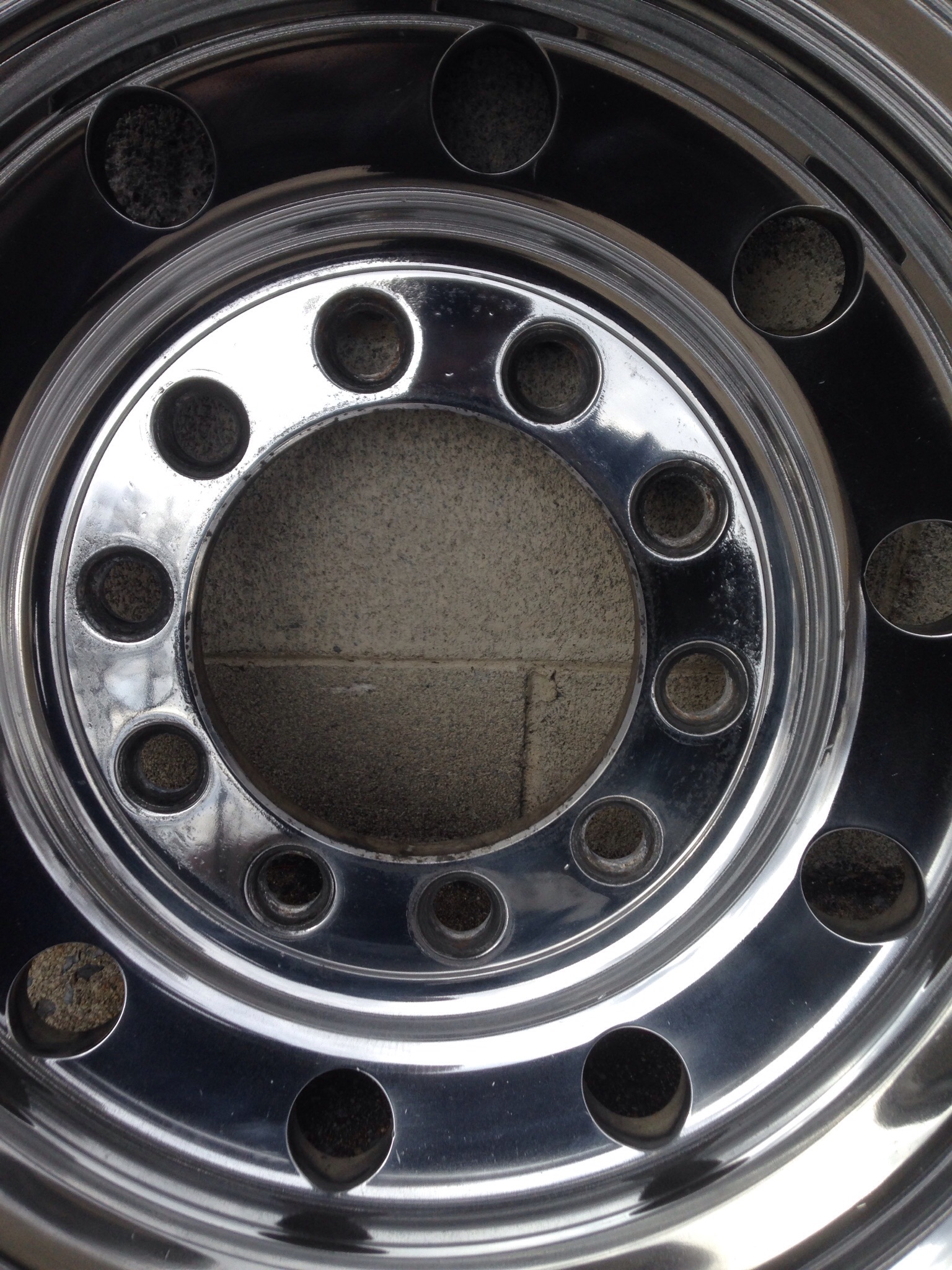

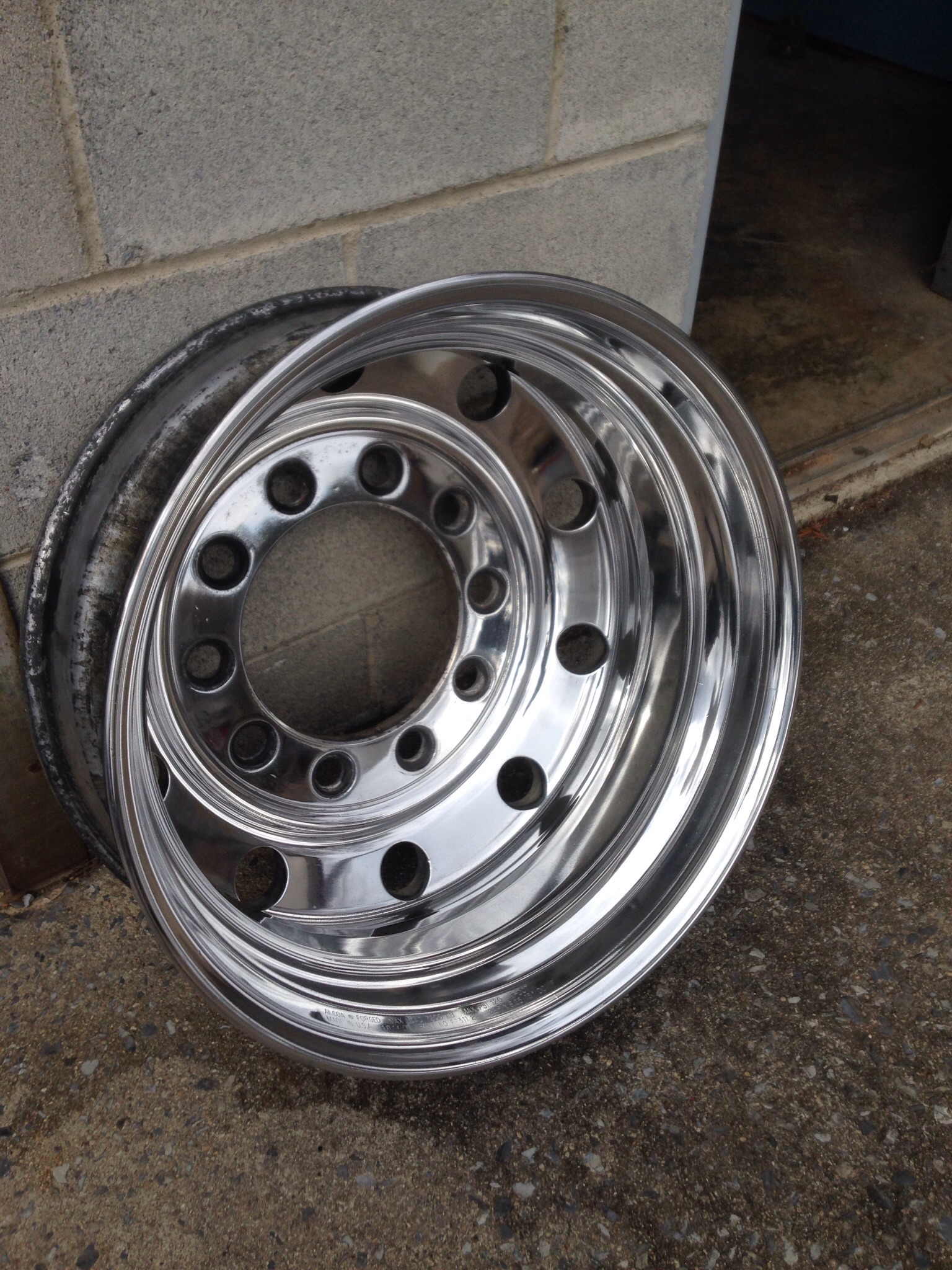

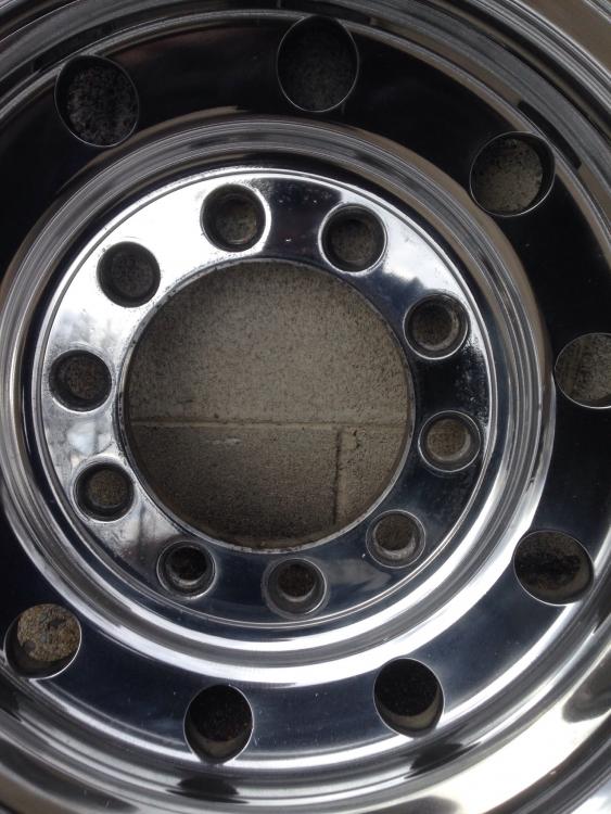

	I have four used inside polished alcoa 22.5 x 8.25 rims. Asking $725 for the set of four. There are some knicks and pitting that do not show up in the pic. Located in Poconos PA. I switched over to hub pilots so i do not have use for these anymore. Thanks
