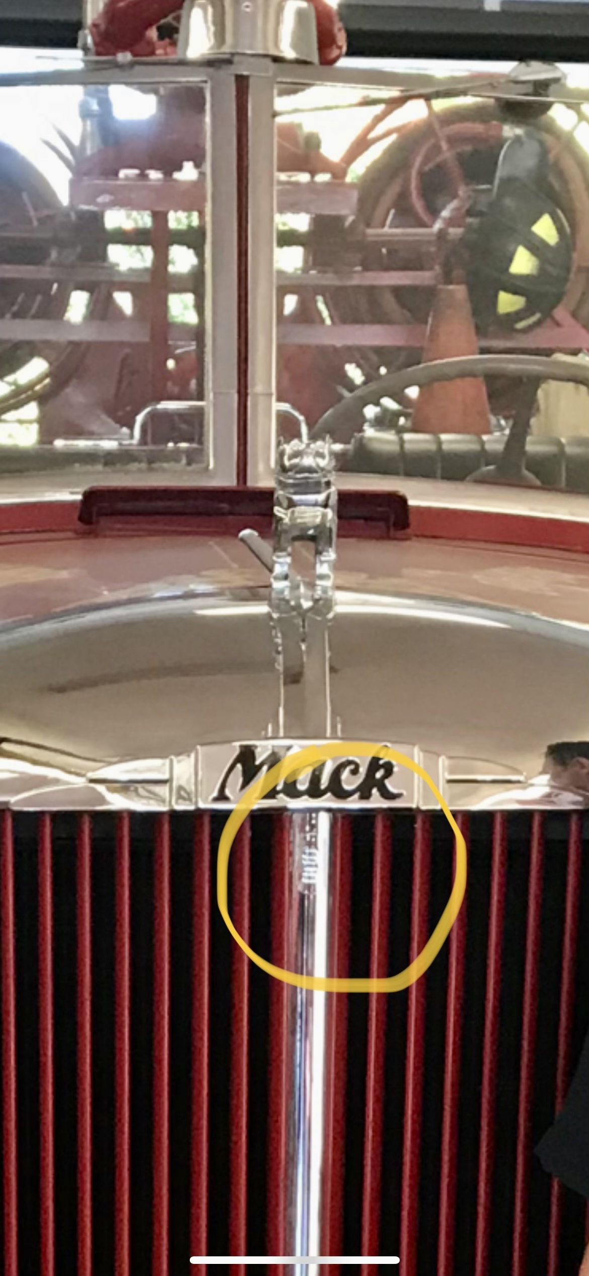

  1. Hi guys. I recall someone making the grill plaques based on model. Anyone have a contact? We Javan LS125 with no “125” plaque for our grill. We are just looking for the thin 126 not thr grill or Mack. Thanks. Dom amy help is appreciated

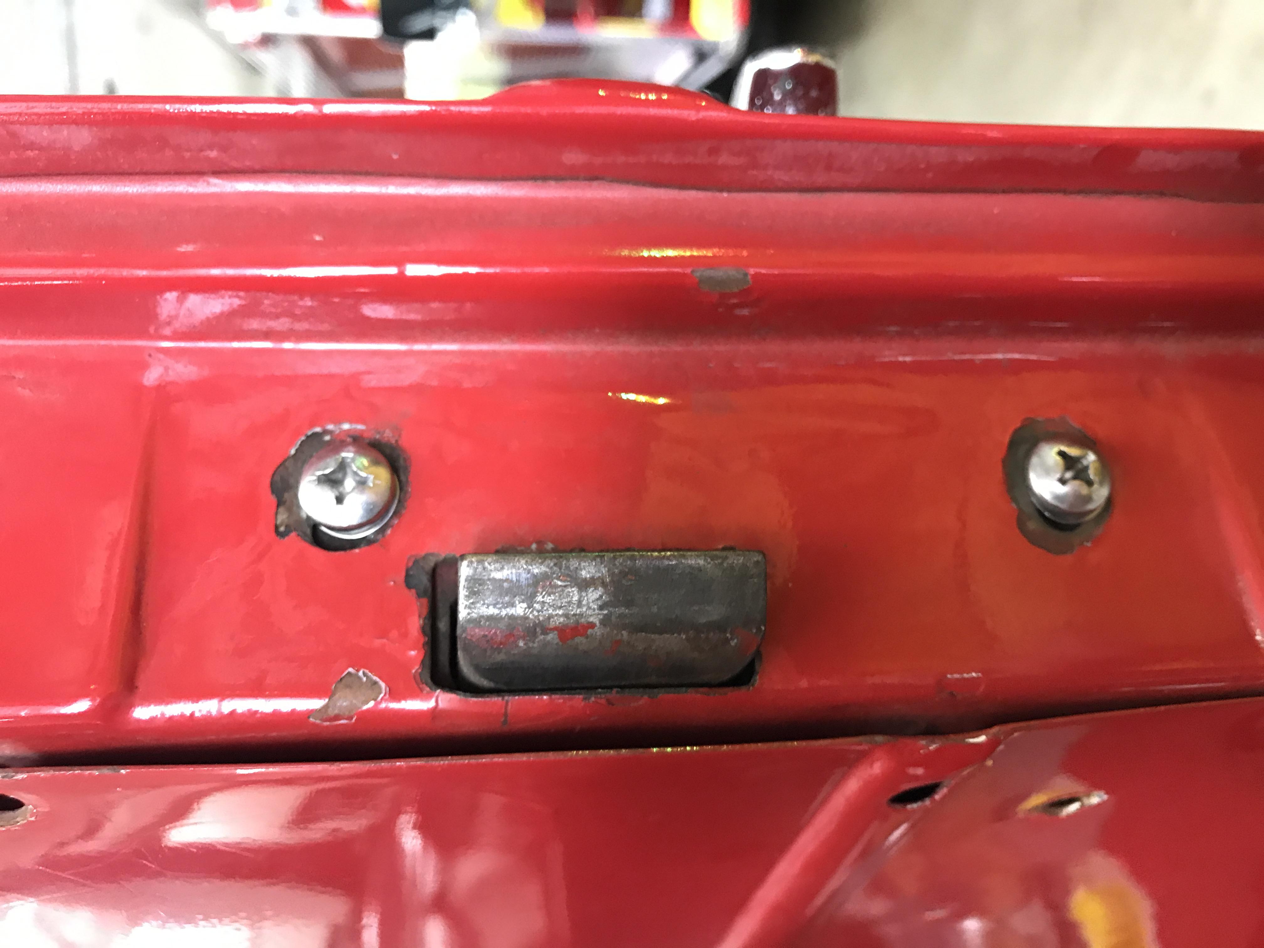

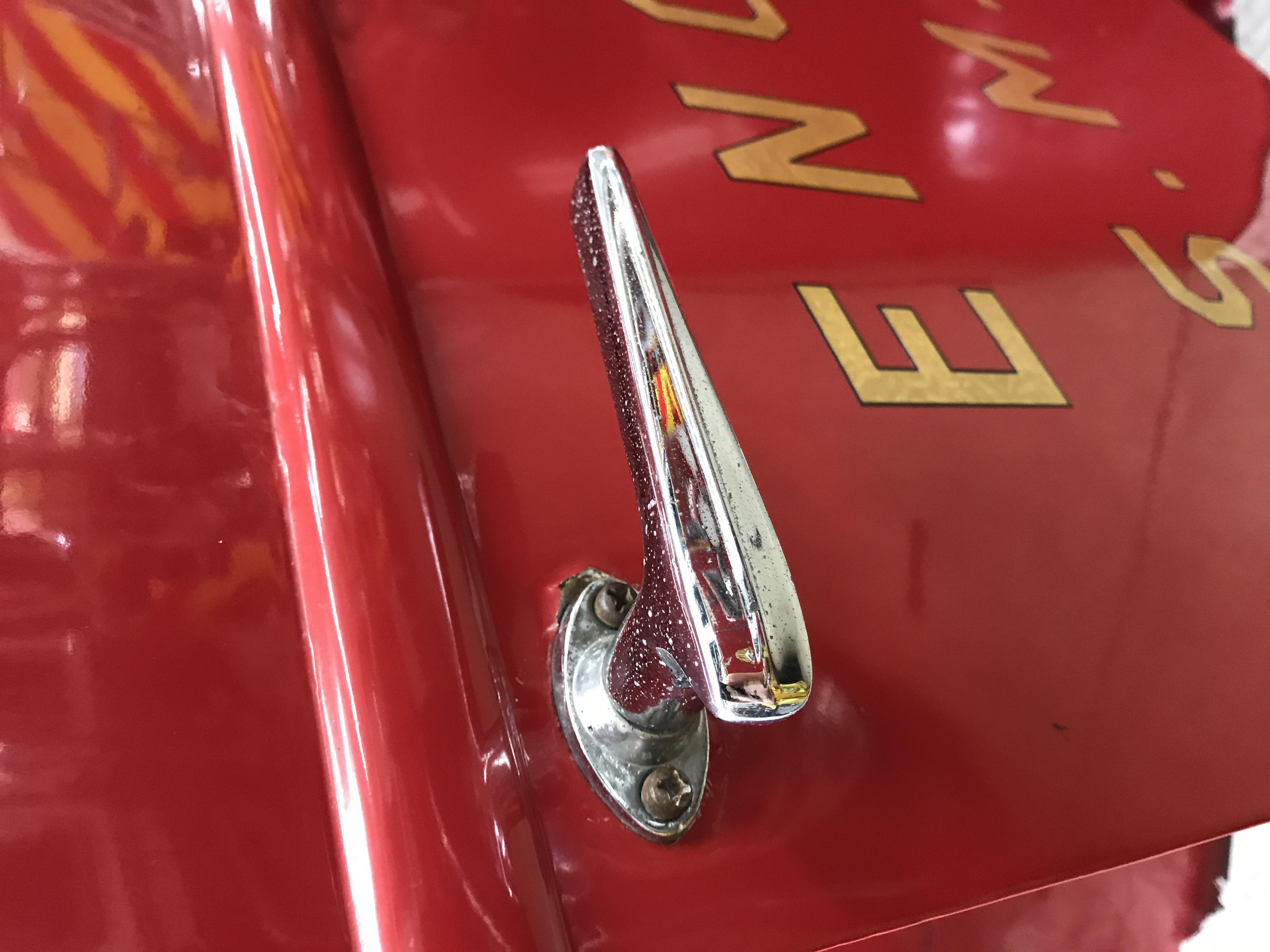

  5. We are looking for a front door handle and latch assembly (see pics) for our 52 LS125. I’m not sure if they are universal or right/left specific. Could probably use either one and make it work. Thanks, Dom
  6. Paul- Thanks for the tip. I’ll probably grab a set and see how that all looks. We will eventually need to rehab our original setup. Thanks for taking the time to post up.

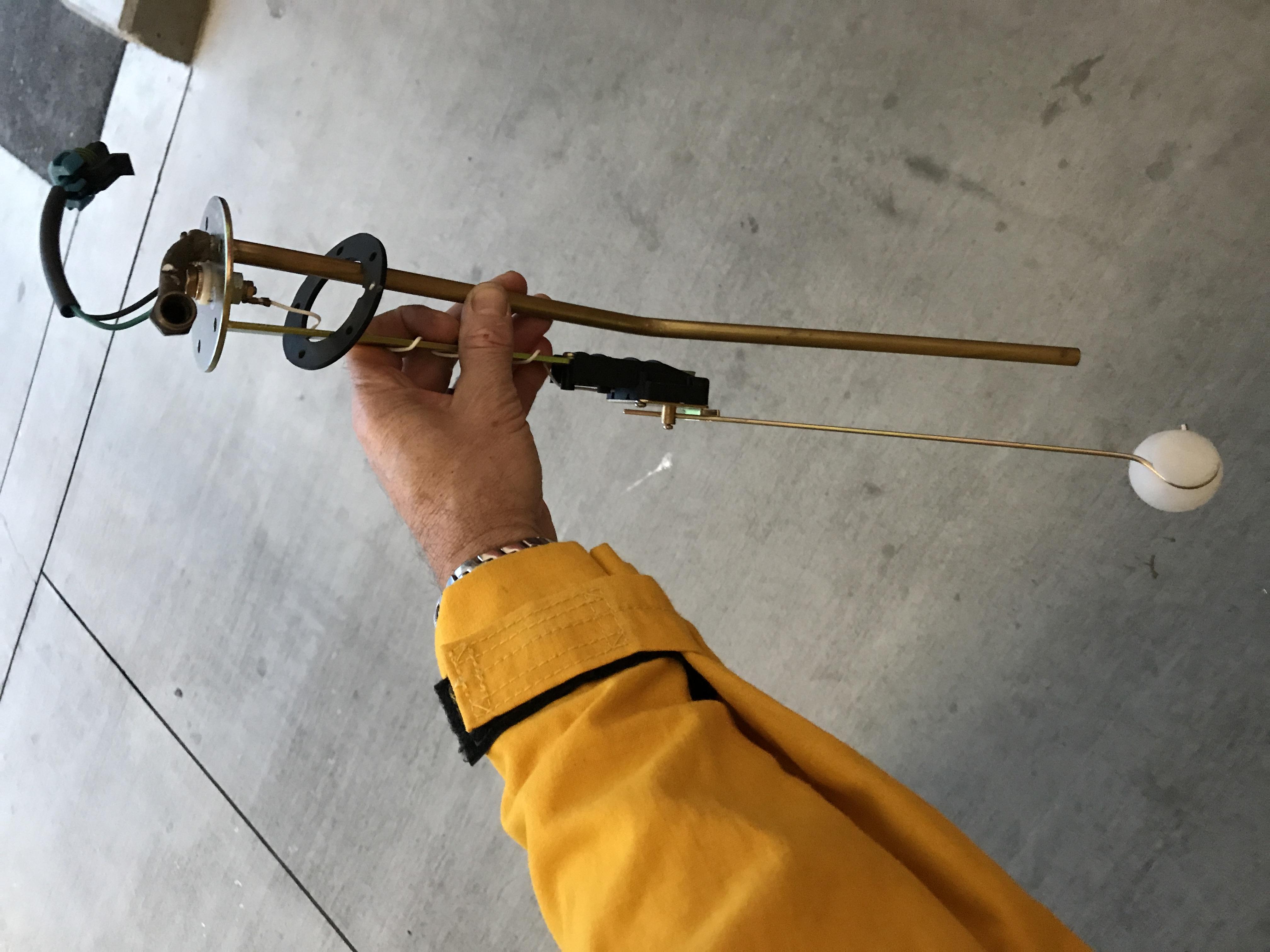

  7. So we decided to make our own. We are using an NOS Pierce sender that we drilled a hole in for the original pickup tube to be inserted. Adding a matching VDO fuel gauge so we know when we need fuel. All this until we pull it all apart to refurbish the gauges then we’ll do the sender at the same time.

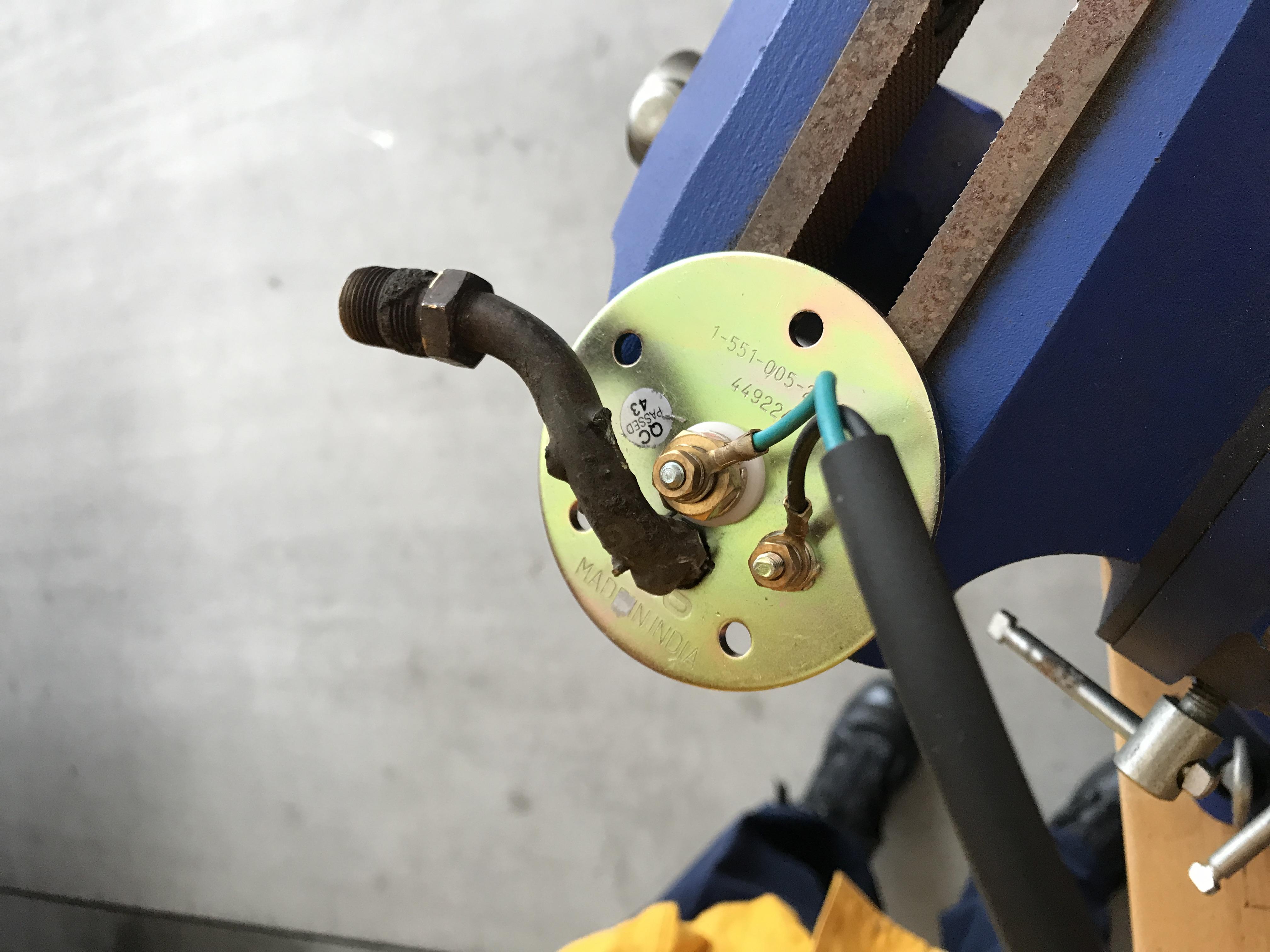

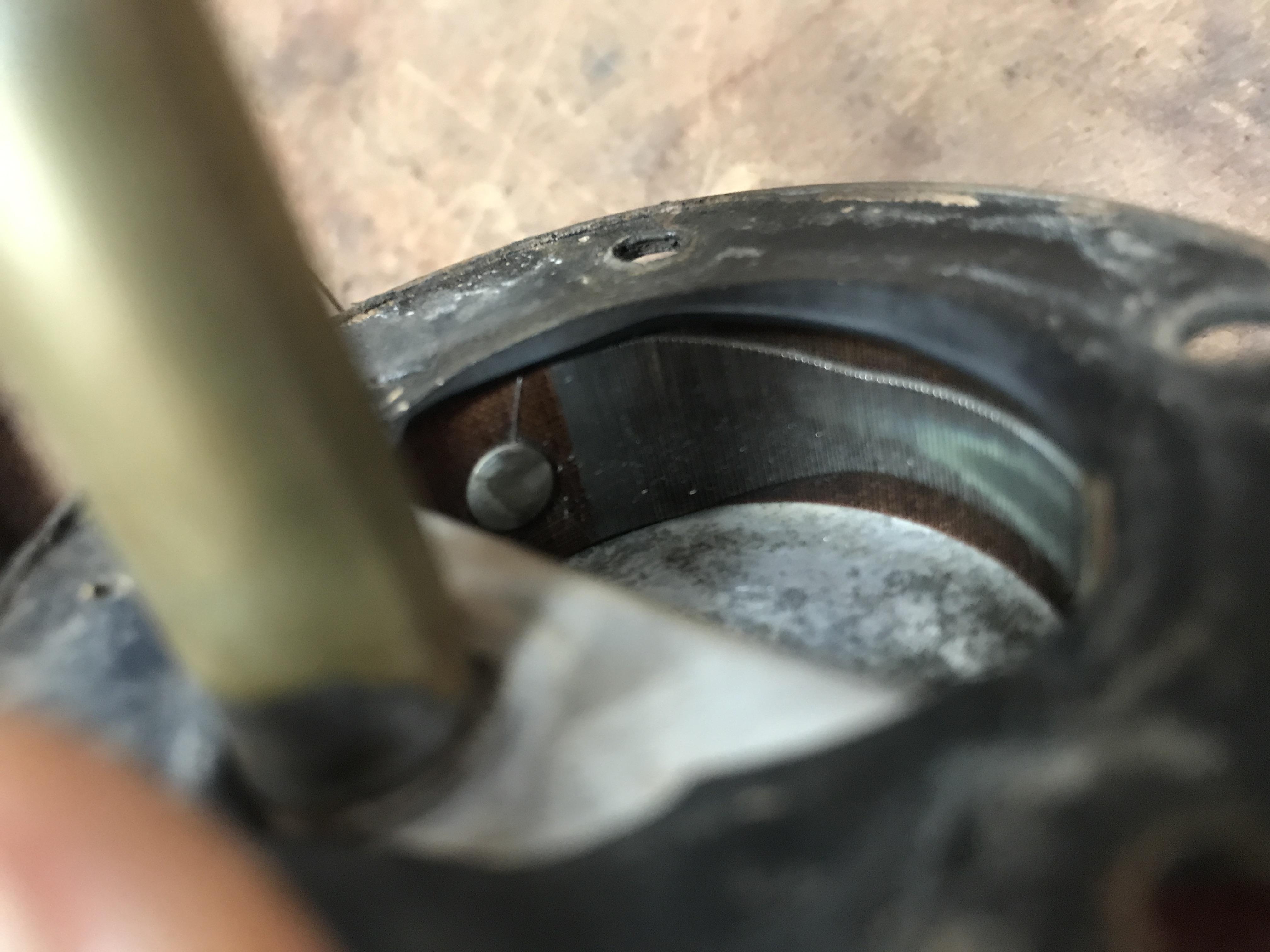

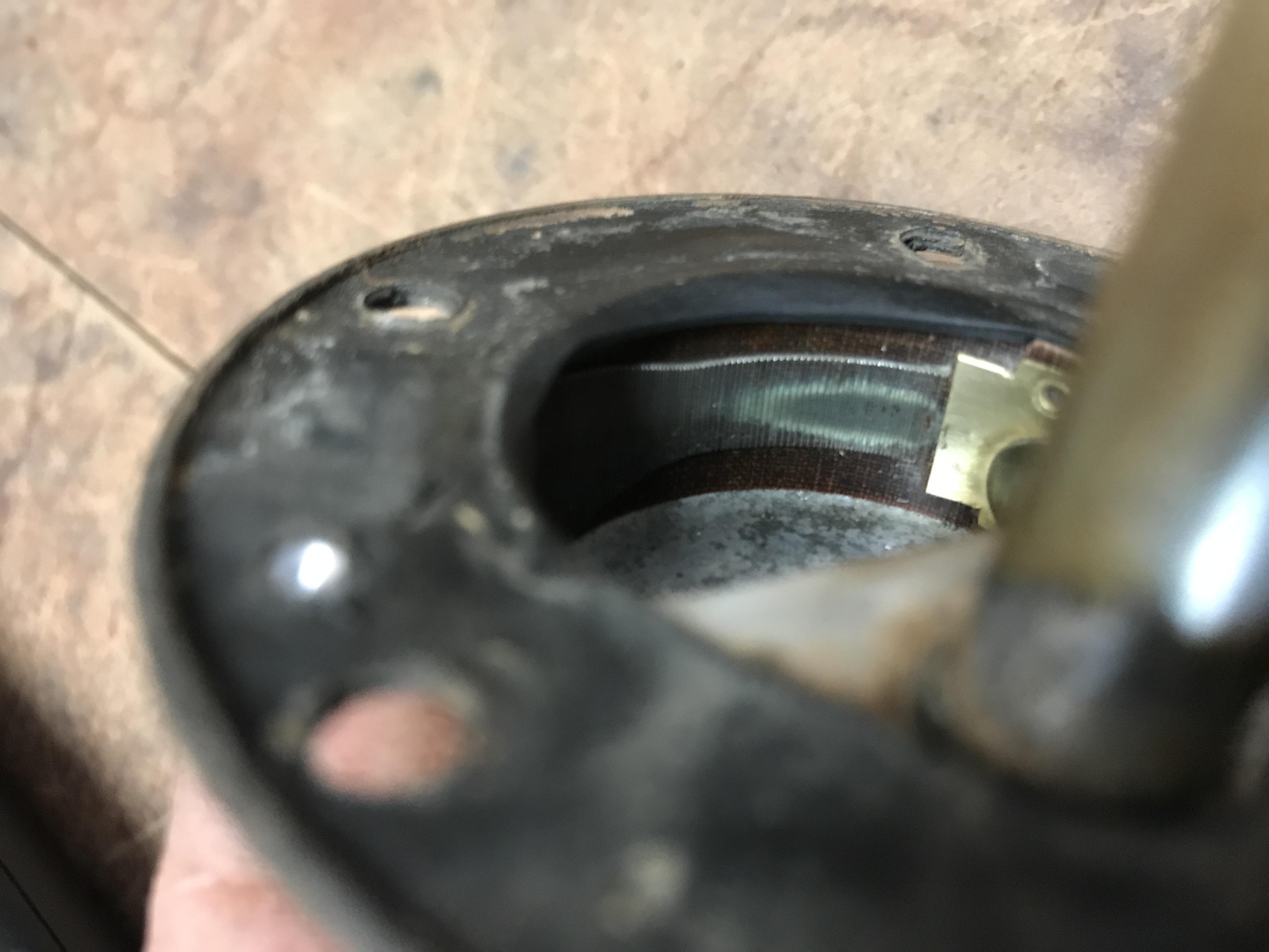

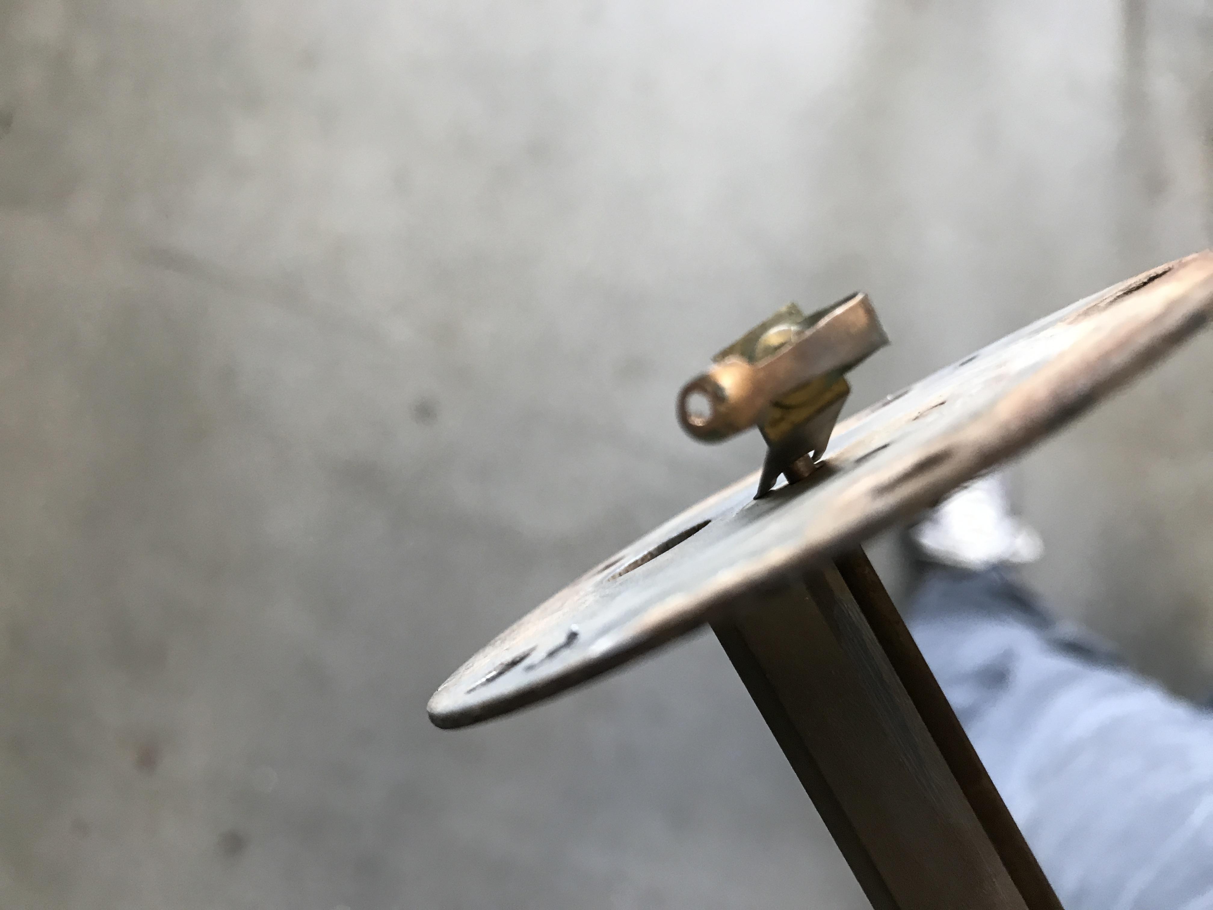

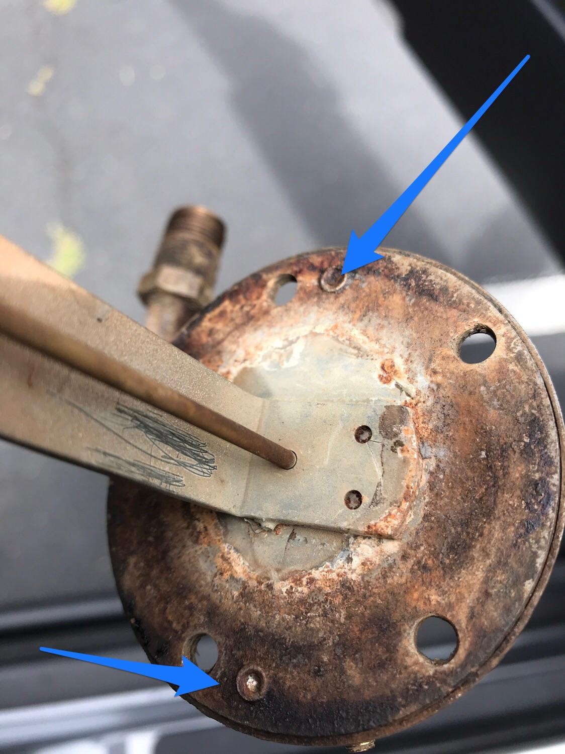

  9. I decided to dig into this and see what was going on inside. I tried to attach some pictures of the process but for some reason the site is not playing nice. Here’s what I did: 1. Drilled out 2 small rivets 2. Used a tiny screwdriver to pry the 2 flange pieces apart. They are separated by a rubber gasket. 3. Used some pliers to bend the fuel tube retaining tabs so it was free. 4. Removed sending unit piece from the fuel tube piece The contact on the sender is worn and has a hole in it. I may see if my local alternator shop has anything that I can use to replace it. The other area area inside the top flange that houses the fuel pipe and rheostat that Chevy mentioned seem worn. I did try to clean them up a bit and it helped but not much. This would make sense why the readings are all over the place. It seems like the ohm range is 480-30 but I don’t see much on the web for senders in that range. Any suggestions on where to get parts? (Insert laugh here). I have not had much luck finding any senders with pickup tubes... maybe one with a built in fuel pump?
  10. Thank you for the reply. Everything I’ve found online is a sender only and no pickup tube. Bobs speedometer will refurbish ours but it’s out of our price range for the moment. I think i will carefully drill out the rivet caps and see what’s inside.

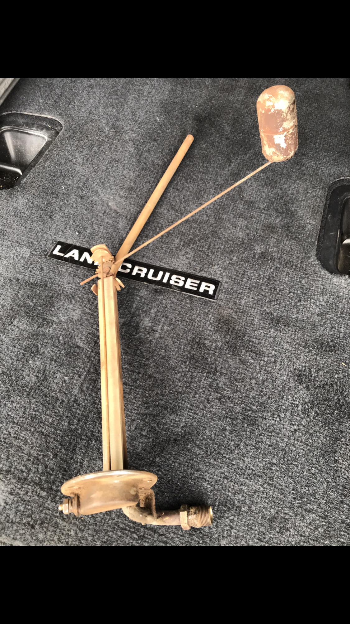

  11. So the local truck shop is no help with the part but he did suggest I may have a hard time finding the sender as it has the pickup tube built in. Anyone have a part # or suggestion on replacement? Getting a “-200 error” when trying to upload the picture.
  12. Would love some pics and dimensions. No hurry as we are a long way off from needing it but would be s good side project for one of our guys. Thank you, Dom
  13. Thank you for the information. Looks like a very easily duplicated item. Anyone have a picture of one from an L model Mack?
