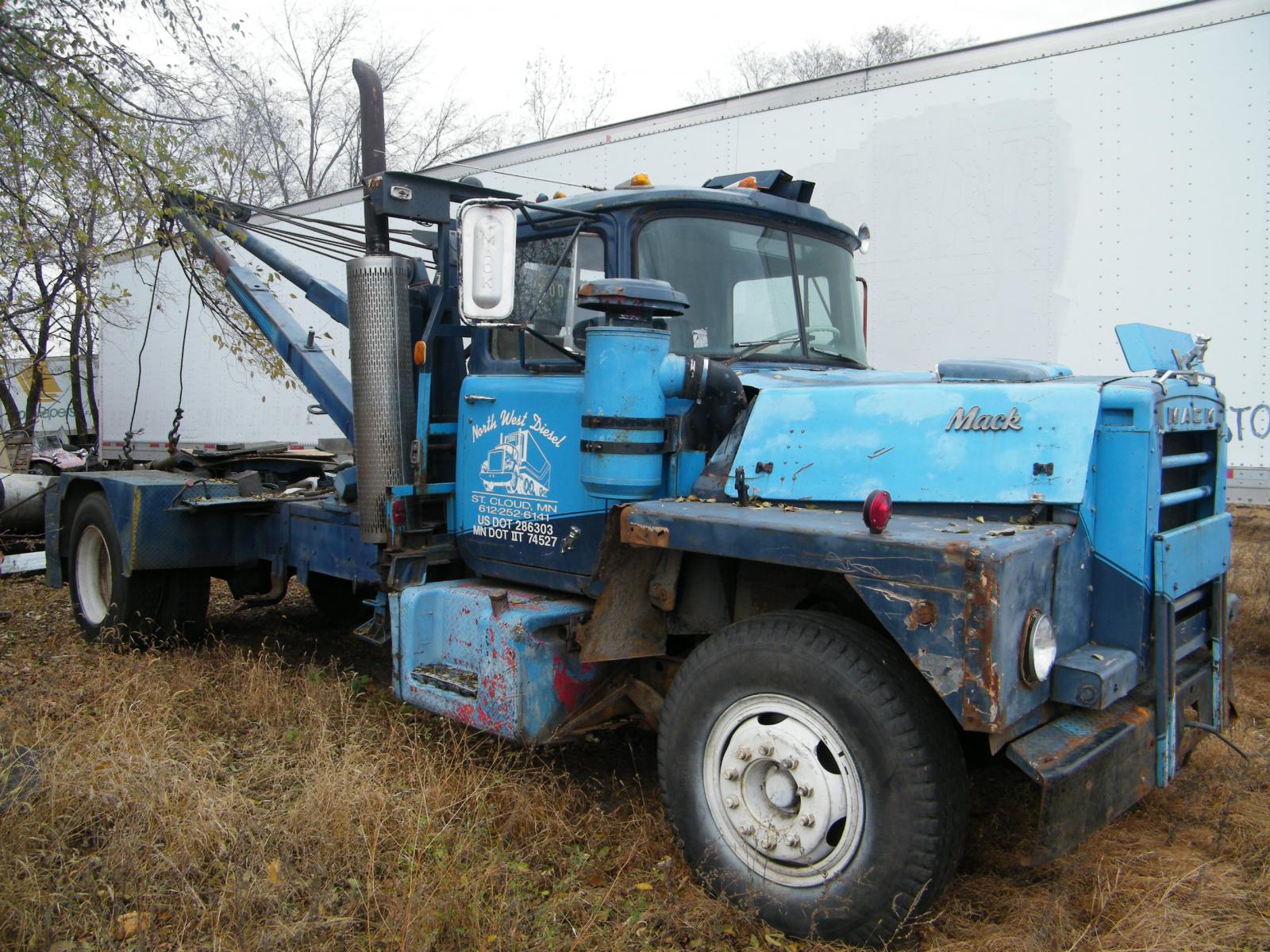

  17. Over the past few years, I would search Craigslist for 'Mack C600' once in a while and I finally found one for sale last month. The reason I would search is because my dad had a 1965 Mack C600 single axle dump truck back in the early to mid 1980s. When he bought it from a farm near Bradford, MN, it was painted an ugly dark green and had a snow plow on it. We sanded the paint and had my uncle spray it red with black fenders and I painted the interior a copper color with a spray can. It was a great looking truck. My dad sold it in 1985 so that he could buy a tandem axle gravel truck and I've missed that truck ever since. I got the electric start and power take-off to work on my truck now, just have the brakes left to repair at this time. As soon as I get the brakes functioning, I have a pond to dig near my house and I need the truck to haul away the spoil that I dig out. I could just borrow one of my dad's International gravel trucks, but that wouldnt be as much fun. Yes, that Ardin (or is it Arlen?) is an interesting fella. It had been 28 years since I was last there and I was surprised that the place was still in business. He told me that he sold this as a used semi-truck to Maier many years ago. I'll be heading back to see him again sometime this week if all goes well with the brake pedal assembly that he is repairing for me.

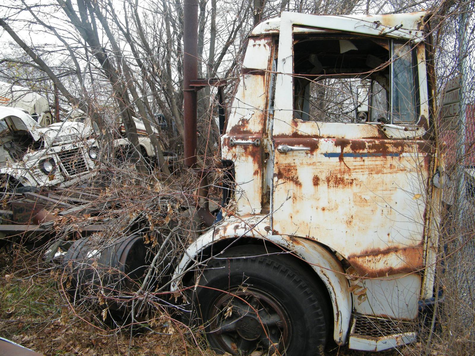

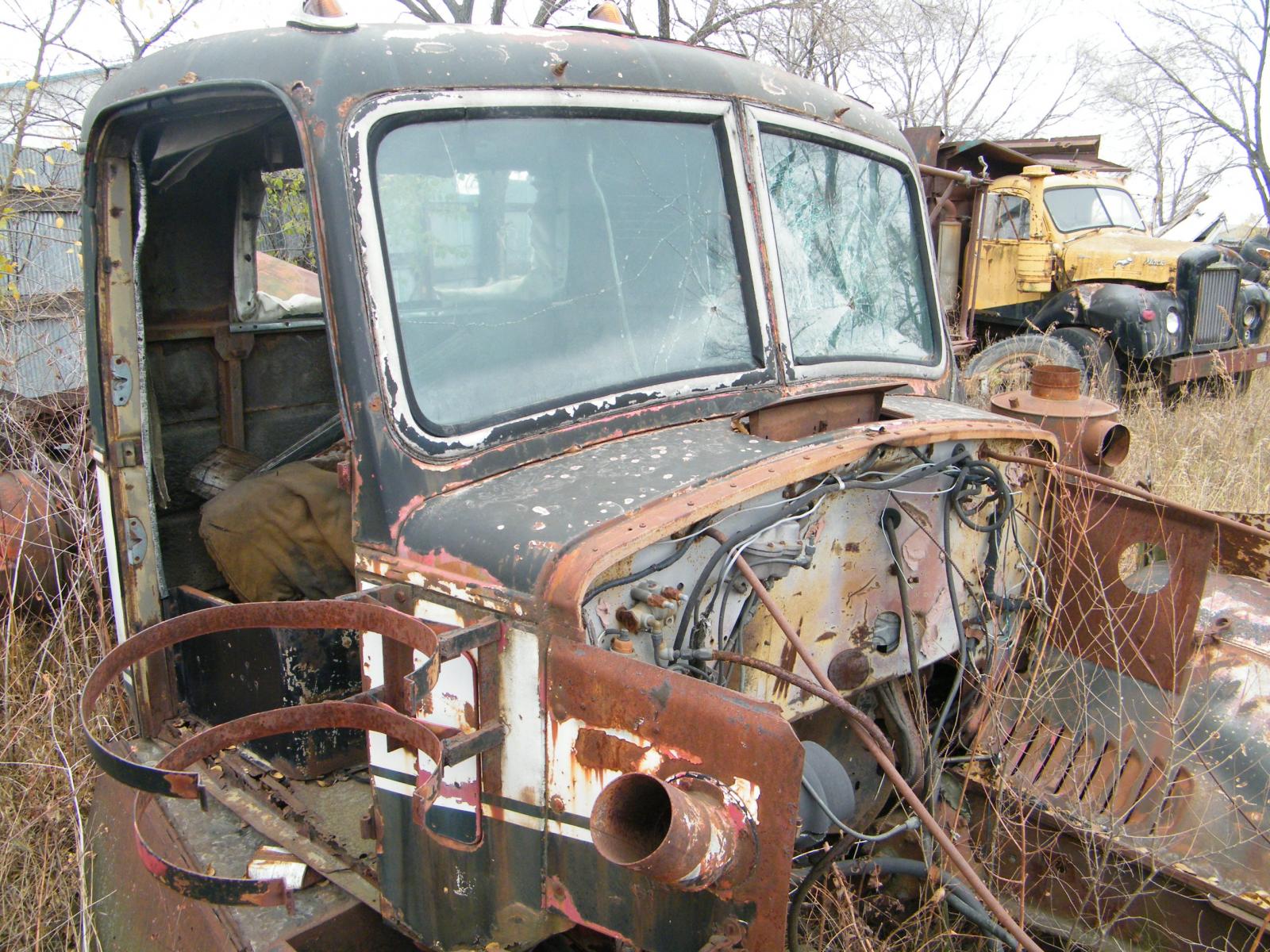

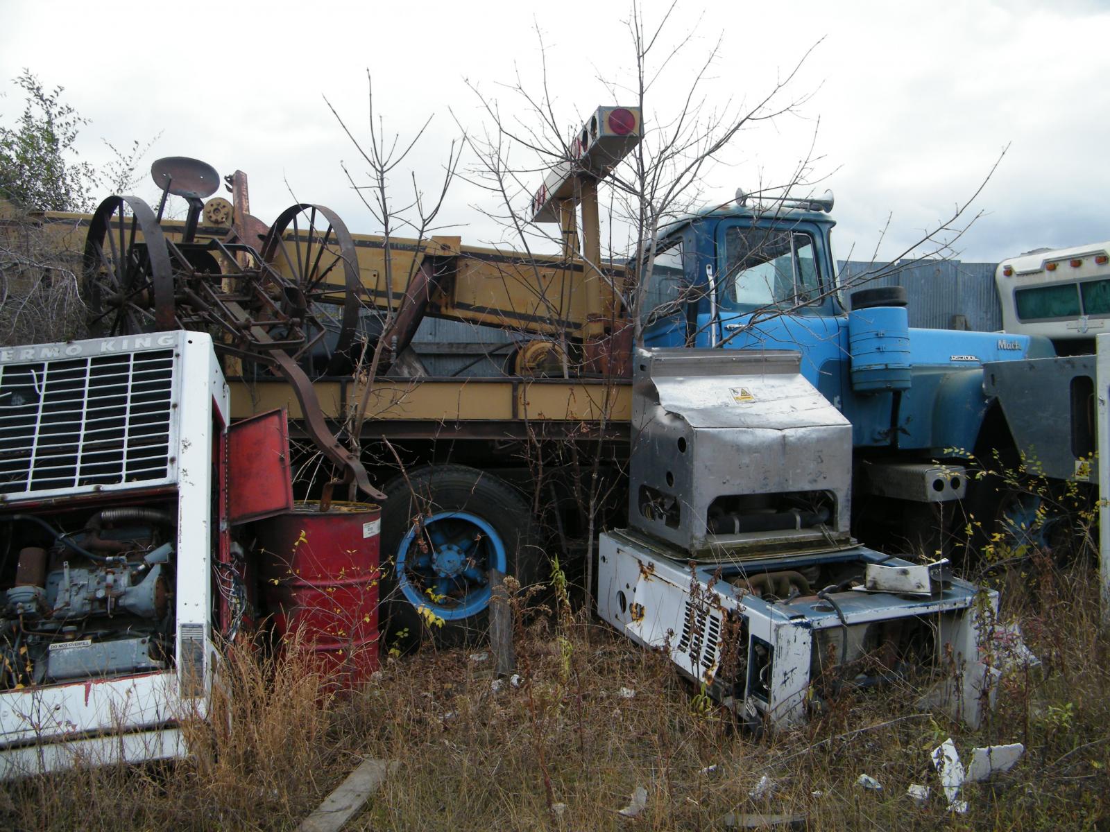

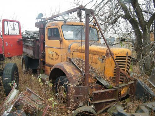

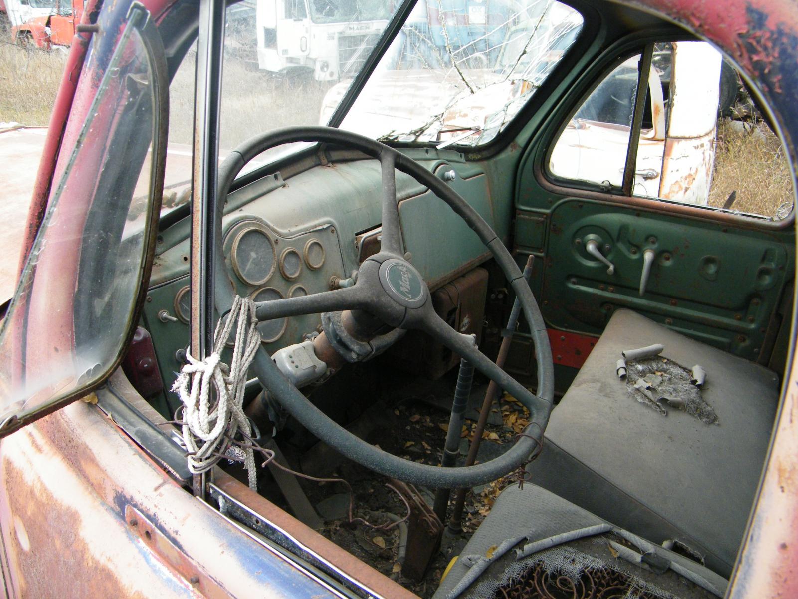

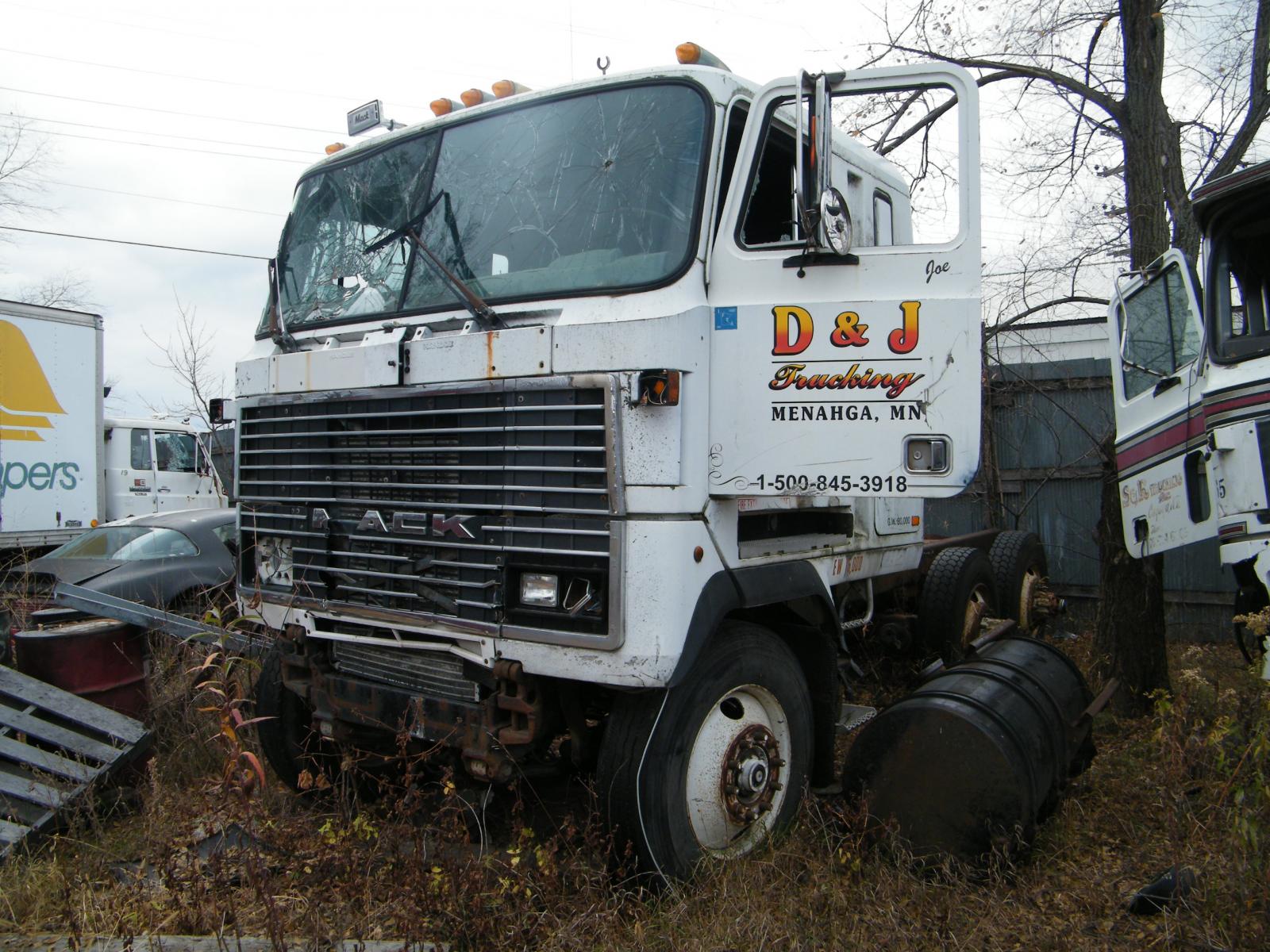

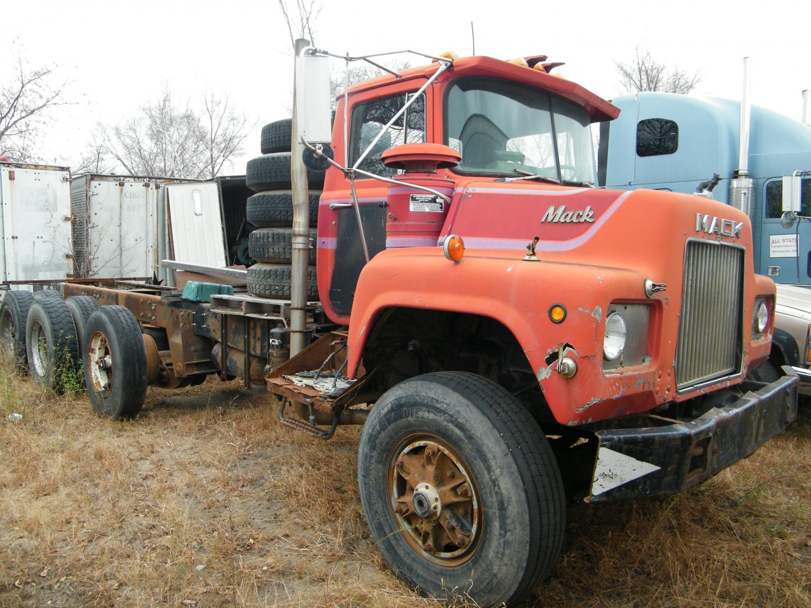

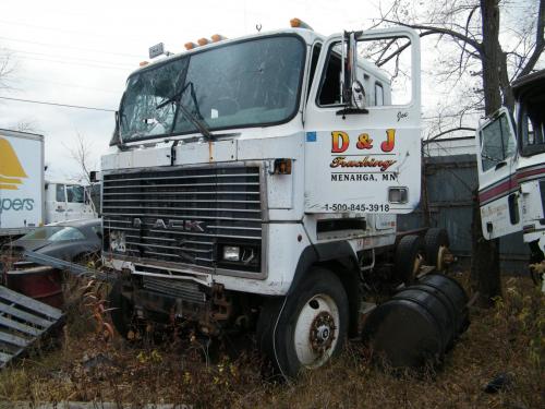

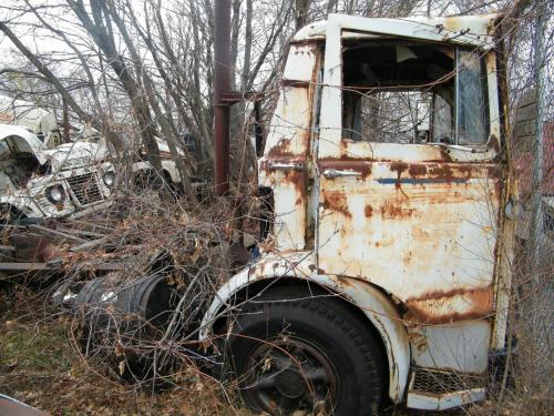

  18. The phone number I found for North West Diesel is (320) 252-6141. The phone number shown on the door of his blue Mack tow truck is very outdated as the area prefix changed several years ago. I dont know if he is willing to ship parts or not, but it couldnt hurt to call. Here are a few more photos, including a conventional cab International Emeryville:

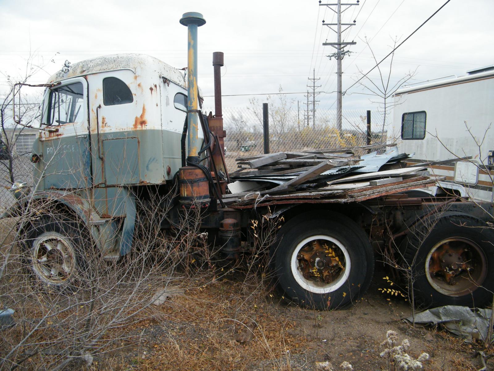

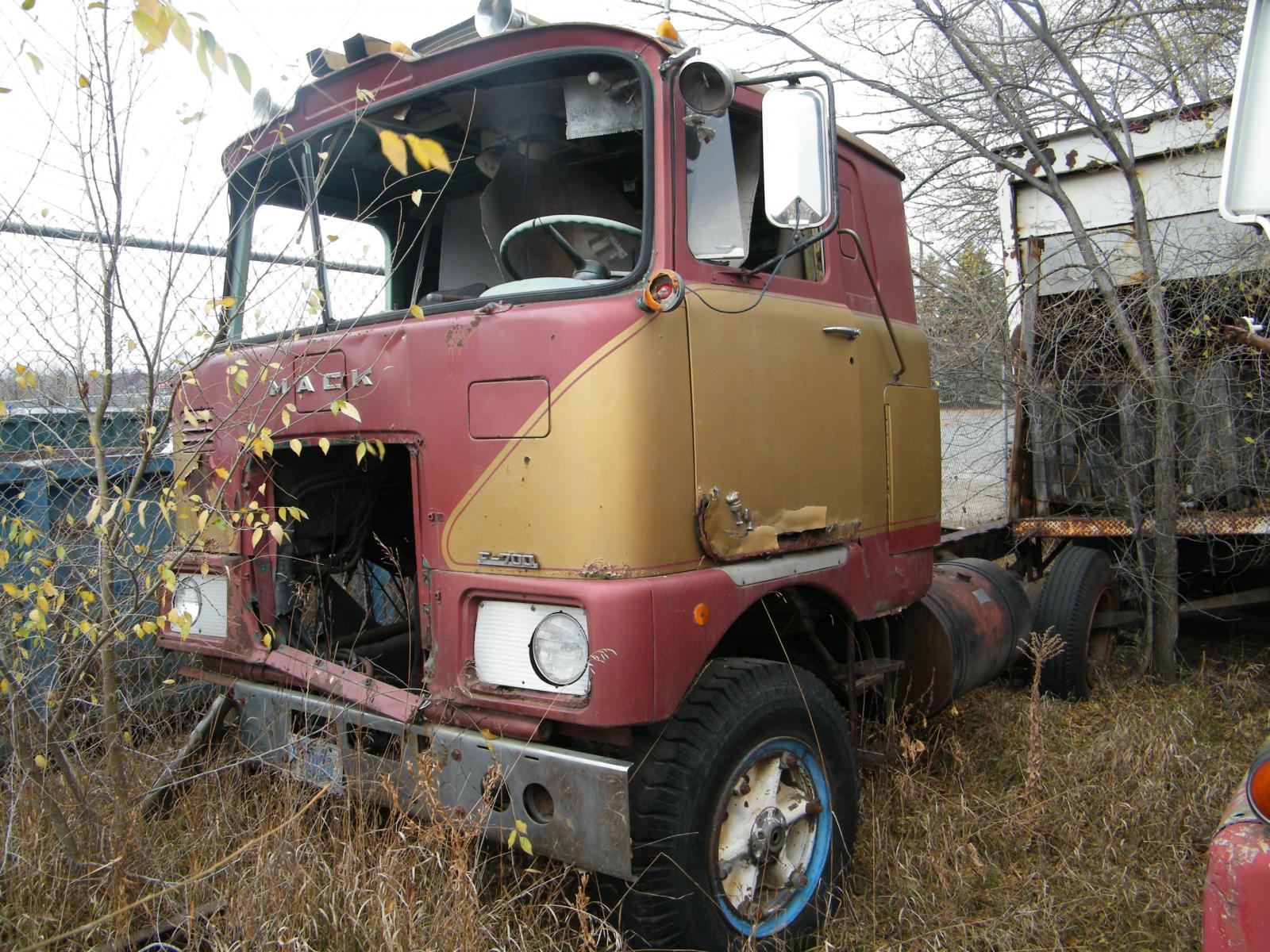

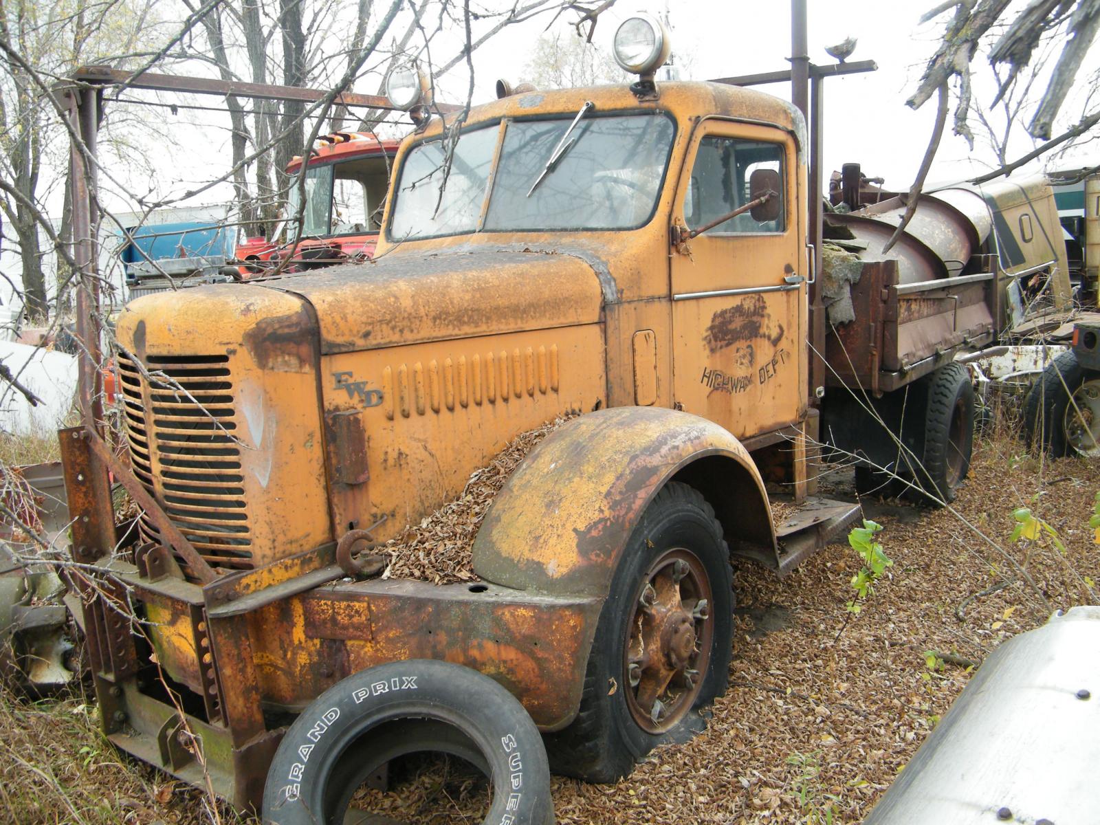

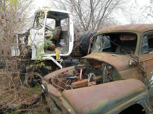

  19. A seldom seen model of International Harvestor and more Mack photos....

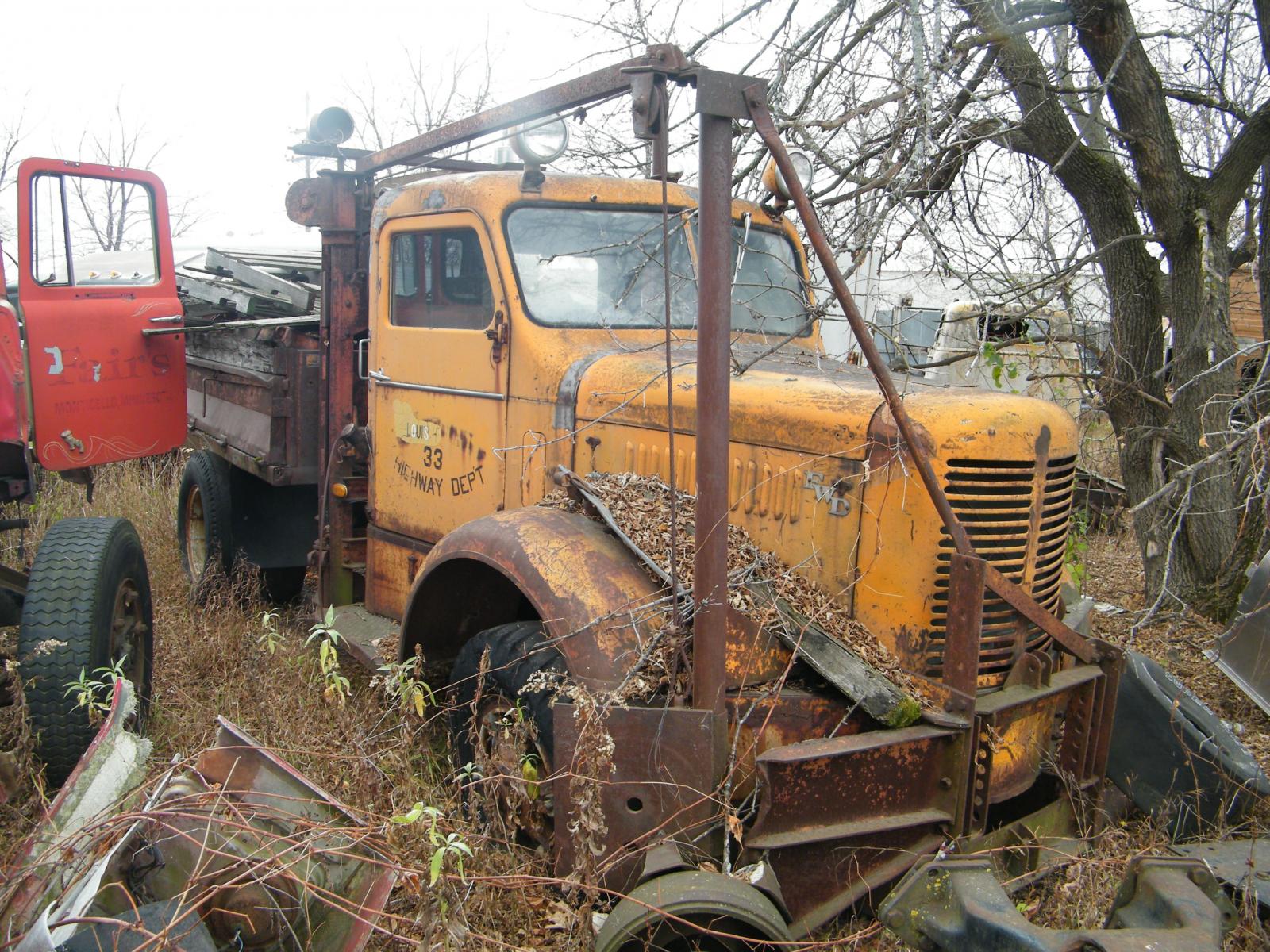

  20. More photos, including an FWD gravel truck. Any idea what year the truck is?

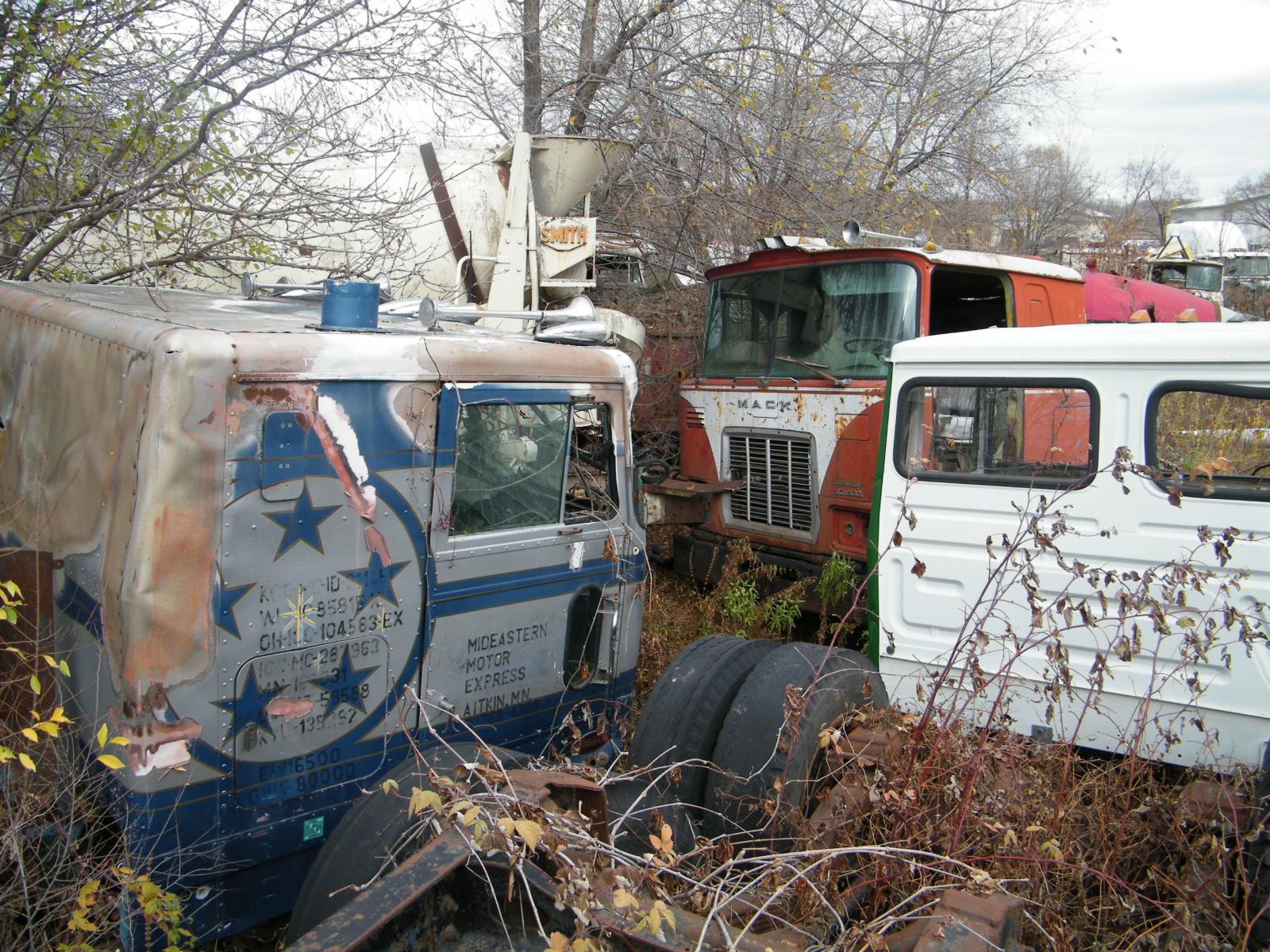

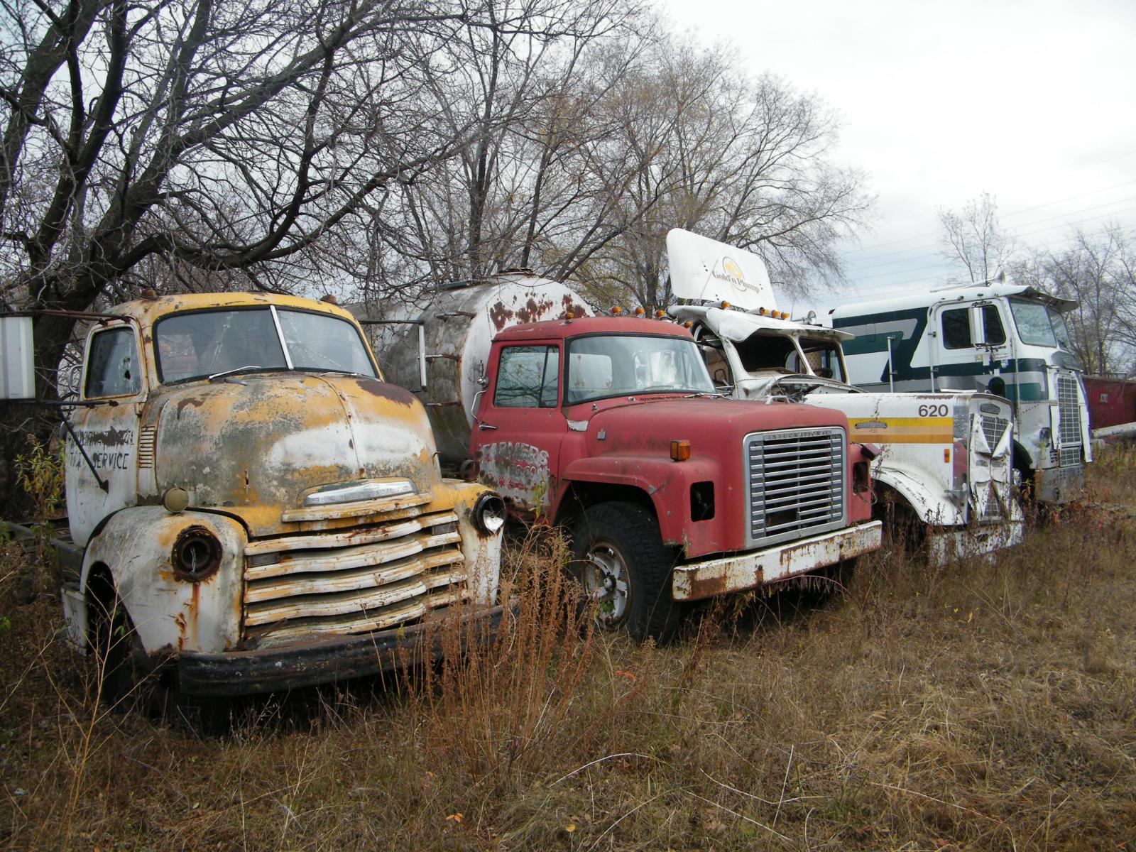

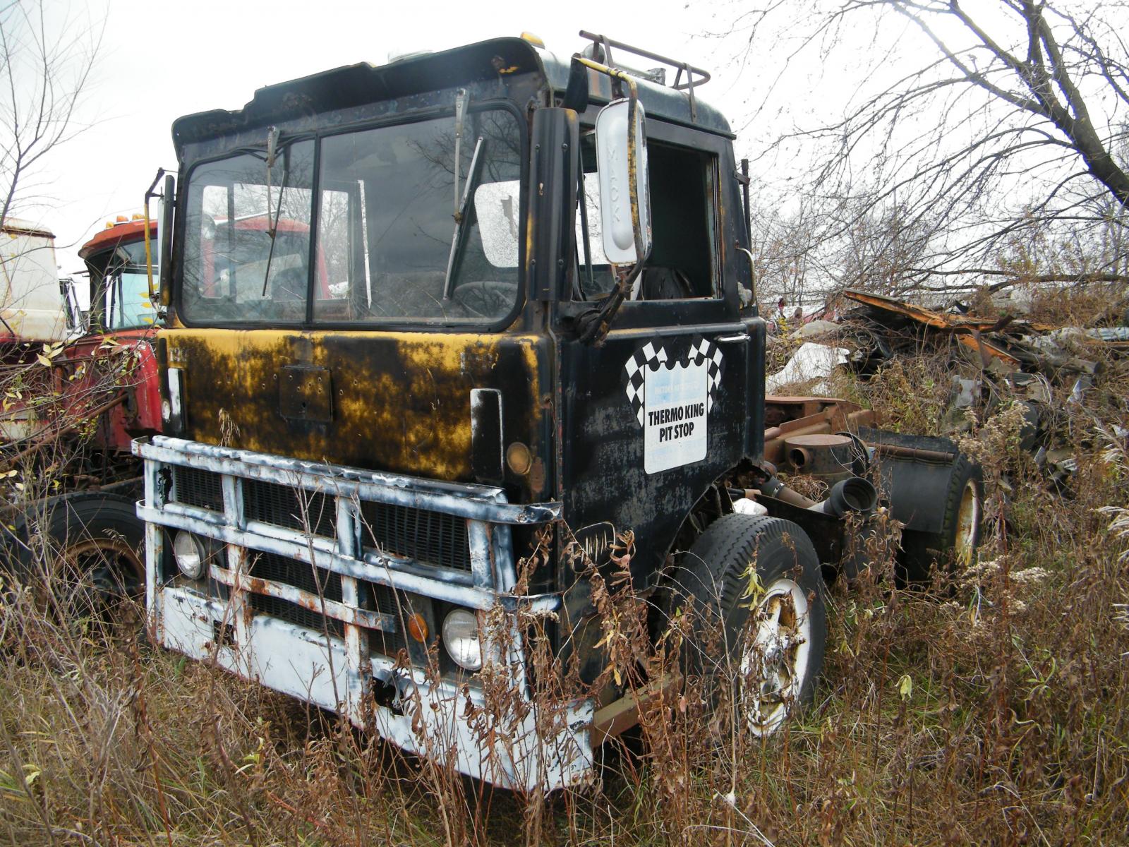

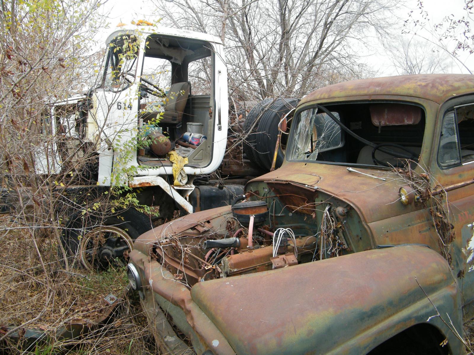

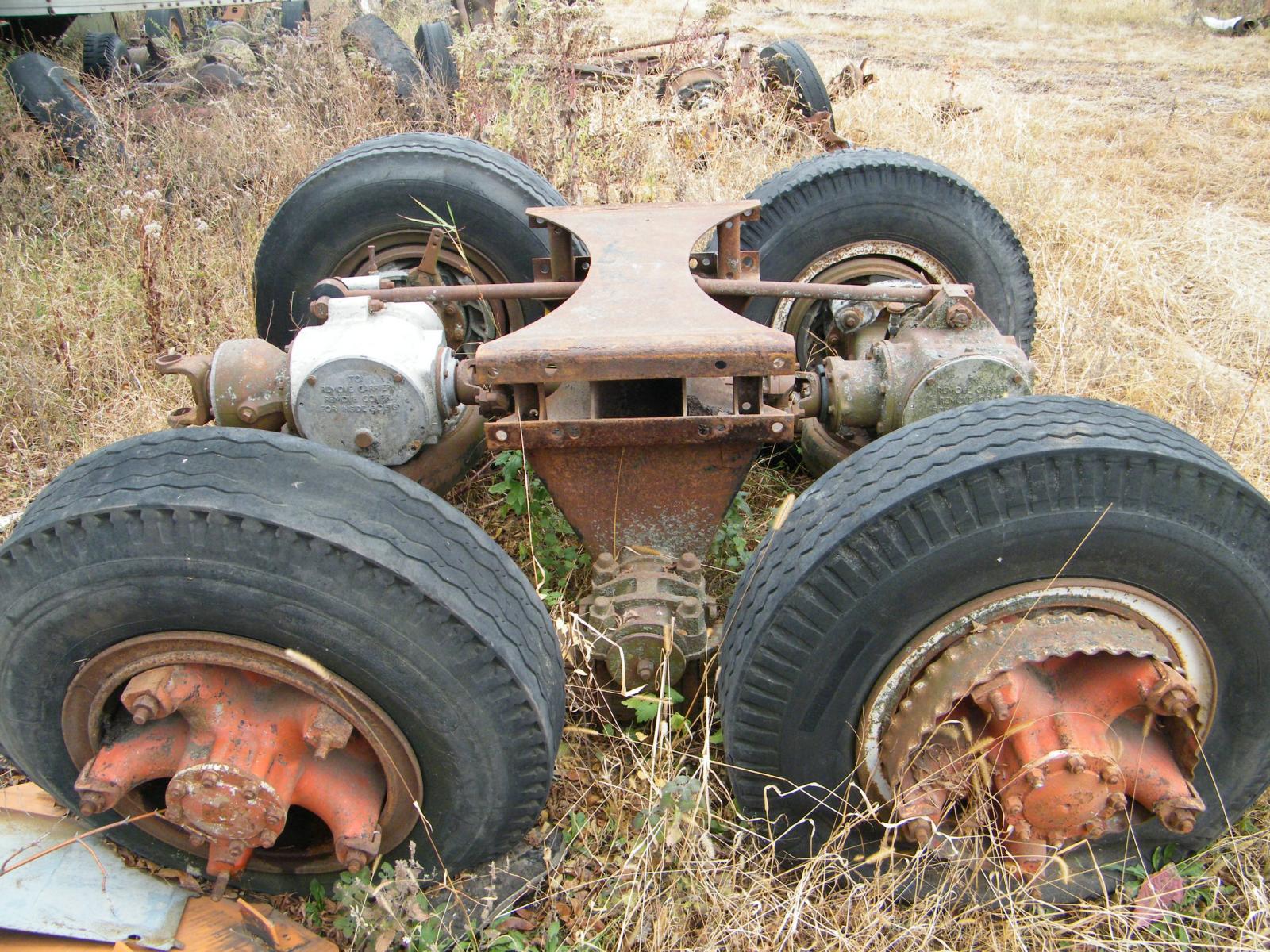

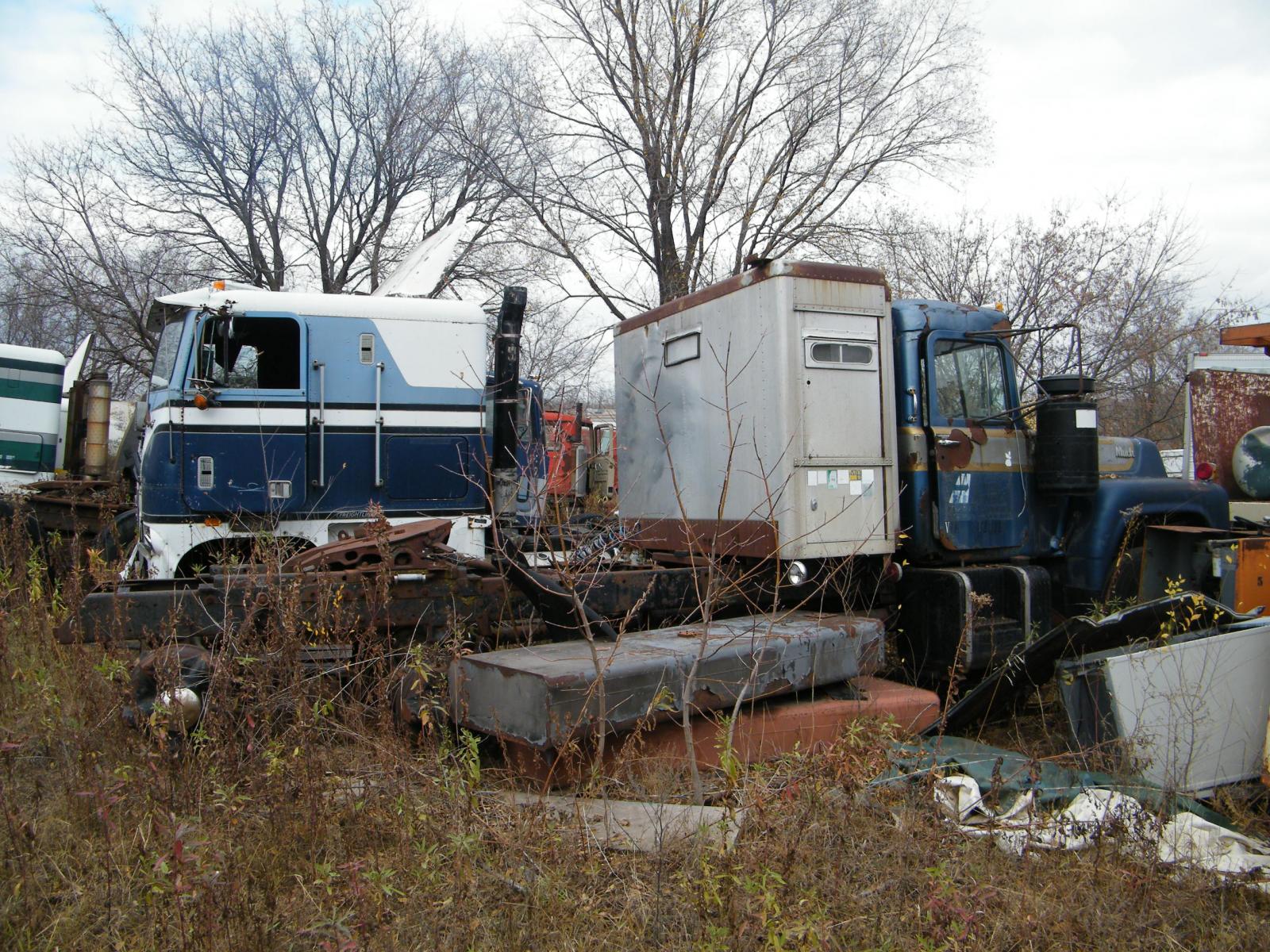

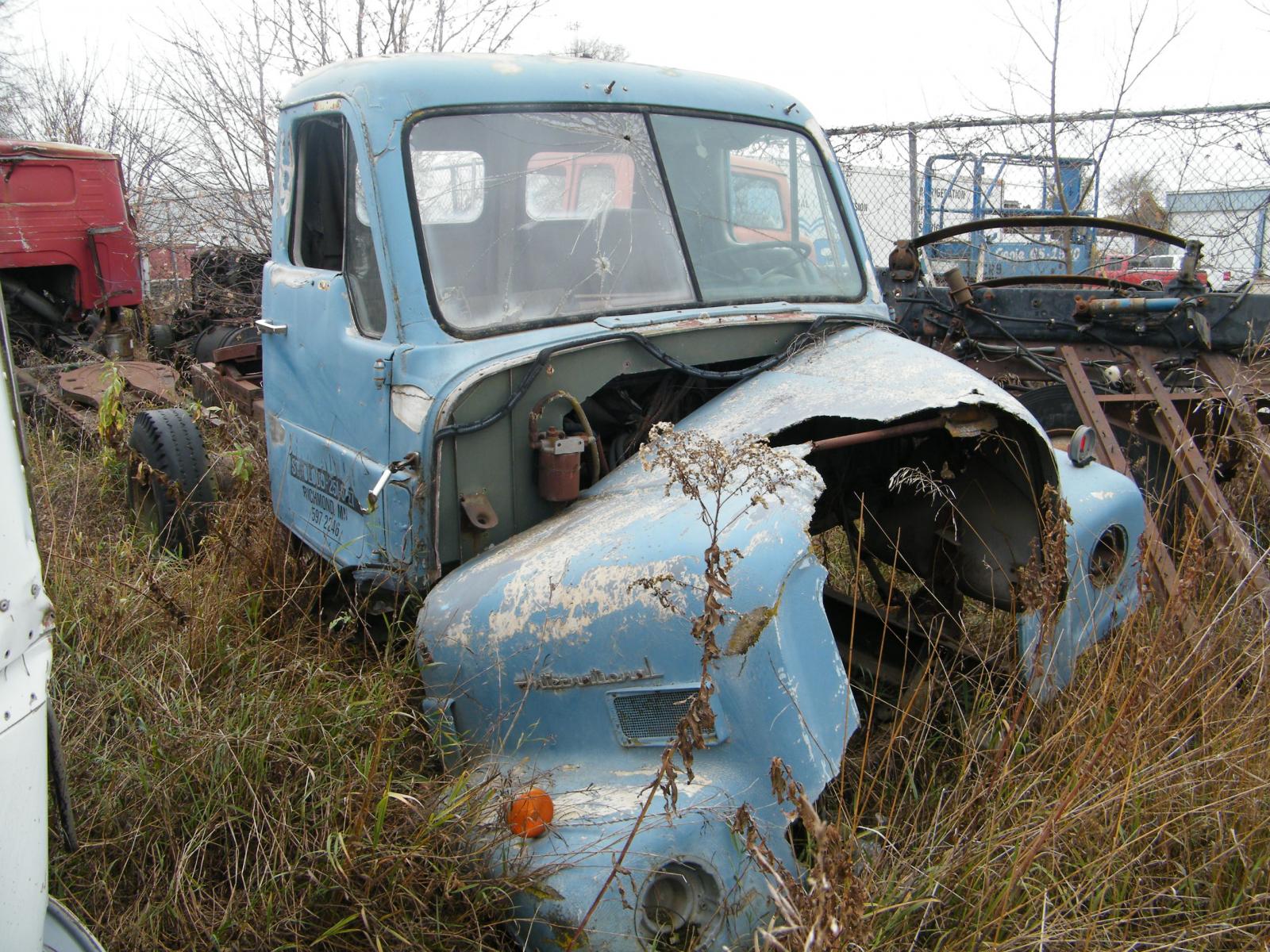

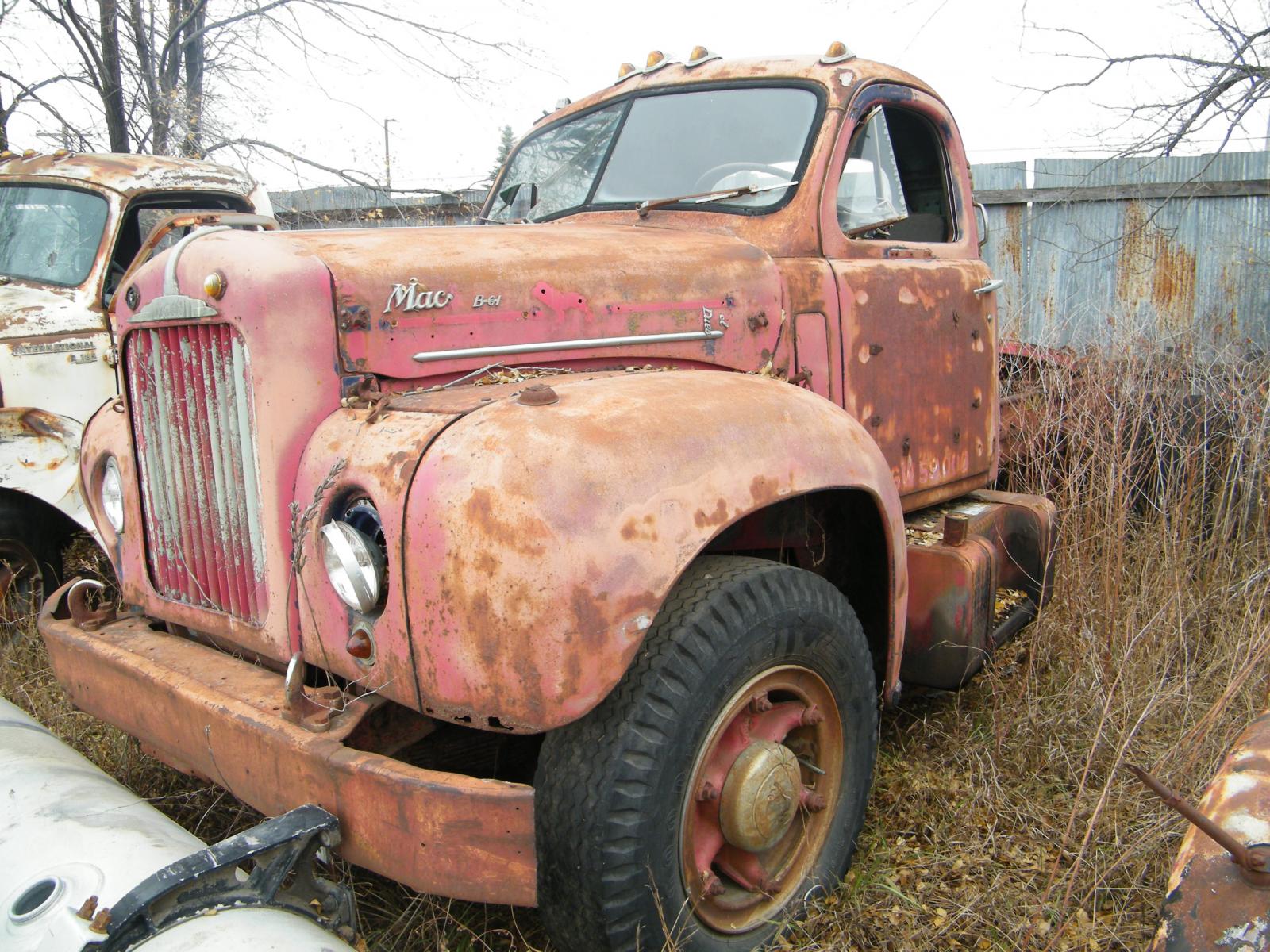

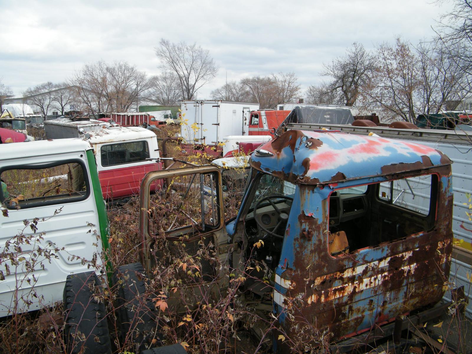

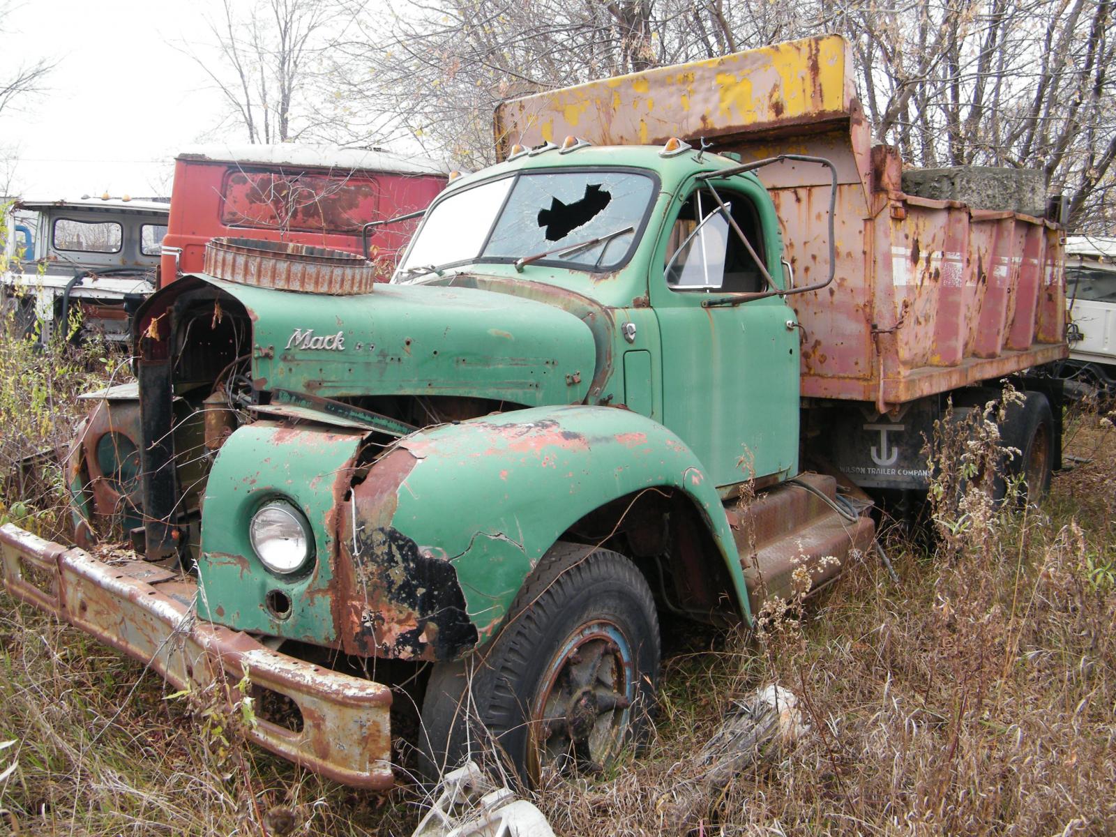

  21. I stopped in here today to get the brake treadle valve for my 1964 Mack C600 but he was in the process of repairing it so I will go back next week. Anyway, I took a self-guided tour of the yard and these are some of the photos I shot this afternoon.
