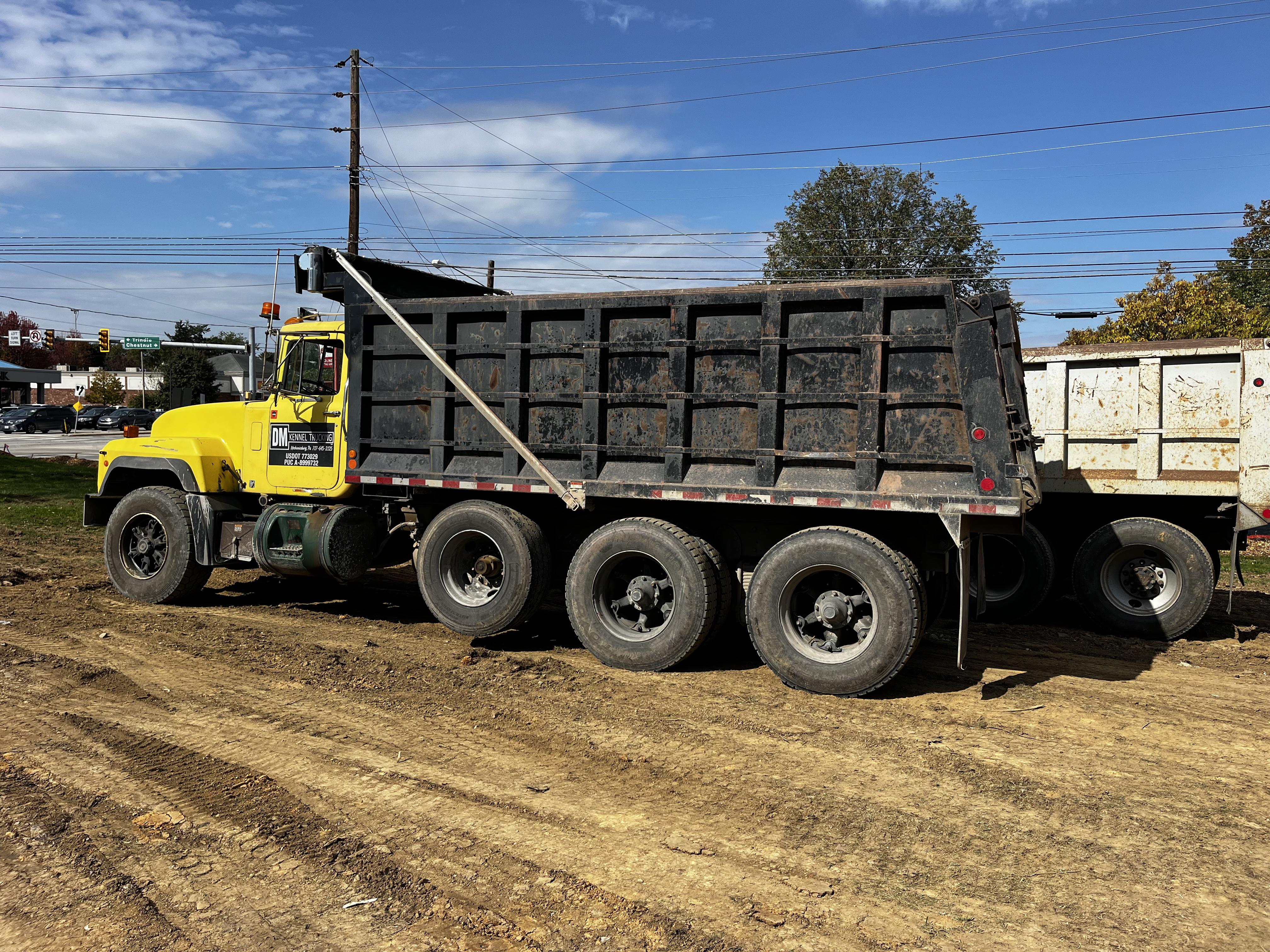

  8. I have a 1998 R model with the 58000 lb rears and would like to convert to hub pilot or stud pilot. I’ve been told they take special rims due to the larger hub/cone assembly can someone give me some information about this ? what would the correct rims be for this and could I run 24.5 tires ? I’ve hear it’s only for the 11r 24 set up
