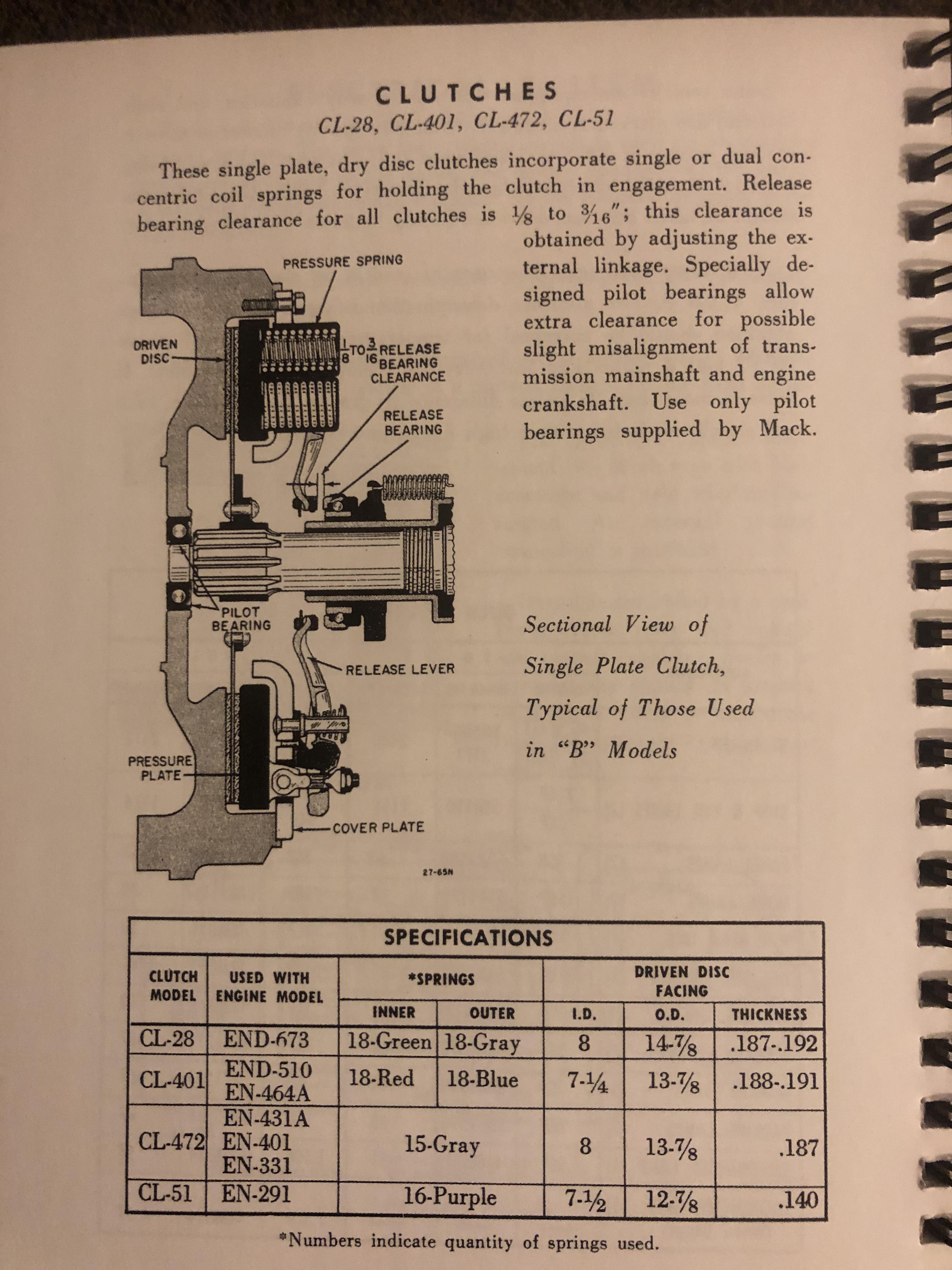

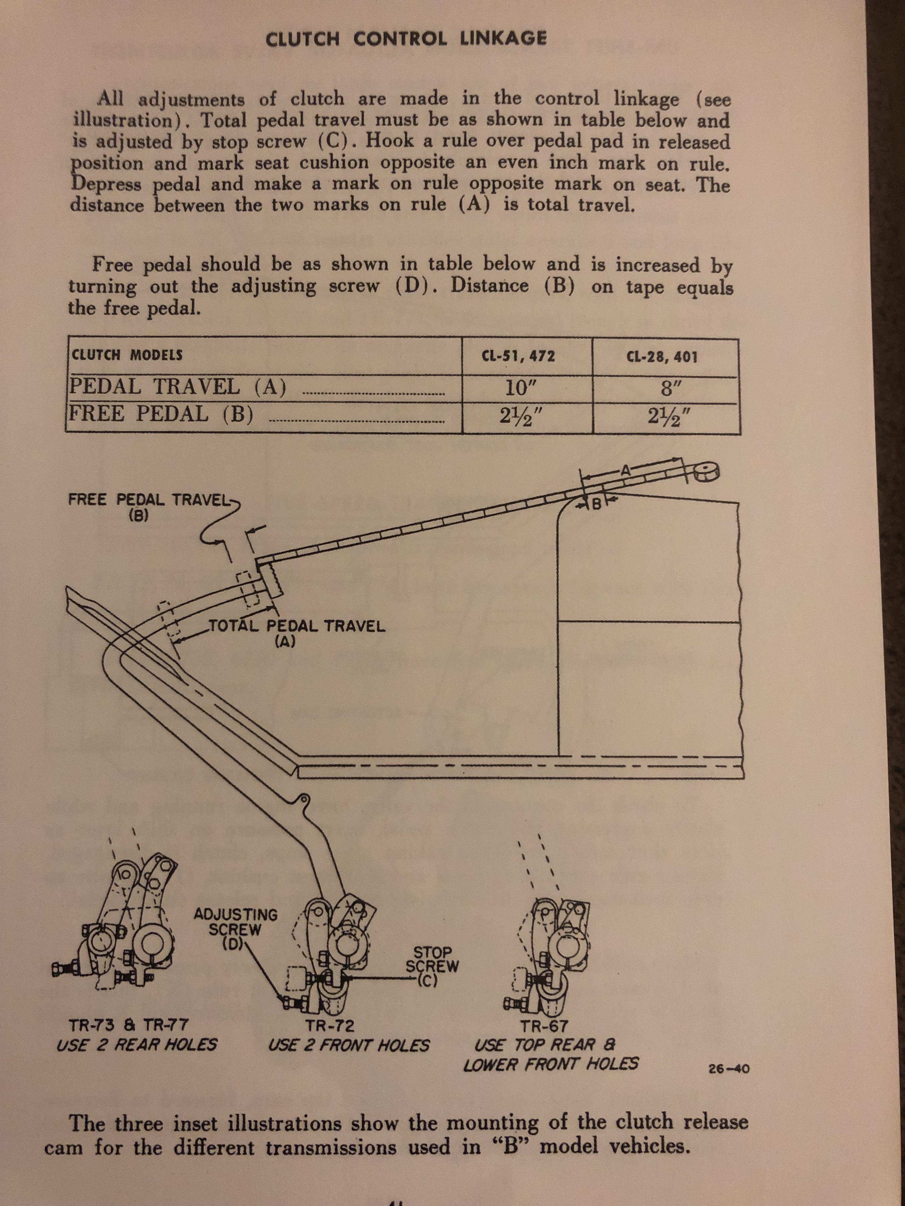

  1. Does the clutch have an internal adjustment that may not have been done? That or the throwout bearing sounds most likely. Doing what Bob said will eliminate the issue being the adjustment on the clutch brake. If doing what he said allows you to sit still, in gear, with the clutch in, then the clutch is releasing. If it tries to move with the clutch in, then the clutch is not releasing...for one reason or another. Gotta start somewhere...right?!

  22. I will try to find some instructions tonight in a couple of different books I have at home. If I can remember to look. I don't think there was any adjustment in the pressure plate. Seems like a cam plate and a threaded rod were the adjustment points. You wouldn't happen to know if this is a single or a double disc, would you? Double disc had shims under the pressure plate that had to be taken out to regain clearance as the plates wore. When a new set were put in, it was important to remember to put the shims back in.
