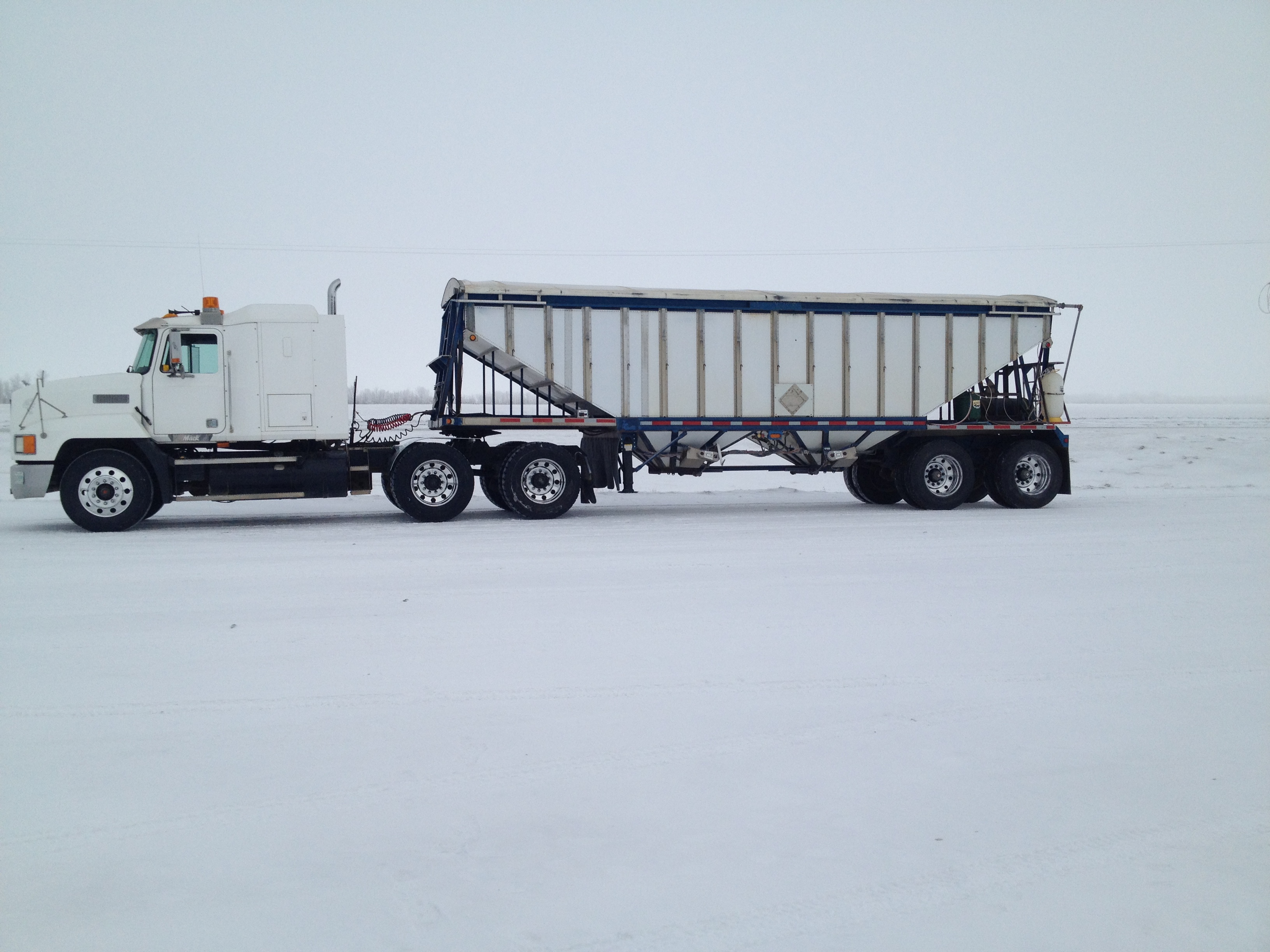

  8. Love the truck, is that a dog or a sheep under the tent?
