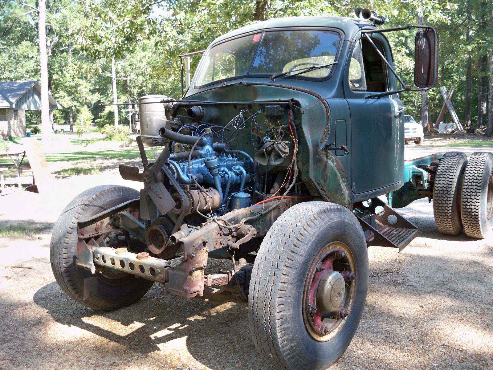

  7. The truck we are getting the engine and trans from was a B42 at one time. The front springs on it are not as heavy as the ones on the B42X we are fixing up. Doug

  10. We may mount a three speed brown lipe we have to use the overdrive for a little more speed. Not sure on that yet.

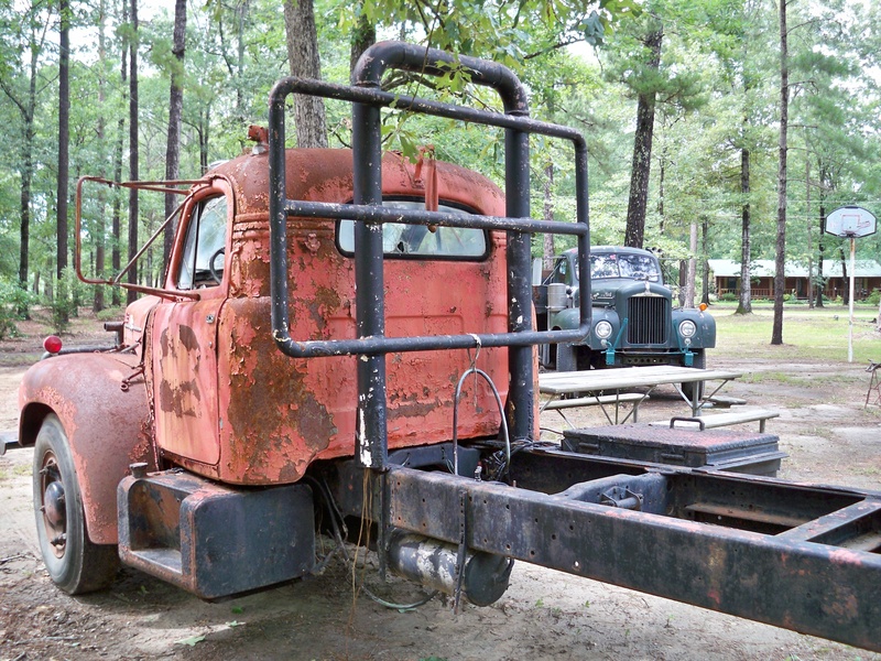

  11. We got all the mounts for the engine and trans out of the other truck. We have ran this engine but did not drive it. the rears was locked up so we had to pull the axel caps just to get it to roll. The old gasser was worn out bad. It left a cloud behind when you drove it. We traded for this little truck last fall. We live in central LA 50 miles south of Monroe. We hauled a John Deere 520 to NY and traded for the B 42. We left here Friday night and was back here Tuesday morning at five am. We had one night in a motel. That was a long trip.
  12. We just pulled the trans out of the doner truck this afternoon. I think we are going to pull the cab off the B 42 and then pull the old gasser and trans. My friend said he is going to clean and paint the frame while everything is out. He wants to replace the air lines as well. He works on Macks everyday but they are the modern ones. We both love the old trucks and tractors. We are in a antique and tractor club. That is the web site where you can see our toys I am the web master for that site. Doug www.latc.us
  13. We have removed the dump bed. We are going to use the truck to pull our antique tractors.
  14. We already got the front mount out. We are going to use the duplex from the other truck. We don't know at this time but we may mount a three speed brown lipe behind it so we can use the overdrive on it to get a little more speed. We have that also with everything to hook up the shift linkage.
  15. You can go to our web site www.latc.us then click on Photos then click on Bill Melders album and look near the bottom for a few more pictures. I will post more on that web site as we go along with it. I try to keep that site updated the best as I can. Doug
