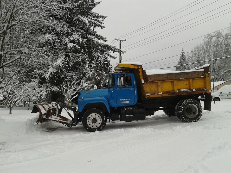

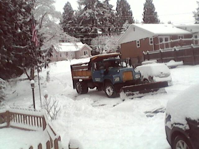

Progress on my 1980 R685
1951 Mack LJ replied to 1951 Mack LJ's topic in Antique and Classic Mack Trucks General Discussion
So is the brake lights on when parked just a Mack thing? None of my other brand trucks were like this. As far as the box I am thinking about painting it grey. -
Thanks for all the compliments. I do plan on working this truck. Actually have the first job for it this weekend. I figured out that the brake lights work correctly once the park brake is released. I have never seen a truck do this. I am starting to think maybe someone had wired it up to have the brake lights on every time they set the brakes with the truck running for extra safety. It was a snow plow truck originally. -
