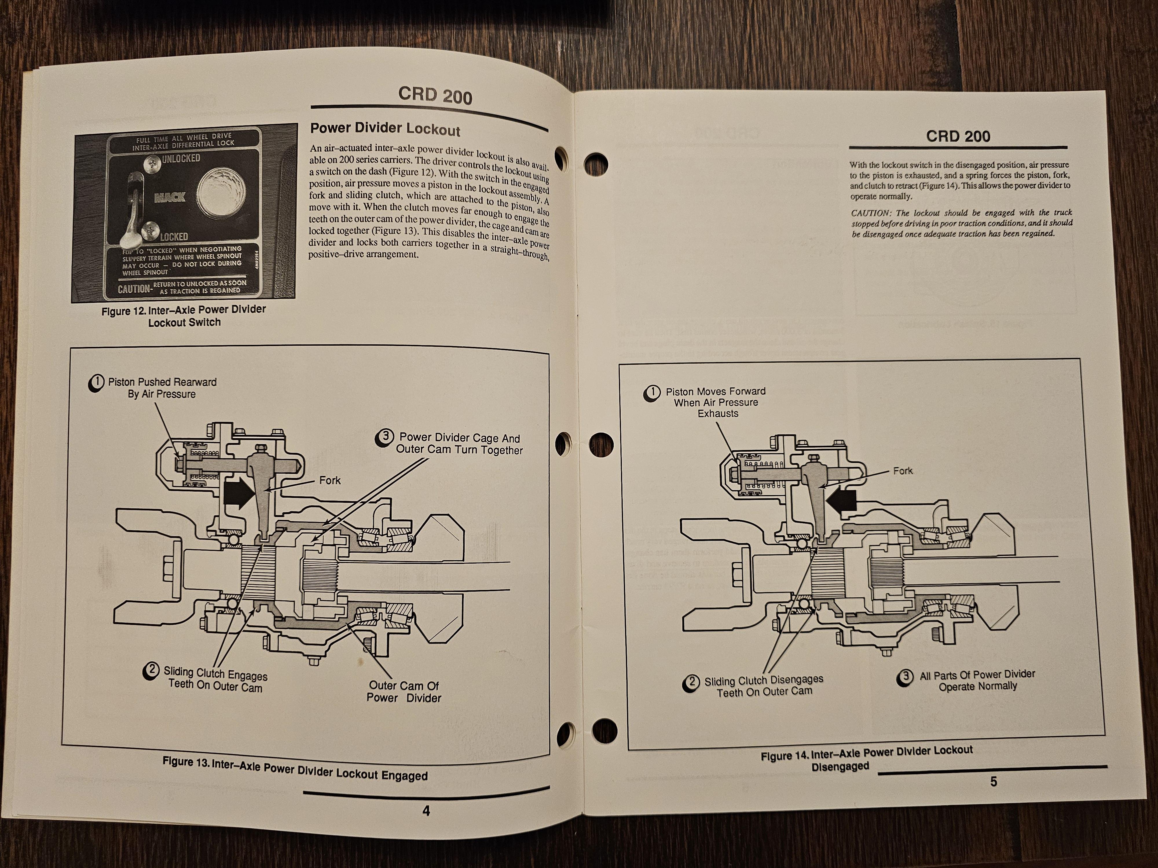

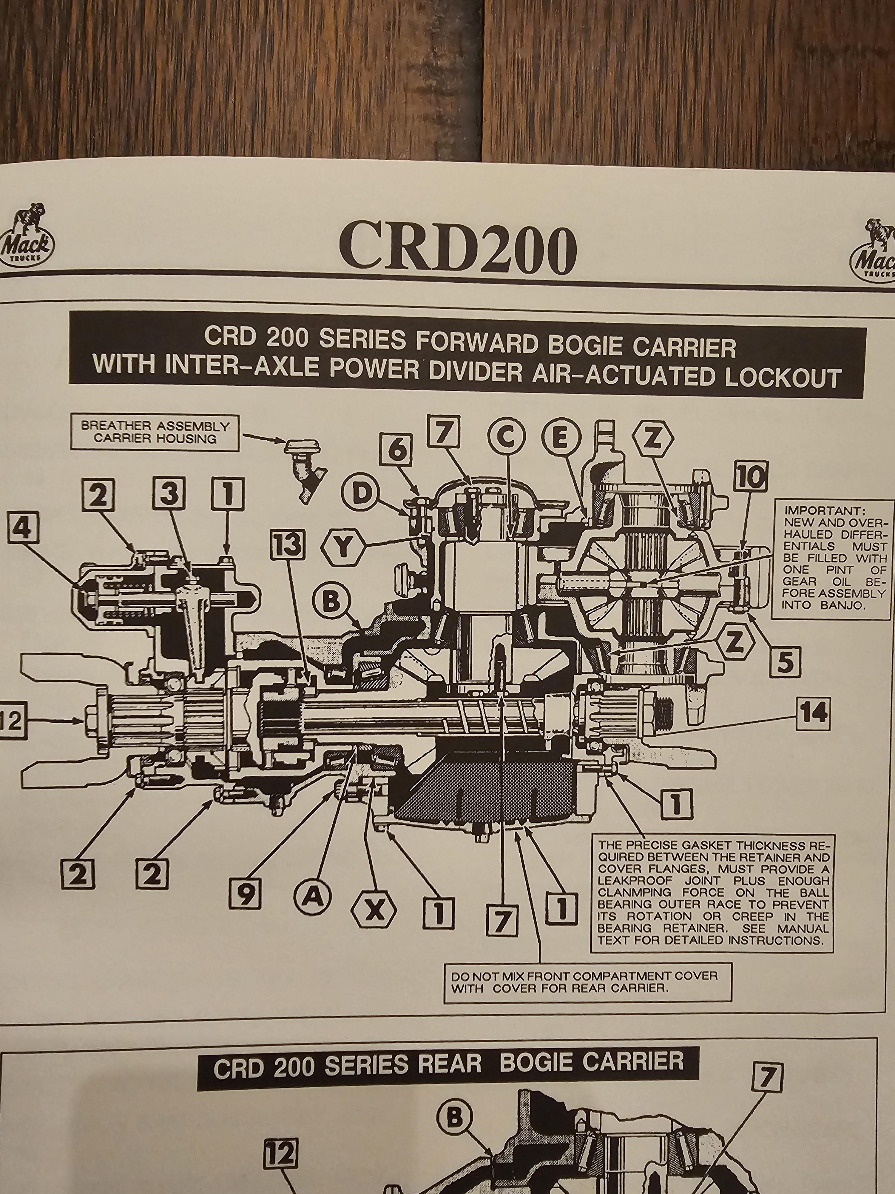

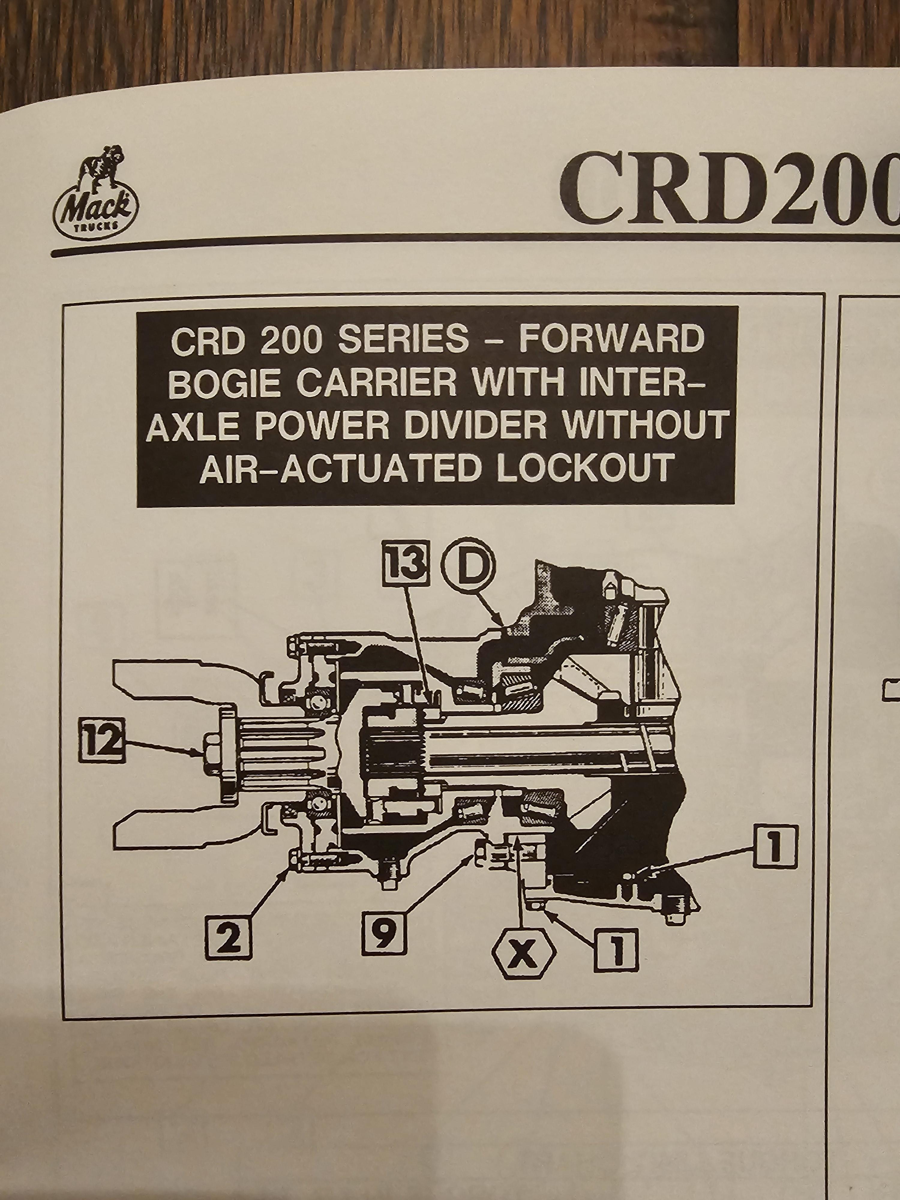

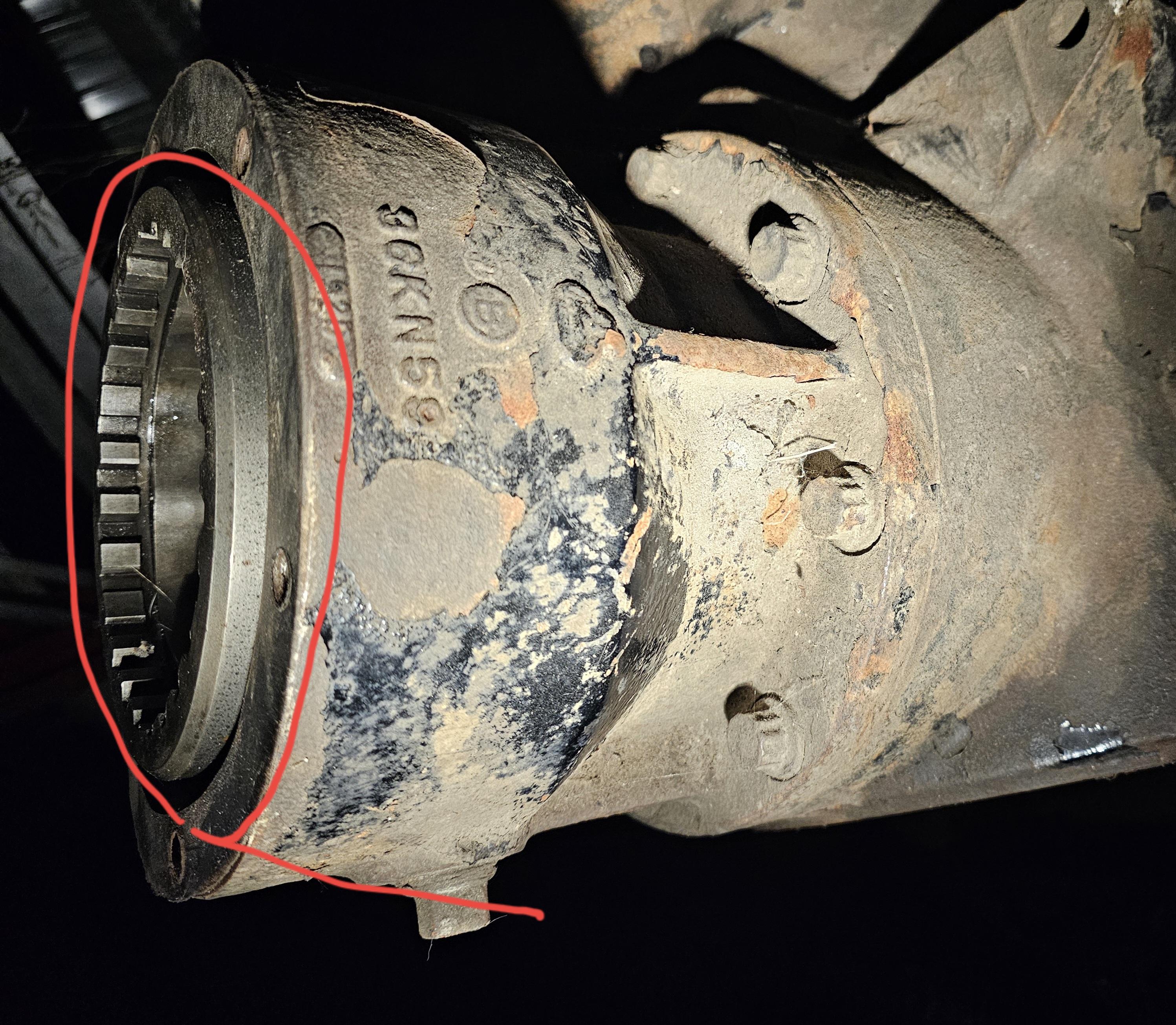

I beleive so. The power divider housing is longer on the front end. The rear is the same and the splines in the cam drum should also be the same.  The drive shaft will need to be shortened,  but thats a small price for what you will gain with a locking power divider.
