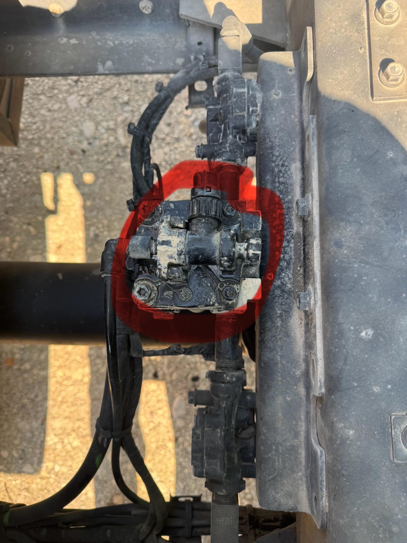

I’m having this relay value leaking air from the bottom ( picture attached). Checked the valve with Mack dealer is around $600. Does anyone had experience with this issues? I saw one guy on YouTube saying replace the quick release valve first…. My truck is 2016 CXU613 . Thanks much.

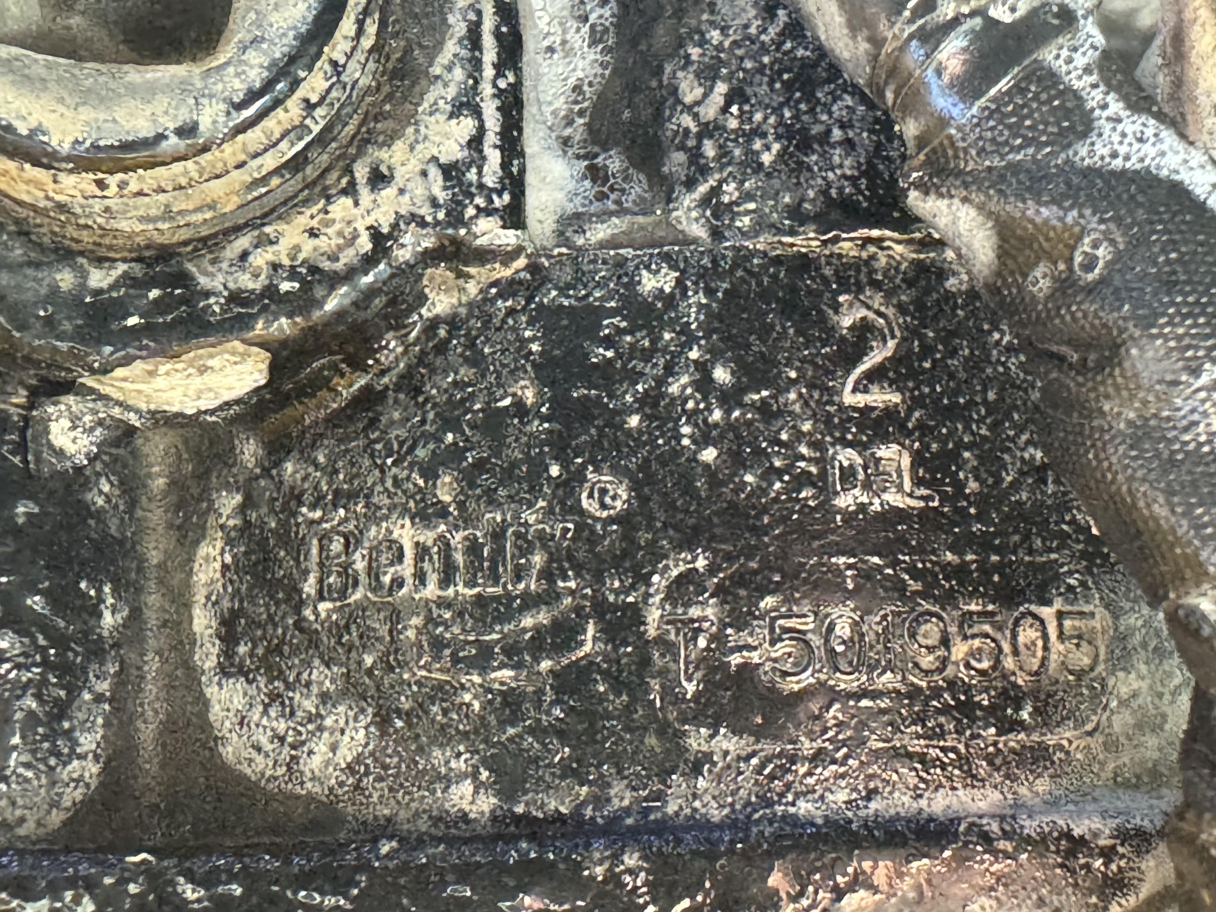

Is the data tag still on the valve? You may just have to remove it to I.D. it. Mechohaulic makes a good suggestion. At $600.00 i would take it apart and inspect it and clean it, and try to rebuild it. Is the air system Bendix or Wabco?

thanks for picture helps alot. but with all the electronic wires tied to it  can't see the sides. if it's the service brake relay valve = the large line in front (green) is supply; 3/8 line on top is line  from treadle/trolly which activates the valve; and there should be two more lines - one on each side going to brake chambers. inside plunger could be dry and sticking or bottom discharge valve has hole in diaphragm

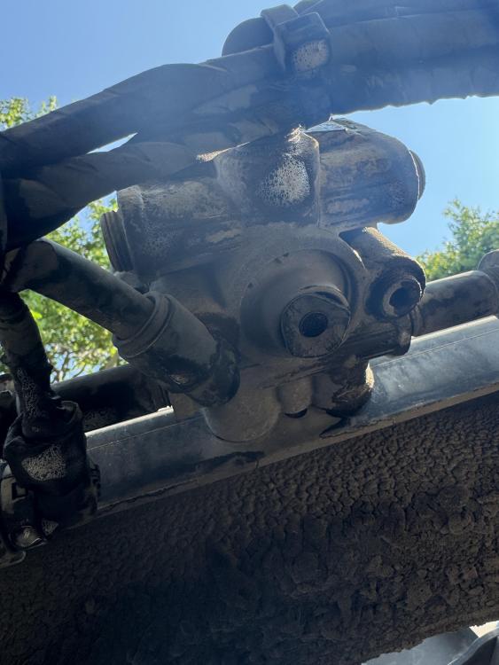

The big "green" line closest to the camera should be supply. The 3/8" line near the top should be signal. It would appear the valve has 4 outlet ports, two on the side and 2 on the bottom. In the picture one of the bottom ports is plugged and it looks like the line I asked about goes into the other bottom outlet port.

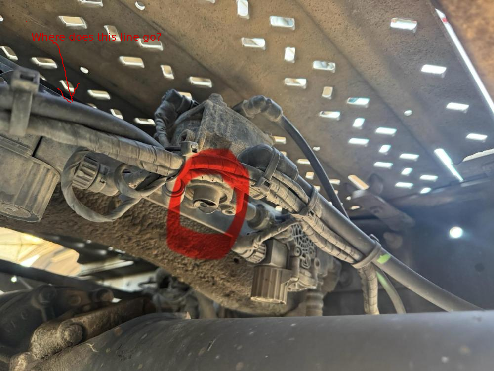

Without knowing where the other line on the valve goes, I can't say what it could leak back. Might be inversion valve or anti-compounding.
