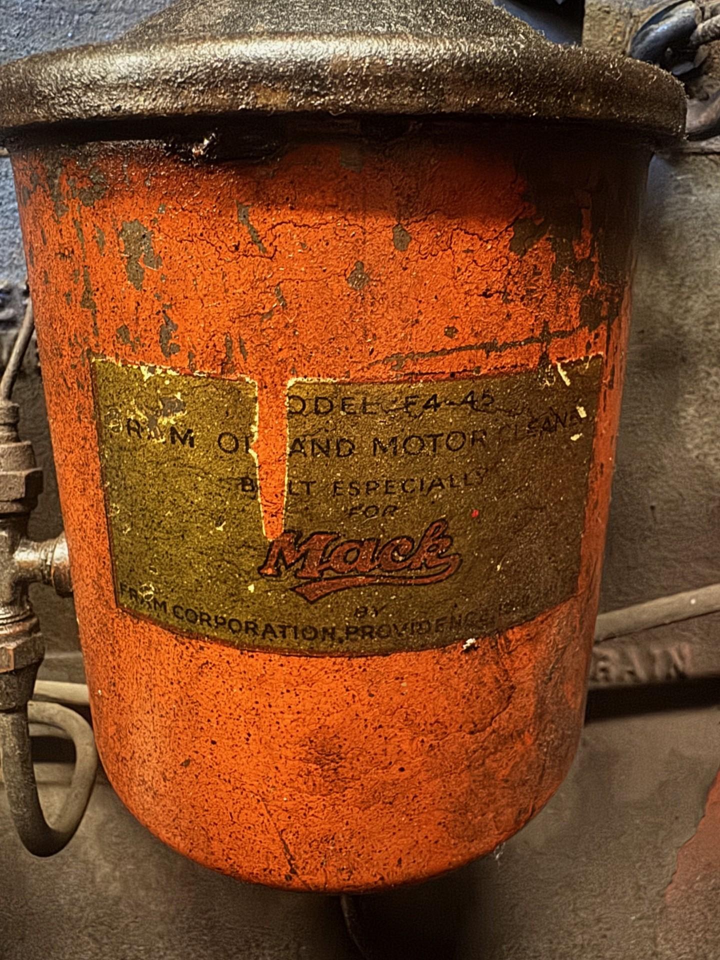

Does anyone know what filter cartridge fits in the engine oil filter on a 1949 Mack type-45 fire engine (Continental ENF-330)? The filter housing sticker is still partially readable, i think it says model F4-45, built by FRAM for Mack, but my searches for that have not yielded definitive results.
Pete

F-4 is the housing number, cross to (old) NAPA number 1006 for the element.
DIM:
ht: 5.007"
OD: 4.094
Gasket number: 5017 (old NAPA)
DIM:
OD: 4.736
thickness: .062
Check those against what you have.
Cartridge lube metal case filter.
