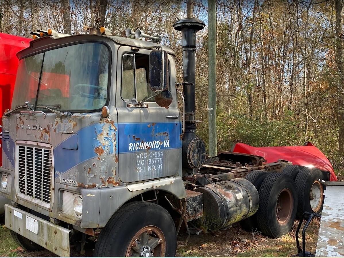

Hello all,
I am restoring a 1975 F Model Daycab and having a headache with parts availability for the front 4 inch brake shoes.  The truck has 16.5 inch Dayton Rims and the original brake shoes were the old "P-style" shoes that have a ring at one end.  Watts Mack said the shoes are no longer available from Mack.  Aftermarket Meritor Part Number is 4549P.  I was able to obtain 3 shoes from Haladex but it appears that the 4 inch linings needed to remanufacture the shoes are out of production and not available anymore.  Obviously, I need 4 shoes to complete the job.  I do have 1 newly remanufactured Q style shoe with the open hook at the end, Part Number 4549Q but it takes a different anchor pin and I am worried about mixing different shoes on the same axle.  The 4'' Q style shoes also seem to be out of production.
I need to get this truck back on the road so I can continue the restoration.  Has anyone encountered this issue or have any of these old P style shoes that I can buy?  Any technical expertise in this area on whether it is okay to mix the P style and Q style on the same axle?
Appreciate any help!
Mike
