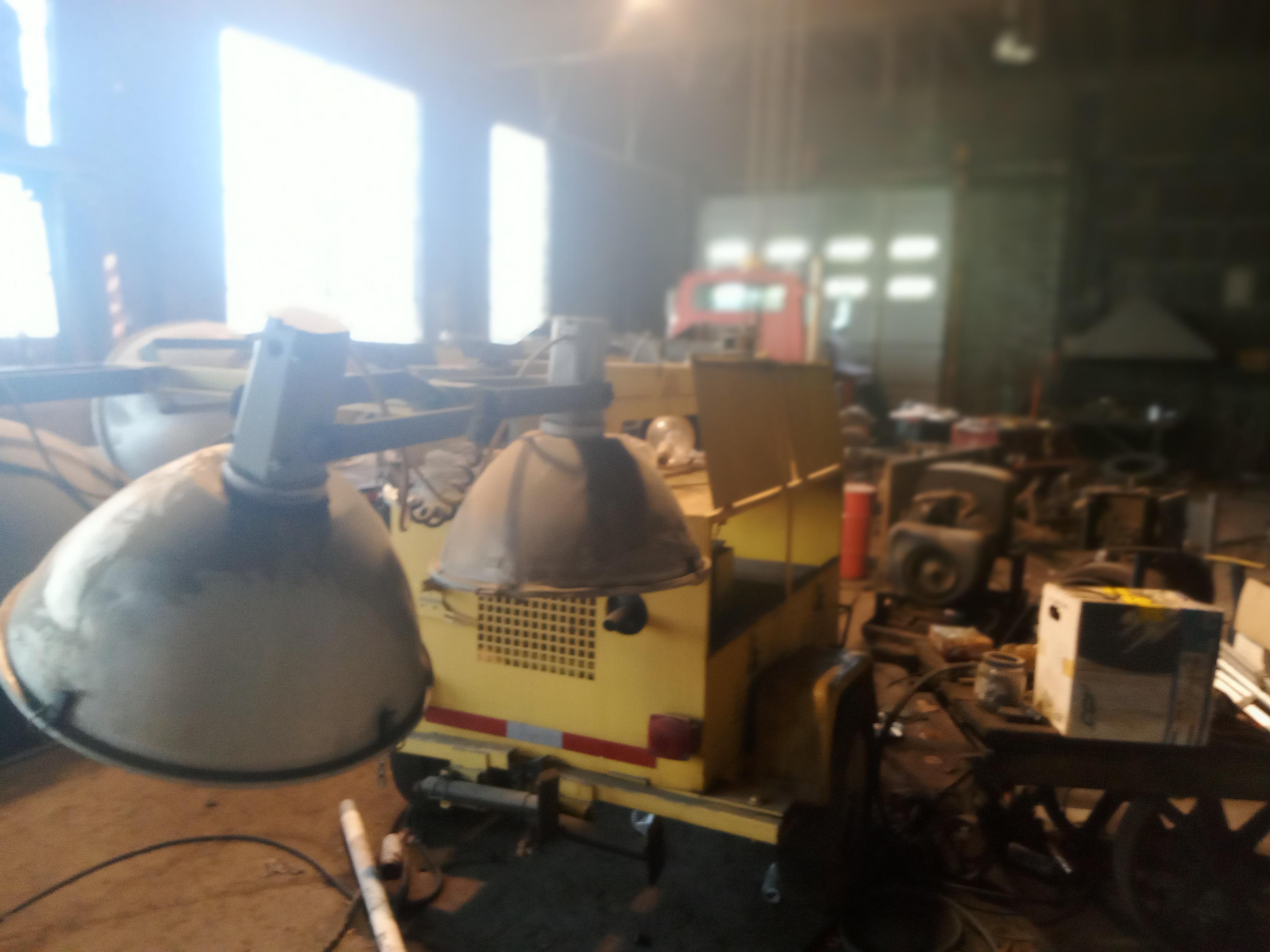

I think those are about 14ish HP at 1800, so they probably oversized the engine a bit. Those things can rack up lots of hours so they probably sized t to not be working so hard.
I have the same one on a light tower. I have one bad bulb, I was just going to buy 4 LEDs for it. Probably won't be working anywhere near hard then.

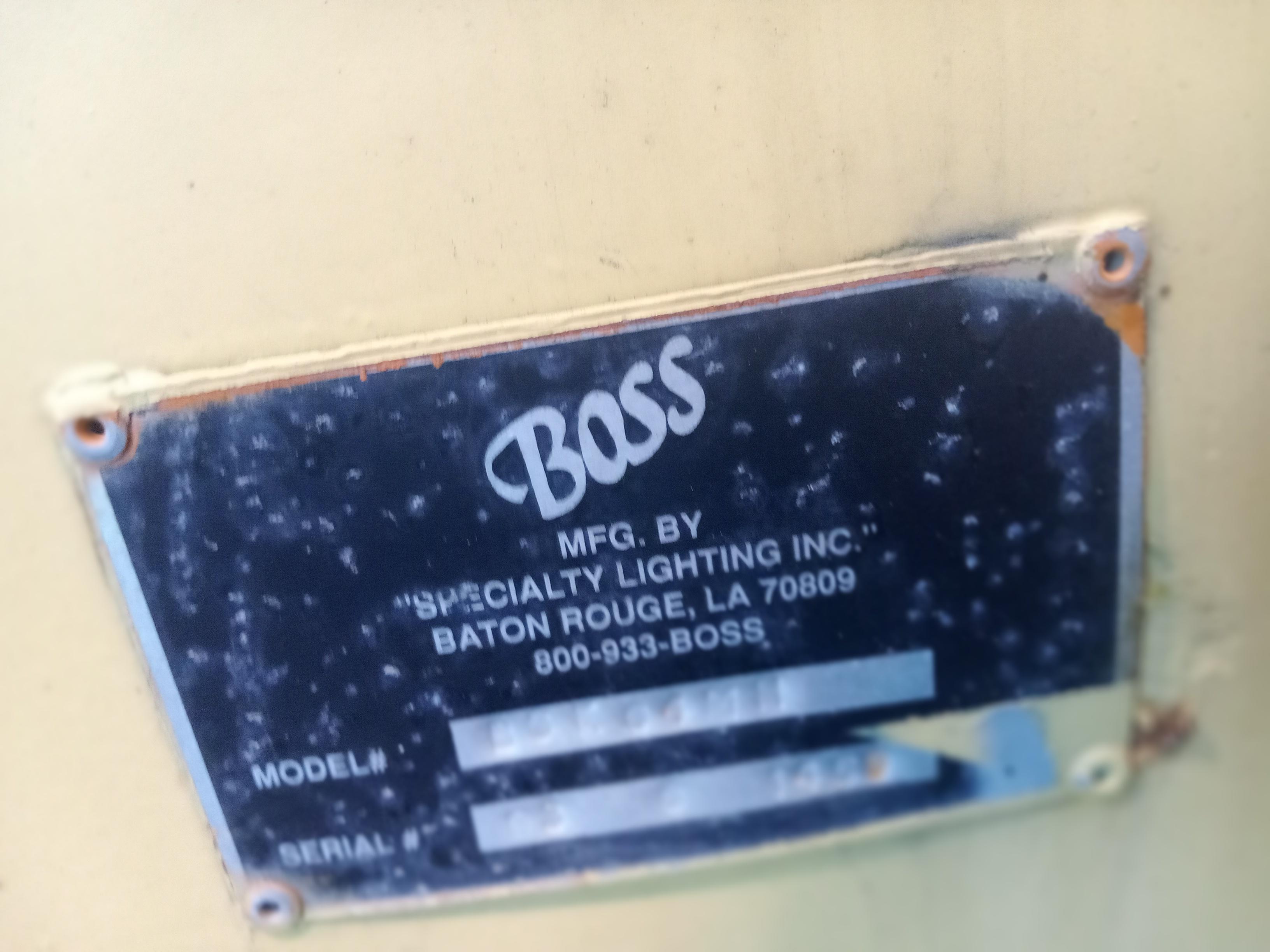

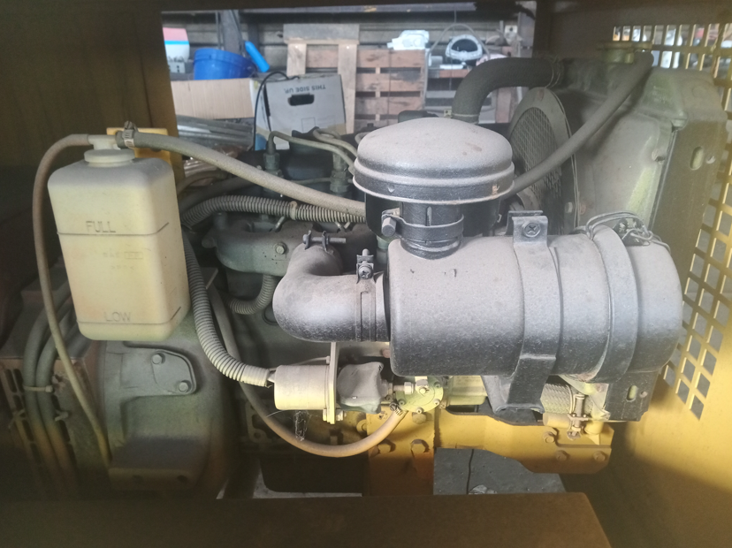

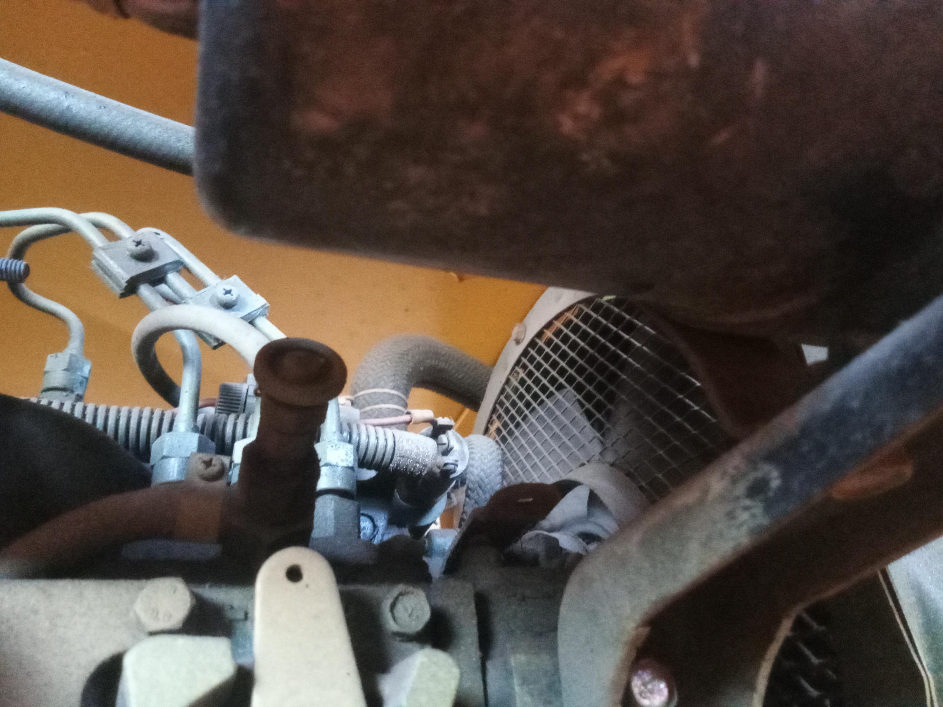

This one say "Boss" on the manufacturers tag. I'll turn the garage lights on and get a better picture of the air cleaner. It puts out a lot of light, I would think I could add more lights if I switch to LEDs

I don't need a better picture, but thanks.

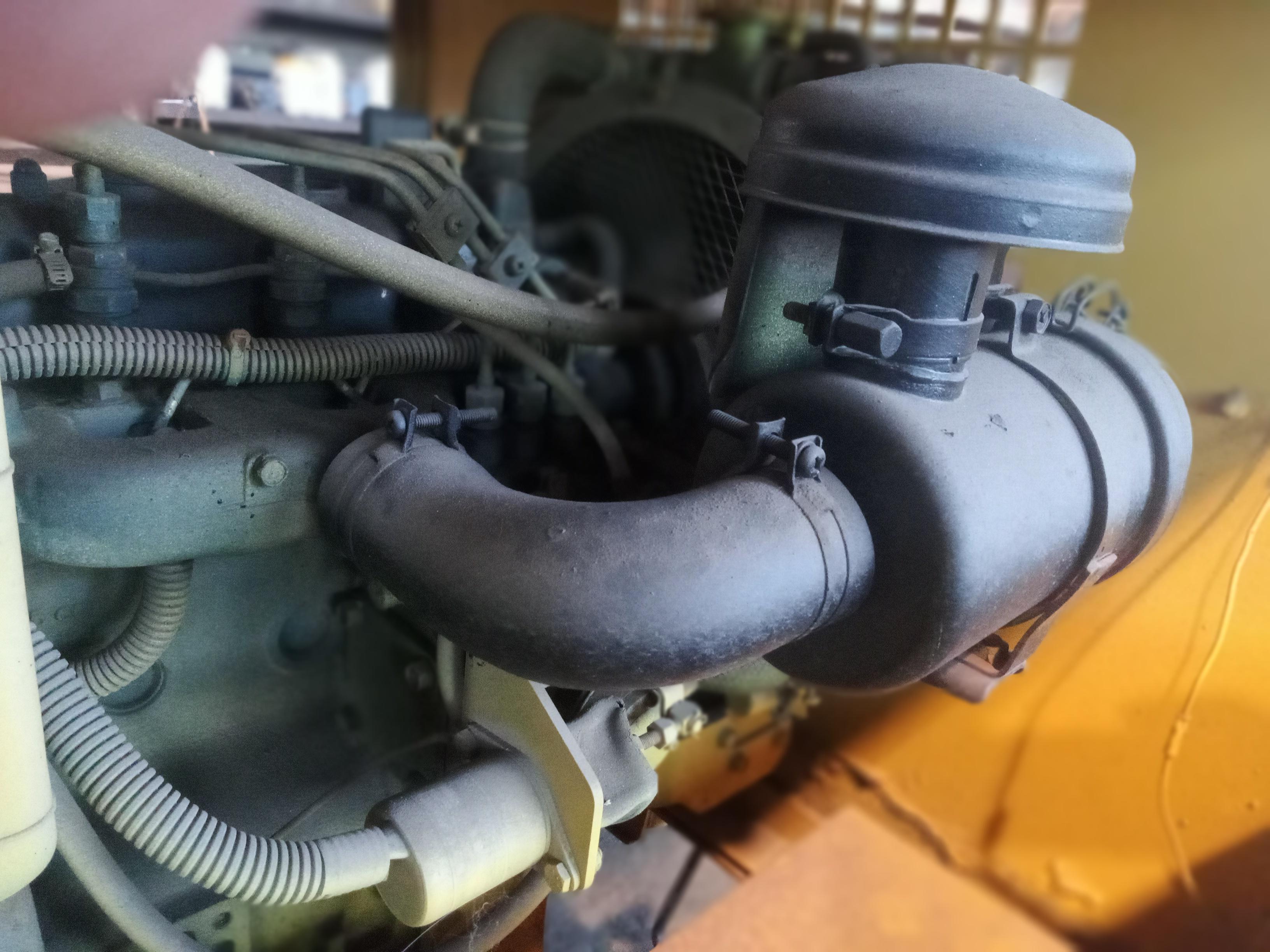

On mine he had flipped the aircleaner around and bolted it with one bolt to the bellhousing where the timing hole cover was. I can see it bolts in front of and below the I/P where there are two hole that just happen to match the bracket for the air cleaner, imagine that?
It seams like anyone and everyone with a small shop was producing these back then. Now the big players bought out the little guys and there are only a few producers still in the game.

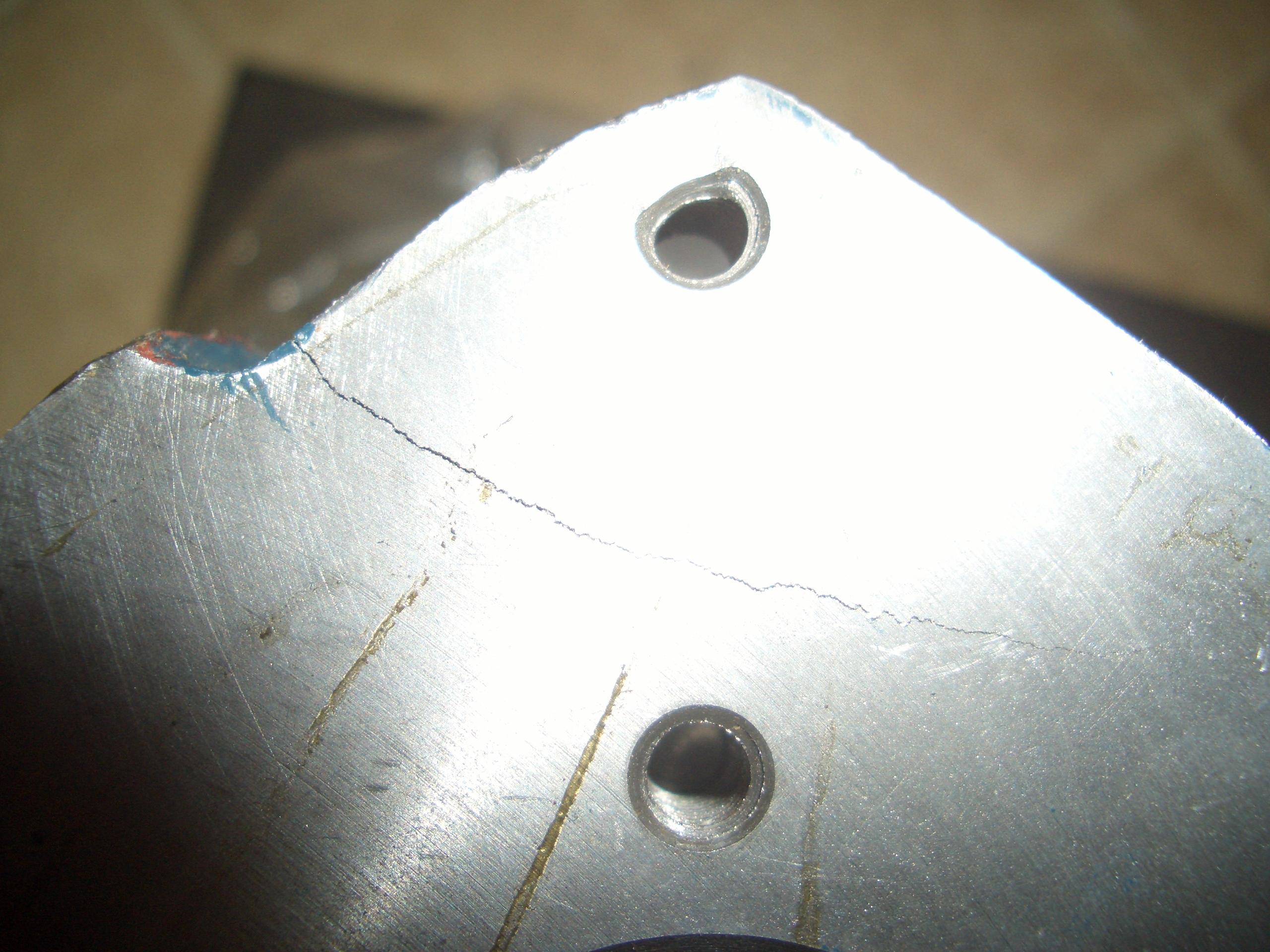

Its been a coupla months now. I can't get the correct liners to fit this block, too big around, too tall but listed for this engine.
I found a N.O.S. block with liners already installed, 1st arrive cracked, dropped at the factory! Inside a factory sealed box, no damage to the double wall box, but the casting was deformed and cracked. 2nd one arrived in good shape.
