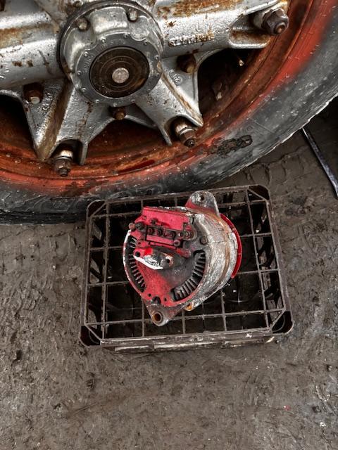

That’s one of my priorities pulling mine off and pulling out a part. It still charges well but I’ve had a truck 30 years and who knows what kind of condition it is inside. I’d like to at least pull it off pull it apart blow it out clean it up and try to squeeze a little lubricant Into the bearings. Good luck, bud…. Bob
If you are going to open it up, get a set of brushes, and a paper clip.
You have to remove the regulator and brushes to get at the bearings,  when you re-assemble before installing the regulator on top of the brushes, poke a paper clip though the small hole to hold the brushes in place while installing the regulator, then pull the clip out before tightening down the regulator.

I think at this point a better unit would be as cheap as replacing that one no core.
Yeah my supplier has said the same so going to see what he can get me

Regulator on the top is a common fault, along with the brushes. If you have the regulator off, might as well put brushes in while it is out.
Almost all I have done, only need a regulator, the rest of the parts don't often give much trouble.
I think something like a Delco 22SI will bolt right on and they are only like 200 bucks. But that LN 2500 series is a good unit. It could just be the diode trio blown out of it. You can most times replace those without even taking the alternator off
If it's been sitting a long time it could just need the field flashed
