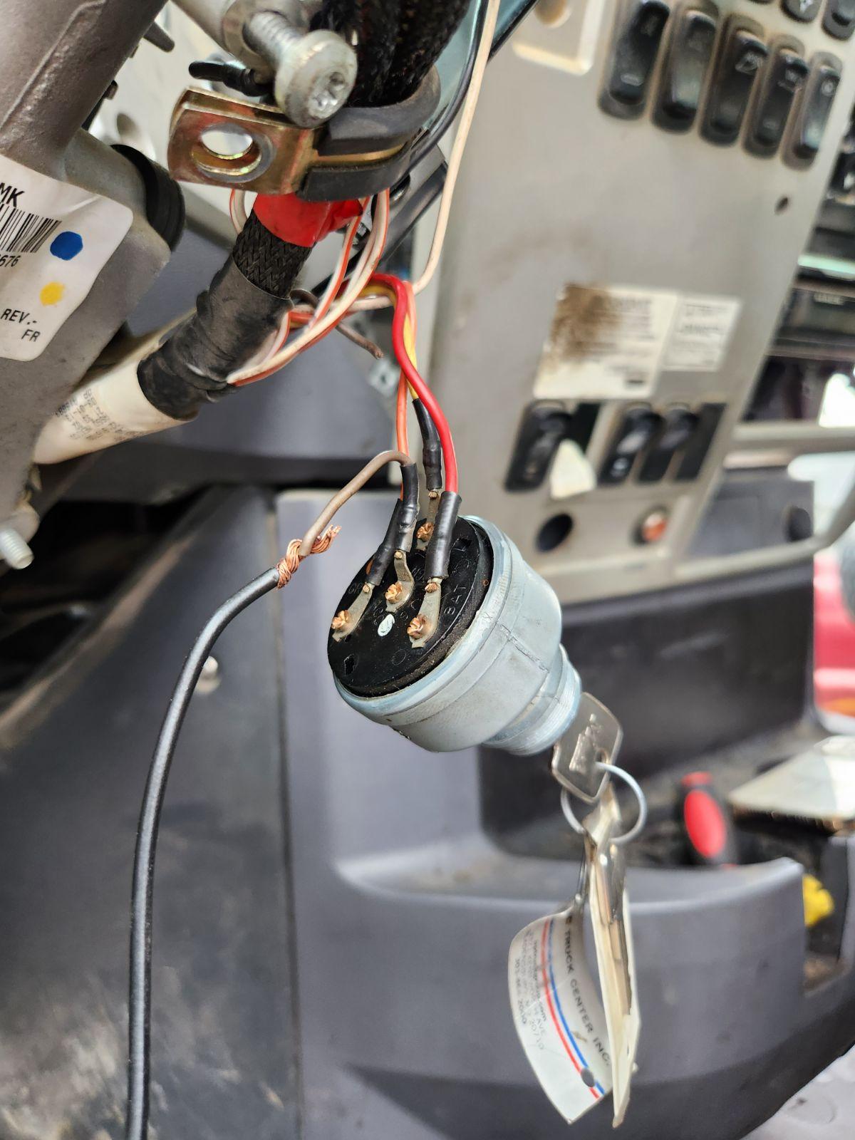

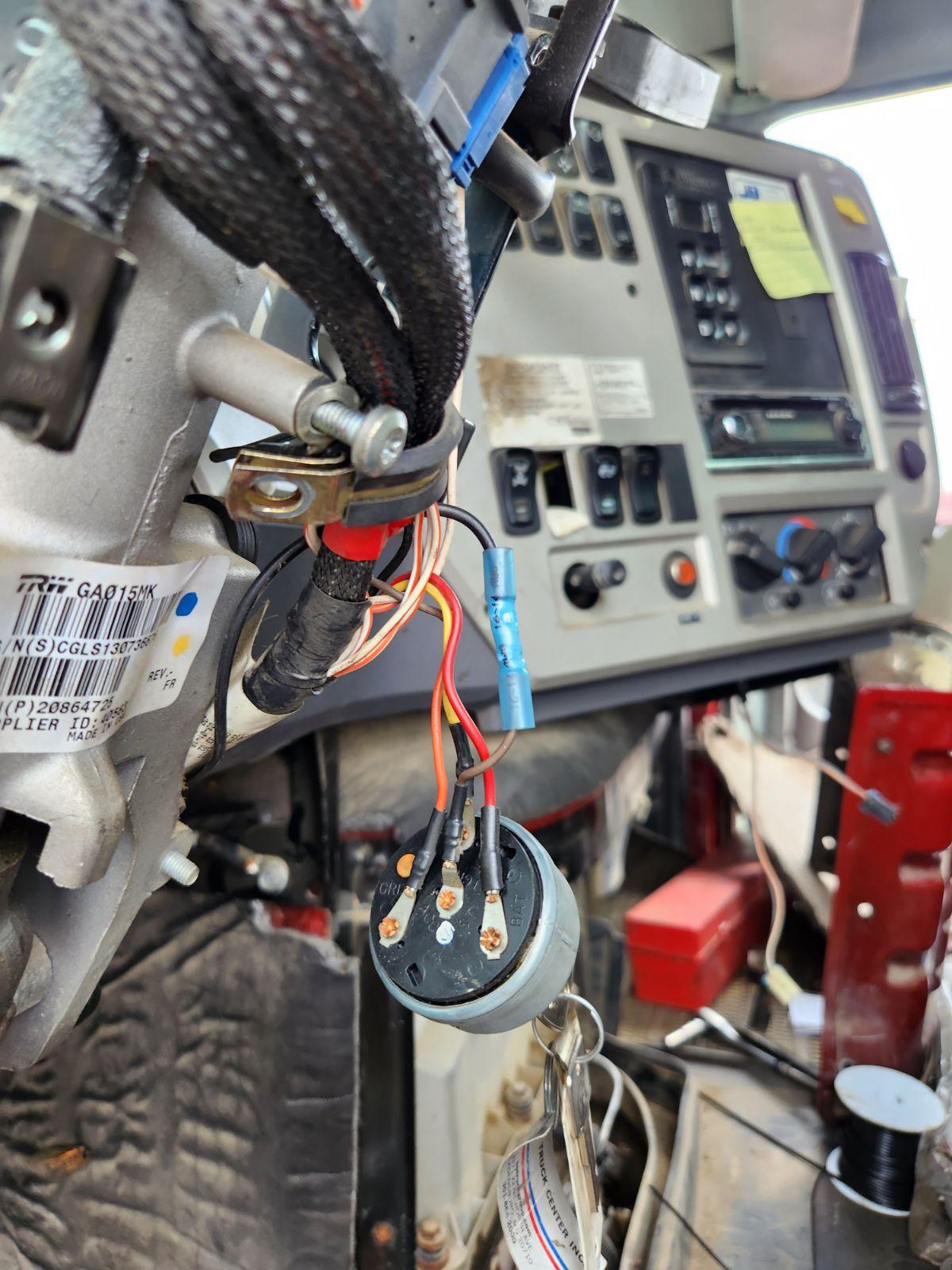

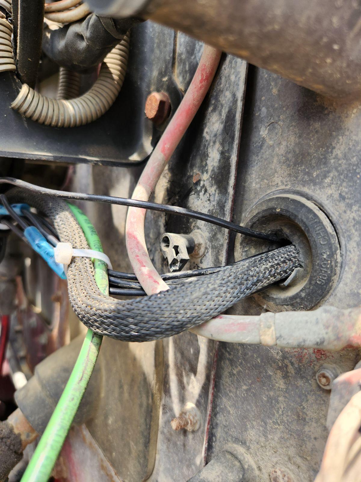

However, with the help of a friend who likes playing around with wires, I was able to start the truck with the key today. I'll post some pictures tomorrow. We bypassed the ignition switch ground straight to the starter solenoid and the truck started.
Mackpro and others may confirm this, but my buddy explained that Mack puts a relay inside the dashboard on GUs (on the firewall on older Macks). We took almost the entire dashboard and panels apart, but could not get to the relay which sits somewhere below the fuse box in the middle of the dashboard. So we ran a wire straight from the ignition switch ground wire to the starter solenoid. Hope this does not cause any problems however, please chime in.

As mentioned, I started the truck yesterday with the key buy running a straight wire from the ignition ground wire directly to the starter solenoid, after trying unsuccessfully to react the starter relay buried somewhere inside the dash.
