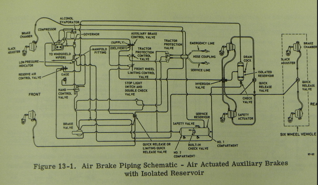

Picked up a 76 600 western that runs and drives but the owner died a few years back, however; the foot valve is out of it, with a new Bendix E3 sitting on the floor to replace it with.   Im wanting to install it on the spot so I can drive the truck home.
I've always just placed the old lines on to the new foot valve as they came off the old valve, not really know which port is supposed to do what.   Can't do that with this one as the old valve is gone.
-Does the supply air for both front and rear service brakes come from the "delivery" or "supply" ports on the foot valve?
-Also, which port is supposed to supply air to the foot valve itself?
This should steer me in right enough direction to get me going without too much crossing lines.

seems to me based on bad memory; top half of valve is supply section ; bottom would be delivery- rough configuration. when treadle is pushed center section opens allowing air to lower portion. which is why valve has exhaust port on bottom. course B's and early others didn't have 121 / computerized crap etc. that valve should have supply/ delivery stamped at each port .

Here is the brochure on an E3 foot valve.  I like the E3 better than the E2 because of the "2 stage" feel it delivers.E-3.pdfE-3.pdfE-3.pdf

1 hour ago, Full Floater said:
Thanks.  So all the delivery ports are the same, and all the supply ports are the same, correct?   Just a matter of where the line and fitting fits best?
Pretty much.  Just have to put the double check valve in the right sequence so the foot brake and trolley valve work properly.

On 6/6/2023 at 5:42 PM, Full Floater said:
I think figuring out which port is supposed to deliver air to the foot valve, would get me going as I would then be able to see which port exhausts air when the pedal is depressed for the front service brakes, as for the rear maxi's, I suppose there would also be air at that port for the foot valve to "release" to apply service brake to the rear
im kinda confused on what you mean by  " "release" to apply service brake to the rear"
the foot valve is the treadle valve that applies air to both (but separated) front circuit and rear service brakes circuit.
are you referring to air pressure to "relaese" spring/parking brake to be able to roll freely, drive and apply or use the service brakes??? thats the pop-in/out hand valve that releases the park(spring brake)... caging it.
or
do you mean release as in letting the spring relax to apply the brake???? that function is served by the inversion valve, only when you lose primary air(rear brakes circuit) the valve uses front, secondary air(front brake circuit) as a pilot signal to modulate "release" of air from the caged spring brake to apply brakes, allowing spring brake to act as service brakes.

On 6/14/2023 at 4:22 AM, doubleclutchinweasel said:
You ever get this sorted out?
I did, sorry for the lack of responses, been tied up with other clutch problems on a different truck.
I got both the front service brakes and rear air supply to a relay valve plumbed into the delivery ports, which were on the bottom if I recall correctly.  (Im not in front of it at the moment).  there is a small line from the foot valve that is connected to the parking brake knob for some reason, that I plumbed into the foot valve wrong as the parking brake valve won't apply the maxi's now when pulled out.  I think that line has to "dump" air somewhere and I have it plumbed into a supply port I think.  Not sure on whats up with that but I got the service brakes to function so I could get that truck home.  So for now, mission accomplished.
Thank you
Thank you
That small line may be the anti-compounding setup. If it is, it applies pressure to the release side of the parking brakes through the exhaust side of the parking brake valve whenever the foot brake is applied.
Ooooohhhhh!!!   Sounds like something I can do away with?!?!?    In exchange for using common sense and not compounding the brakes!
