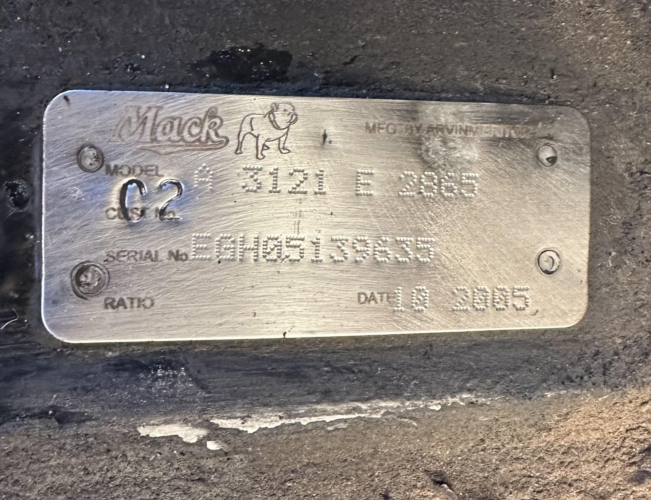

Top carrier leaking into bottom chunk
Go to solution Solved by MACKS,
13 minutes ago, MACKS said:
No check the bottom hot,after running a few miles,the bottom splashes lube up top and the excess drains back down,if the bottom is still over full hot then you have to much lube ..
That said pull the back plug let it drain till it stops flowing That is the correct level! If its still leaking after that you may have a crack in the diff housing specially if it has a torque rod to the frame from the back!
