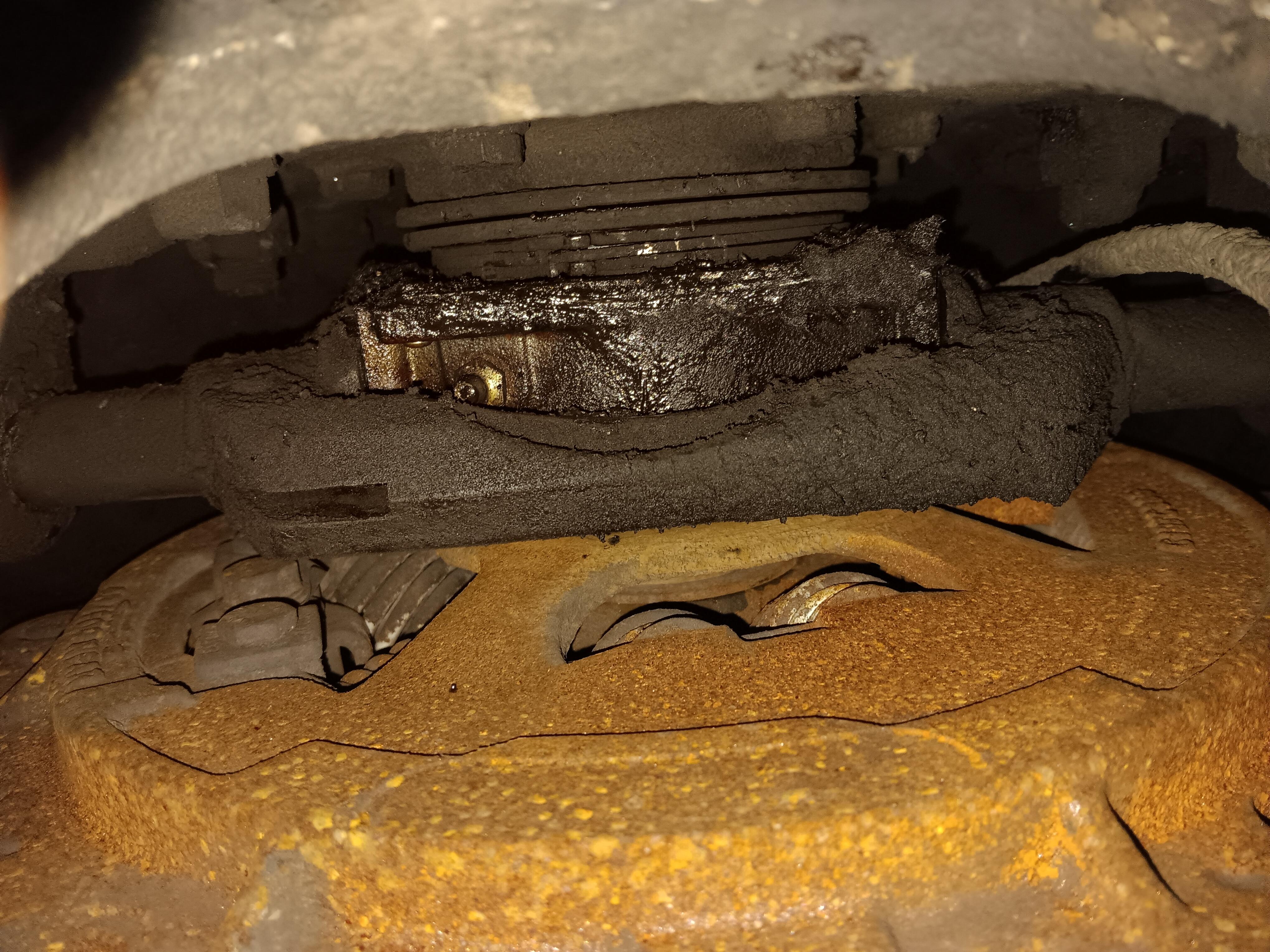

Just purchased a 90 Mack R 688 10 speed Fuller. Started to adjust the clutch looking for the 1/2 in spacing between the bearing and the clutch brake. I see 2 ring spacer , I believe this was a one piece clutch brake at one time that someone neglected to remove. Then installed a new 2- piece clutch brake. Any thoughts and opinions.
See Pic below            VERY NEW TO BIG TRUCKS

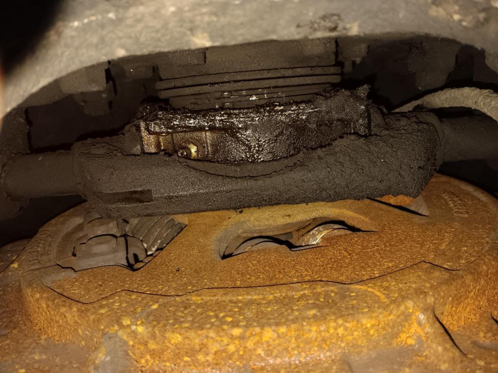

New B posted a question in Mack Truck Q & A

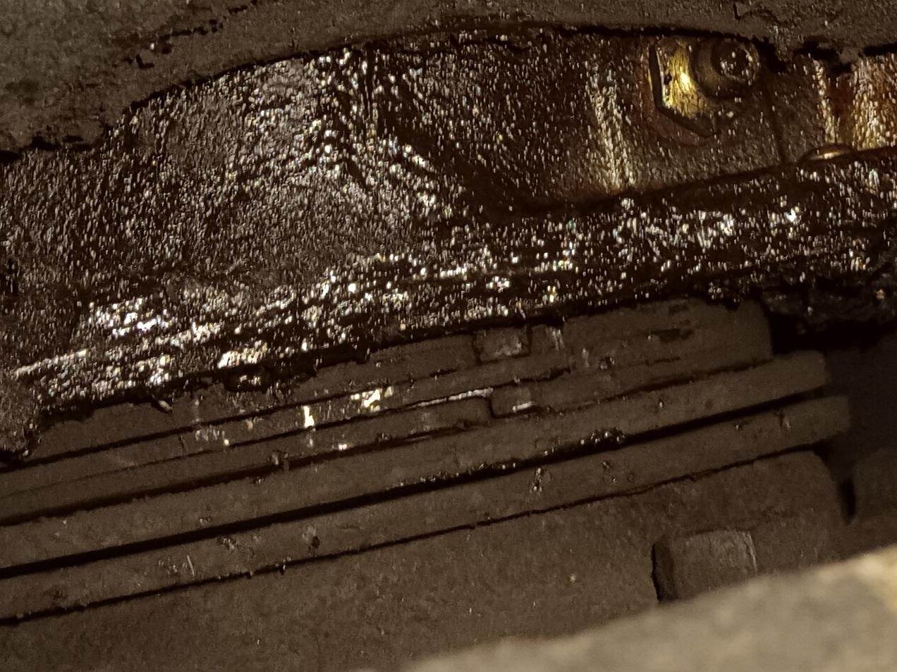

I agree with what yo see there you need to get that out of there to get the clutch set right!
12 hours ago, mechohaulic said:
and maybe learn the one with the grease gun  proper tech for greasing throw out bearing. why would some one  have two  on the shaft ???
