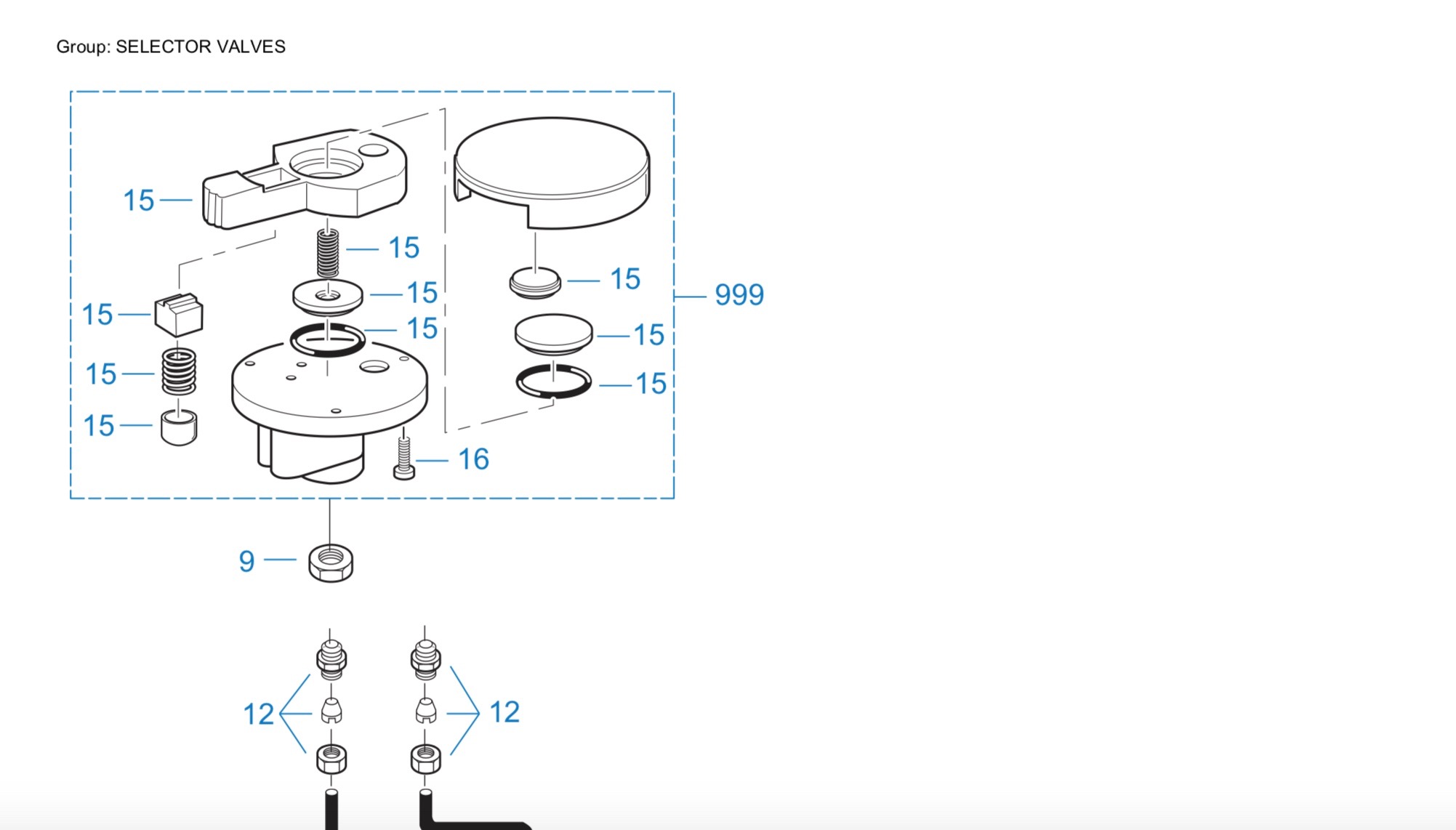

This knob is in our IH 4300.   It was leaking and wouldn’t shift into high range, so I figured it had a bad Oring in it.   So in the process of taking it apart it fell and the pieces kinda went every where.   To my defense, we didn’t have any orings, but I may need some guidance on putting it back together.  Anyone have a parts blow up?  I’m fairly certain  one Oring melted away to goo, outside of that, I think I have a handle on putting it back together correctly.   Haven’t had one of these apart in about 22 years.
This may help a little.
250690358_ScreenShot2021-04-04at8_52_41PM.thumb.jpeg.0abb63378de1a60e559d1dbbf299f7c7.jpeg
I had to fix an air leak in mine to . I just matched the o-ring up. I was fortunate that there was still one there , it had just got worn from old age.
I think you are supposed to use a special grease when you put it back together. I just used chain lube . Not sure if that was right. It doesn't leak any more and works well.
