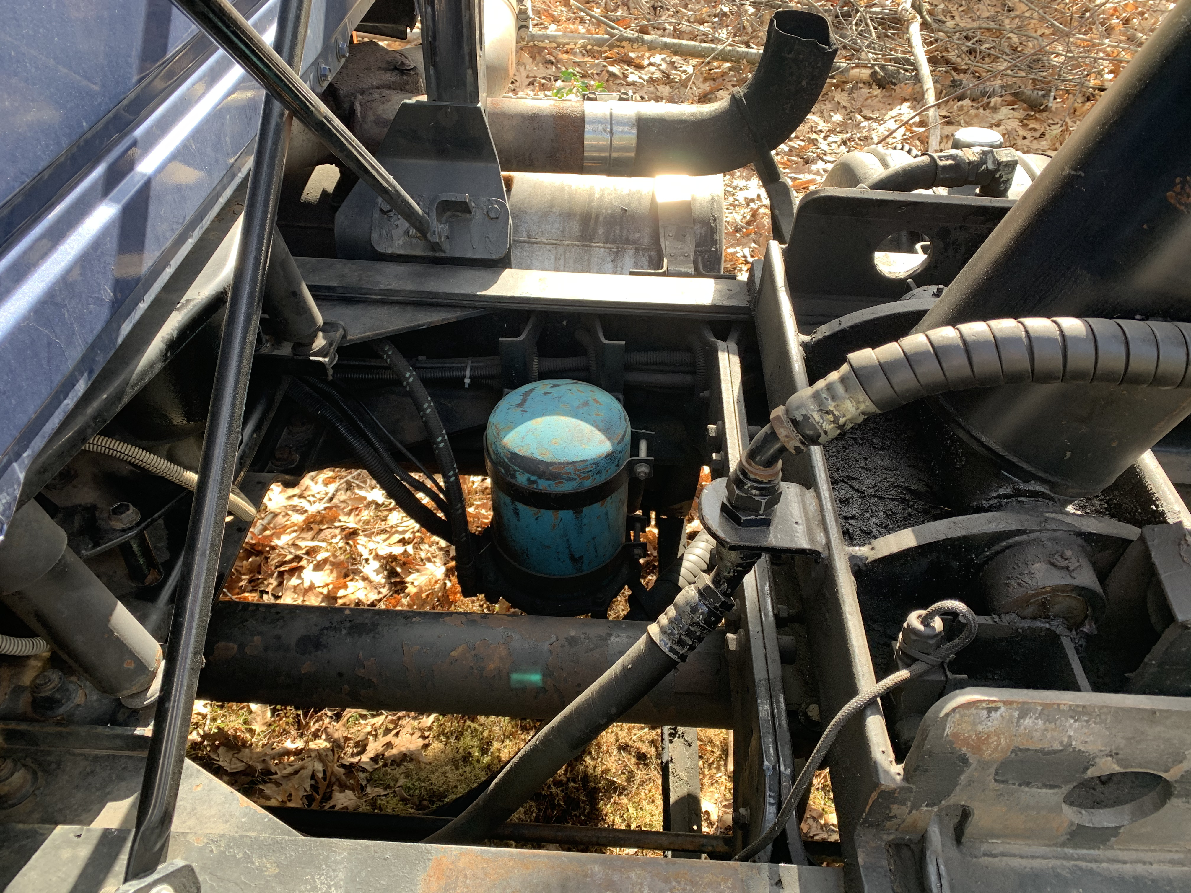

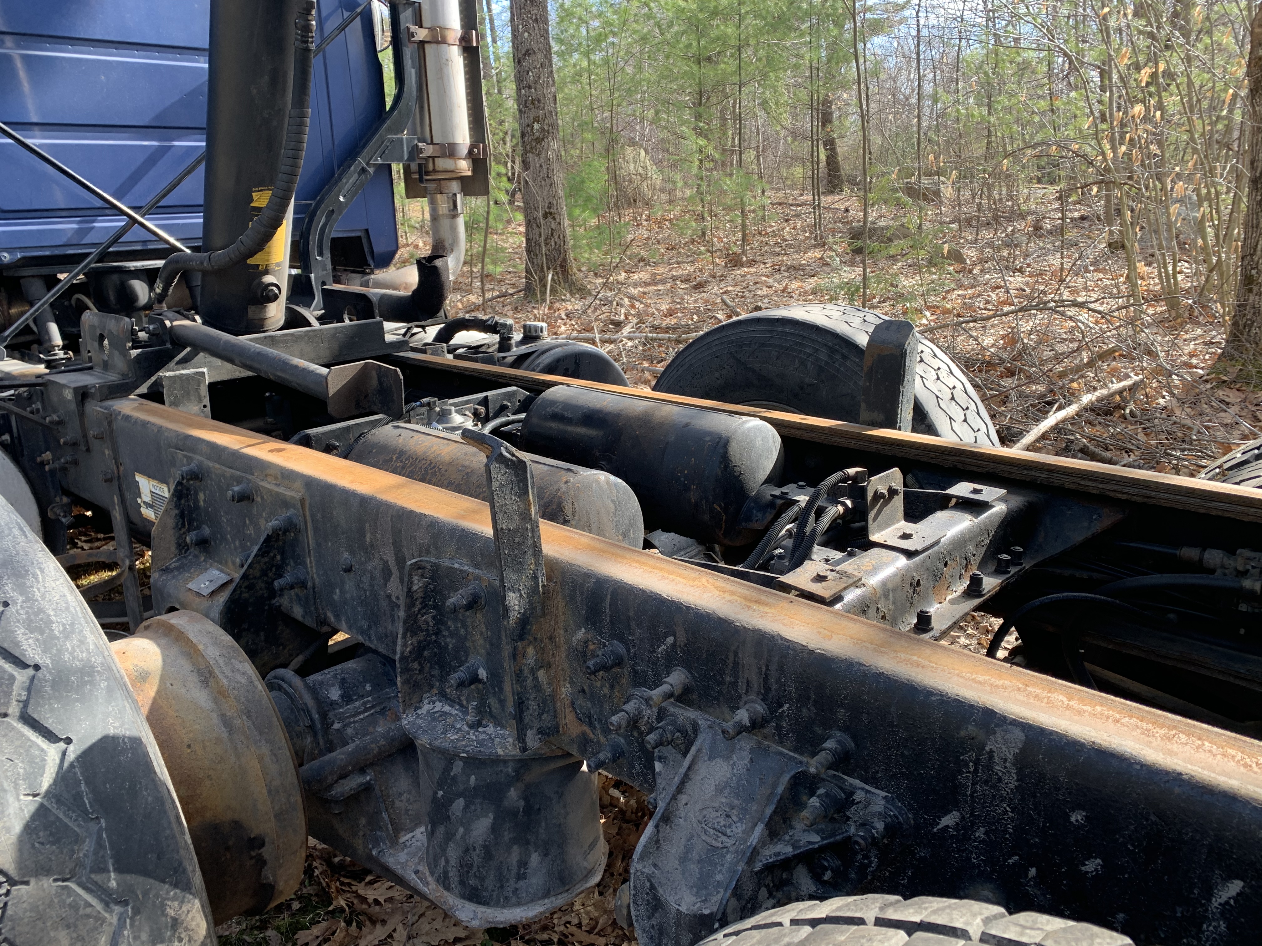

2BEC736C-12C1-4D7E-A438-09613C7B9711.thumb.jpeg.bcfe0bc5c7306e14fb10a6e0b0c7097f.jpegI’m not sure why I can only upload 1 or 2 pictures at a time. But here’s a photo of under the frame. I appreciate all the help guys, I’m trying to track this down on my own but if I can’t I’ll end up having to find a shop to bring it to.

It looks like someone added air tanks  parallel to the frame.  Those most likely supply all lift axle related air
So those 2 tanks would be working along with one of the other systems, correct? I’m trying my best to understand how it all works.

Yes   the truck was made with the tanks that look to be aluminum. Then someone added the two.  Are you sure one of those two doesn't have a tiny hole rotted through ?
Not sure, very well could be. I just was cautious looking around with the bed up. I’ll get something to prop it and then check the tanks. Chances are they probably have pinholes rotted in them!
