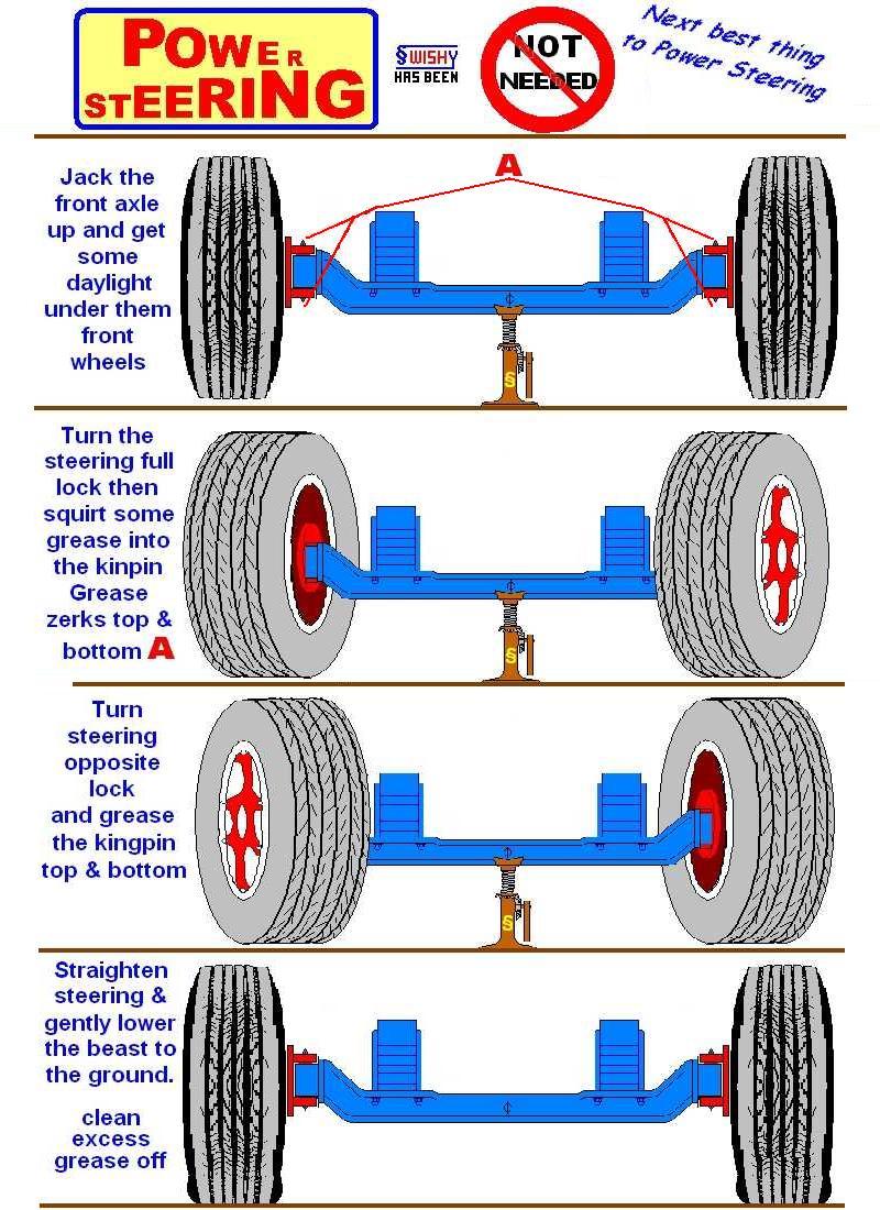

The above drawing is to get grease on the load side of the kingpin
normally when U grease the front end with the wheels on the ground
the grease finds its way out the easiest way .... on the unloaded side of K/Pin and grease does not get to the load side of K/P (az much)
Years ago we had KW that did not have power steering and  do as above the drivers sed it felt like power steering (for a few days)
cya
Swishy, That's the way l did my first MB and R with my son. l had the grease gun and he turned the wheel. Even thou he was only big enough to barely see out the door window.    .....Hippy
