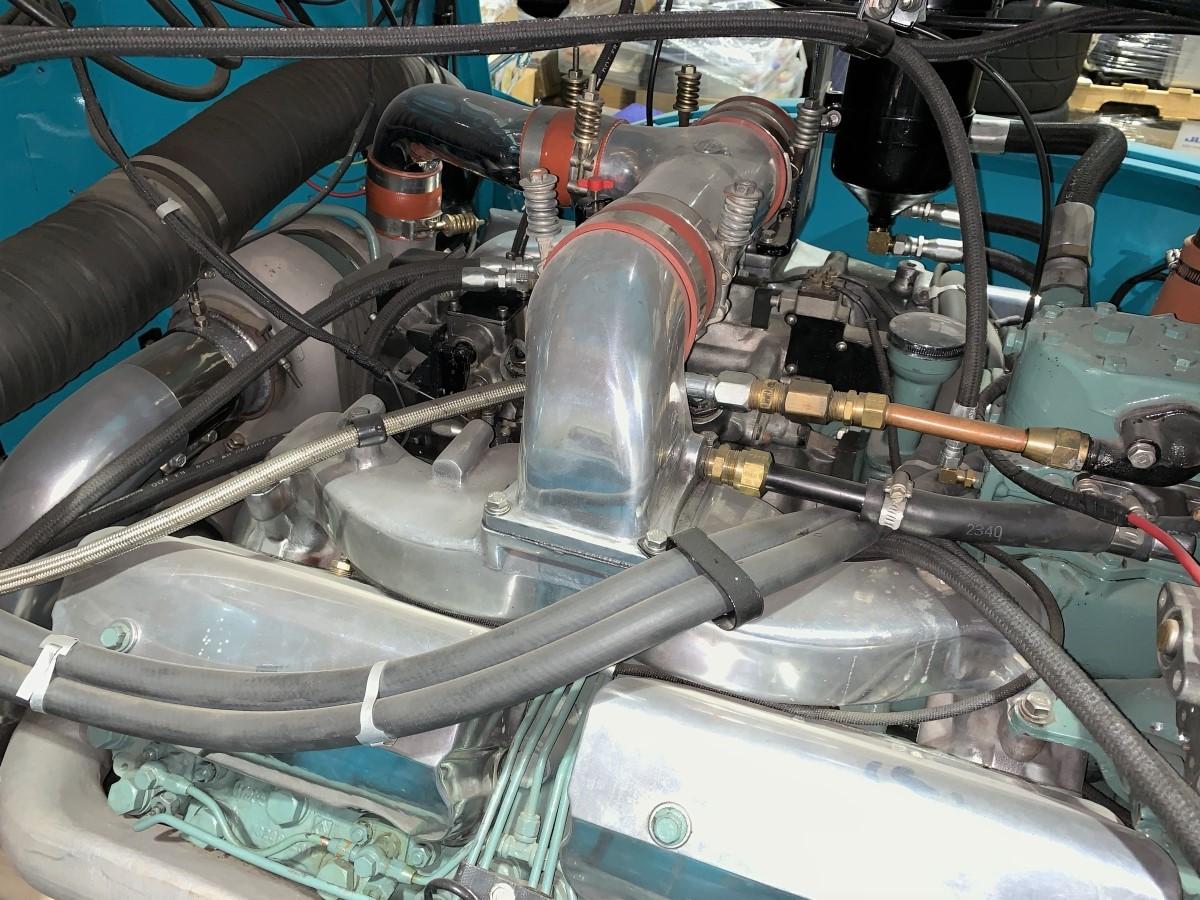

You have your parts polished or "Jet Hot" coated? They certainly look good. My 74 866B is gold, (although not a Maxidyne engine) and rust along with some corrosion...... the 73 866B, (water wagon) and 77, (Project R-12) are both gray. The 77 is an 865B series but rebuilt. It has the short nosed later 8VBB pump and sure runs like a scalded dog.
I like your foldover aluminum tag stock for the hose gathers rather than the customary plastic "zip ties" seen everywhere these days. I also see you stayed with the SAE 100R5 style hoses for the fuel and coolant lines which are the braided ones. Lots of attention to detail is evident in that build. Mine are all original from the 1970's and falling apart although not leaking, (yet). Wire sleeving just crumbles when you touch it. I'm so cheap however I'll probably retain the copper air compressor discharge piping to the wet tank rather than go the teflon and stainless as your build did.
Got to get these engine warned up and run for 50 miles or so to get all that crud burnt out of the manifolds plus does the whole truck some good to be run.
It is difficult to find a pump shop that can run the old V pumps or the guys that know who to set them. stock or otherwise.
I am a polish guy, no Jet hot coating except the exhaust manifolds. The turbo tube is chromed. Had to go though several of every part to polished. Corrosion is a huge issue when trying to polish parts.
Those foldover aluminum hose gathers are real Mack OEM the way they came from the factory. I did not do DOT new copper for the cost and for safety. I wanted to drive this truck so it is stainless supply hose and plastic DOT air lines covered with the original canvas/tar material. No one ever noticed the plastic in how well it was done.
I do have that same SAE cloth covered hoses for oil & power streering lines also. It is pricey but what it take to be historically accurate.
If you really look the injector lines are not on top of each other and now beside each other. I make a new complete set when the engine was rebuilt, they were just not available. The engine was silver and I painted it the old Thermodyne color to match the 864 Thermodyne. An 866, 375hp is actually the biggest Thermodyne Mack engine.
Your efforts certainly stand out to folks whom know what they are looking at. I did notice your injector lines layout but thought they were a running I'd not seen in the past. Mine are all stacked as you mention and original routings. I actually had a couple twist off from rust on the 74 truck, but have another set from a donor engine to replace them. Given they are krusty, I may make up new ones if I can find a shop with the correct ends.
The canvas and tar sleeving is on all wiring and air lines in the 74 truck and just falling apart. It was used where split loom plastic is these days. The product is still available but getting up there and I will most likely replace it also. Only have to do it once so not the cost issue with me as I want it to look nice and retain a pretty close to original look. I don't remember any plastic lines under that hood or engine and do think the original copper is still in place. I'll probably reuse it if I can, but the truck won't be worked.
The 74 truck never had power steering and at some point had "Air-O-Matic" installed which was worn out when I purchased it. I purchased, (via Trent) a power steering gear and pitman arm along with a drag link, then a VTM42 series hydraulic pump and reservoir from another party to install hydraulic power steering, but haven't got that far yet. I have purchased the R5 hydraulic hose and have hose ends for the steering also. After welding up a stand for the engine, it sets in the back of the shop with others awaiting further work. Going to change the cab in the spring and started cleaning up the chassis last fall after pulling the engine in 2018:
To my surprise a lot of the aluminum parts on the water truck were originally chromed. The "X" bracing running from the cowl to the radiator was chrome as were a couple of brackets and the turbocharger pipe was polished. Not in the best condition now, but it probably showed well in it's day. I'll probably follow suit when I get to it but that truck runs and is occasionally used so being kept back and not messed with, (yet). I've actually got to drag that one into the shop as one of the oil cooler sealing rings to the block let go and it's spraying engine oil which is a new problem. No gaskets in there but just a silicone ring.
