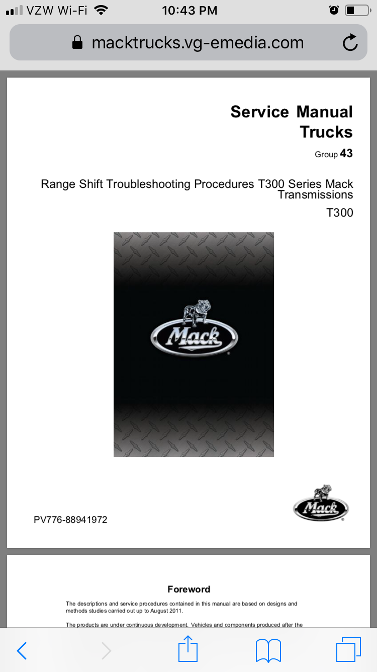

Best thing to do first.....Go to Mack E-Media. They have a great step by step diagnostics packet to diagnose-for-repair or condemn the 300 series range for shift issues. Free download. Ignore the $20 list price and click on the manual shortcut. You could buy a copy, or they offer a download if you have a printer.  Note the PV776-blahblah number in the left lower corner, that’s the publication ID w/description.
