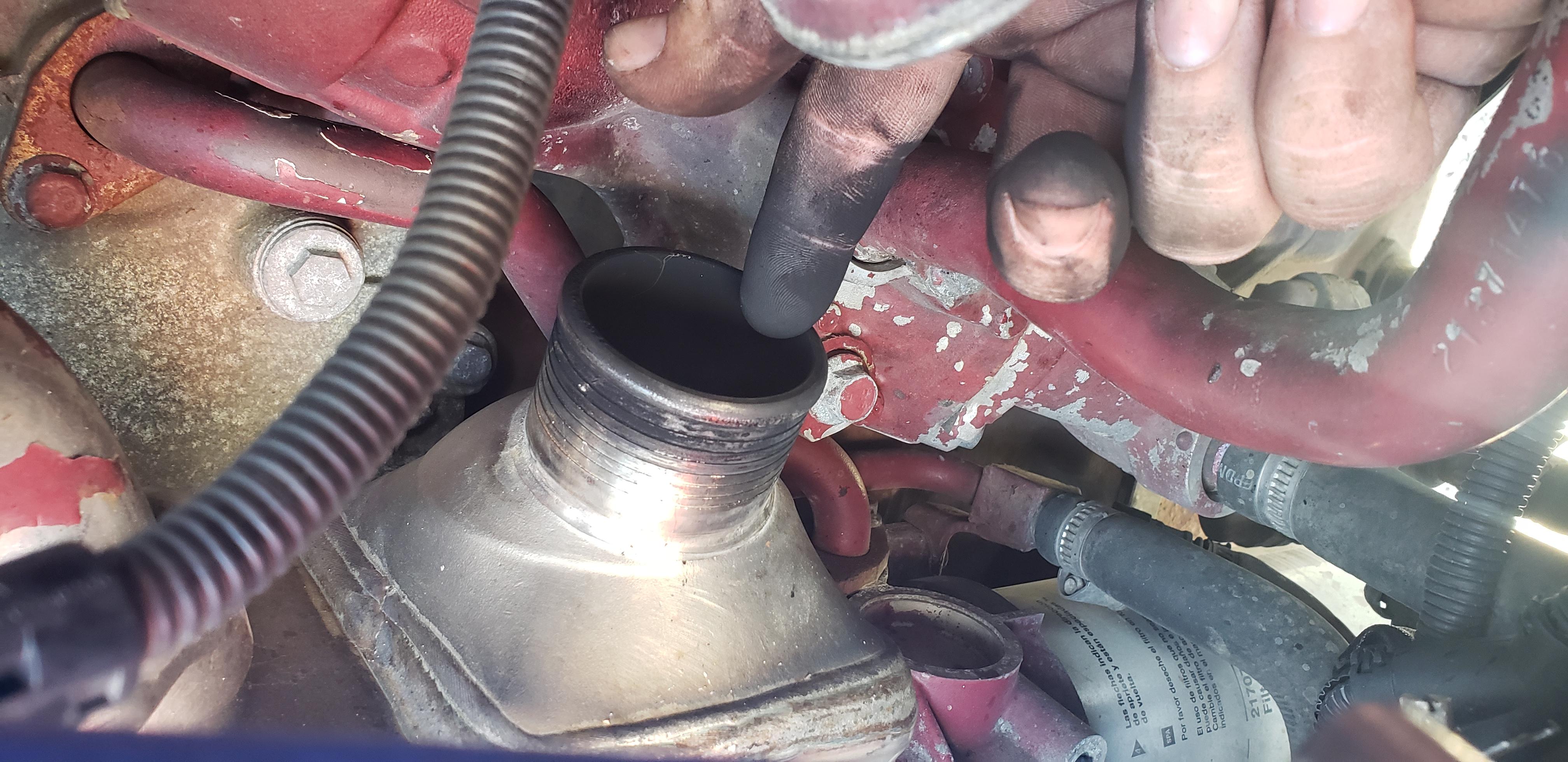

Could possibly be a cracked injector cup at the body to tip area, seen that many times. Could also be a leaking egr cooler, worst case could be cracked head. I don't think a bad water pump would cause pushing coolant unless the engine overheated and cracked the head or damaged the egr cooler.
If the upper radiator hose is hot to touch and the lower radiator hose is cold the you may have a water pump issue(vanes spinning on w/p shaft). Even if the water pump is determined to be bad its not the reason for pushing coolant.
Well I took the egr apart at the outlet side, its dry soot inside like it should be. I'm going to buy a cheap harbor freight temp lazer to check the radiator like you suggested, all signs kinda point to something injector related I think. The truck has an appointment with the dealer for tomorrow so tomorrow evening I'll probably have some idea what's going on and how much it will hurt to fix it. Any want to buy a 2011? I'll sell you one half price. ;)
