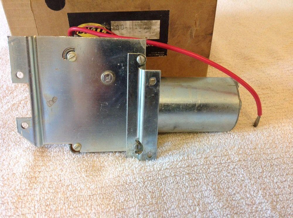

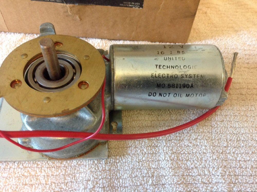

Is this the unit you're looking for?
They go NOS for 145.00 to 175.00
