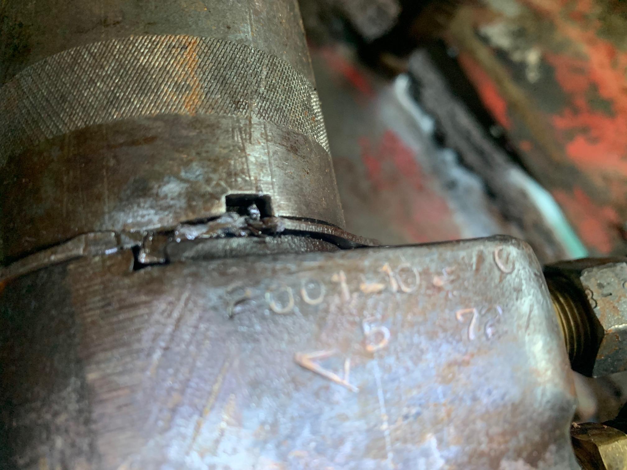

After I cleaned off the dirt, I found a Garrison 2001-10-x0 as the power assist steering valve.  The Garrison rep says no metal parts are available for the valve.  The pump is an Eaton "U" model pump with cylindrical steel vanes.  The pressure relief poppet was installed backwards in the pump and that is why the power assist steering wasn't working.  There is leak in the steering valve that I need to evaluate but the power assist is functioning.  I will check with Steering Re-builders and Truck Parts in Cleveland, TX to see what they offer.  Anyone familiar with Garrison know what the two numbers below the model number designate.  My valve has 5  72.  Do you think that is a manufacture date of May 1972?
The slave on my B is 6-61 date of manufacture of my B mixer is 9-61.
