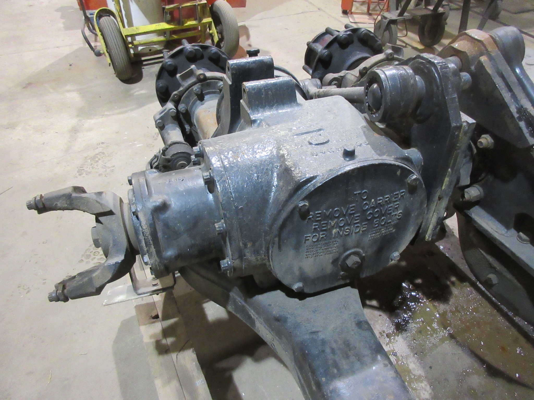

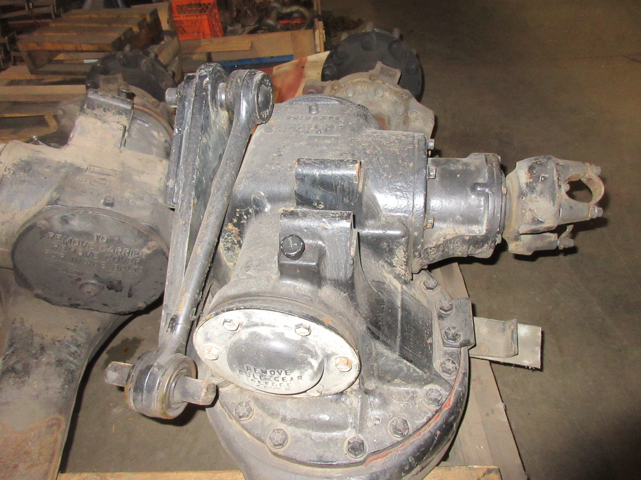

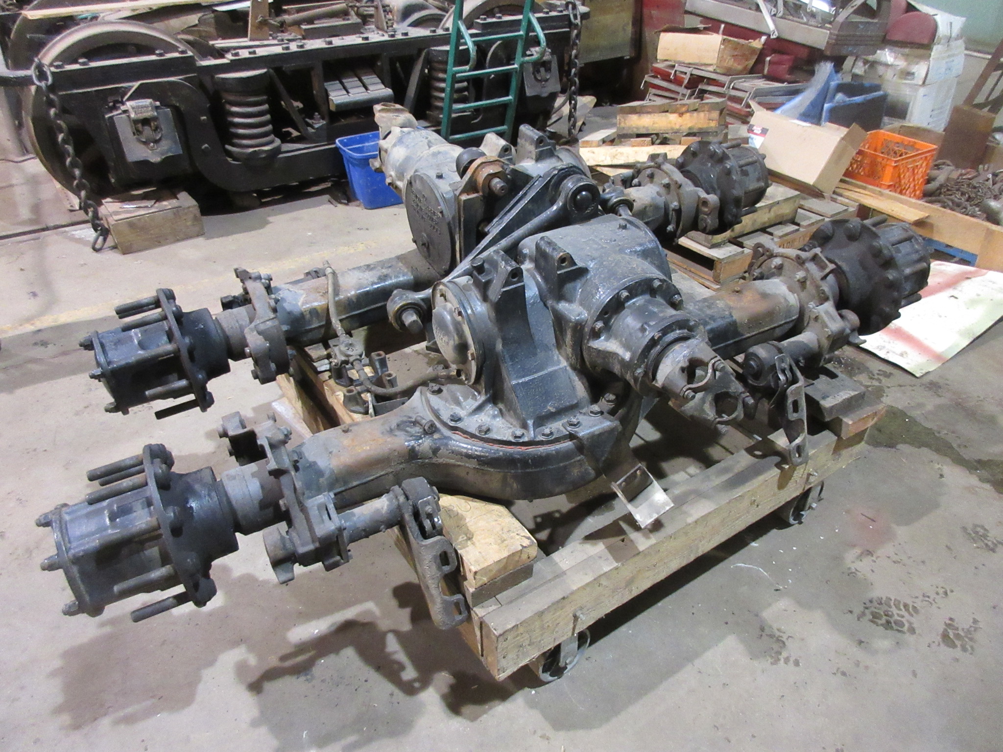

is this the bracket you are talking about? can get better pics if you need..
I have a pair of crd92/93 4:35 but I'm on the left coast.. shipping's a bitch.
BC Mack
That's the one.  On mine only the rear crd93 has the transverse rod.
