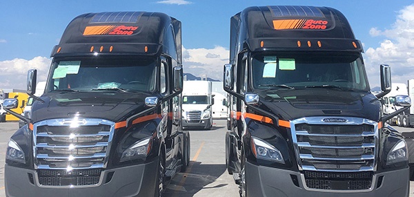

Freightliner Cascadia raised-roof sleeper trucks can now be ordered with the eNow eCharge solar system as a pre-delivery installation.
The eNow system can be ordered through Freightliner dealerships and installed at Freightliner's Custom Truck Service centers located at each of the manufacturing plants.
The eNow solar system's 0.125-inch thick design is flexible to follow the aerodynamic roof contour of the Cascadia. The eNow system supplies ongoing power to the batteries, to meet the cab’s power needs while reducing idle time and fuel costs.
“The eNow system has continually proven its value in reducing costs, while also demonstrating its durability over diverse road conditions and in a variety of climates,” says Jeff Flath, president and CEO of eNow. “Drivers and fleet owners who order the eNow system pre-installed will begin realizing the benefits from solar the minute they take delivery.”
For more information on the eNow eCharge system, click here.
