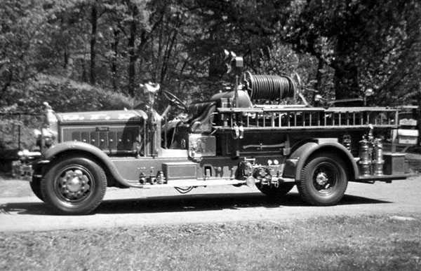

Thought Mack also built their own transmissions and rear axles, also have the IM logo cast in... Must disassemble the pump it don`t run till the 60s I think. The bronze volume/pressure regulating sleeve stucks in the pump (must make a special puller tool) and many dirt, rust in...But the pump rotor turns over free if I hand crank the engine. The front priming pump (to prime the pump with water if water sucked from lake) also stucks, I think they only  use hydrants.

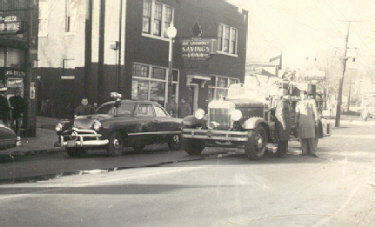

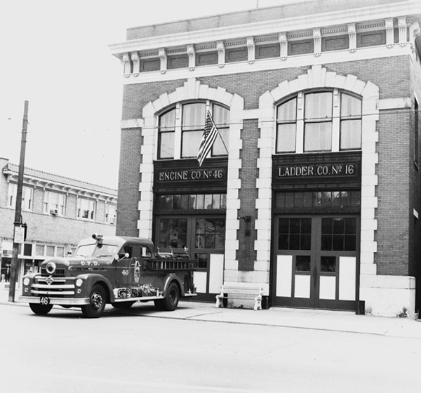

I found two pics of exact my truck from the 30s.  Hyde Park Cincinatti Stadion 46 Engine 46! Looking for one historic pic from the rig before the
station maybe someone have? Only found the newer Seagrave rig which they have in service as ENG46 after my truck from 1955 to 1976
